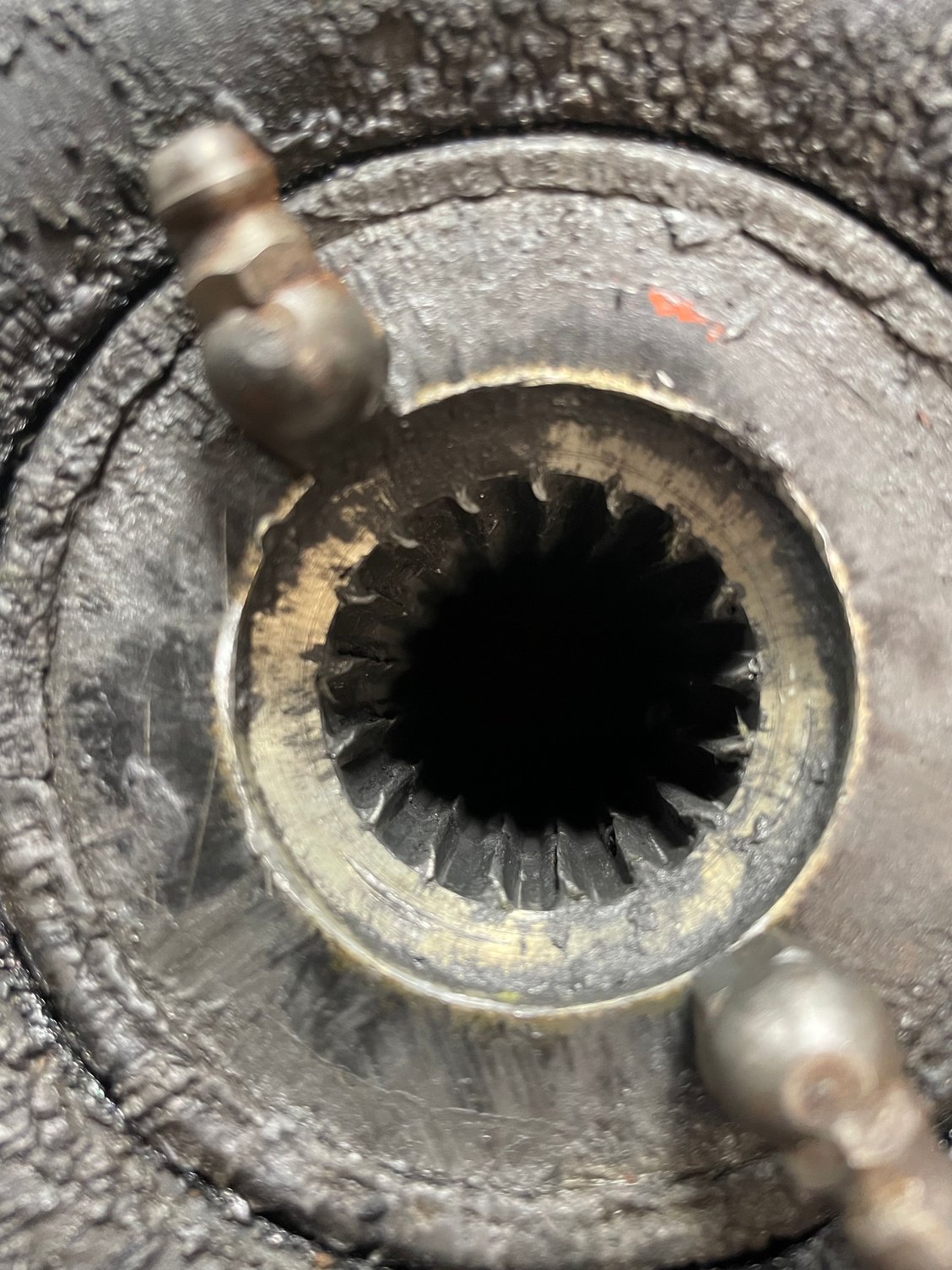

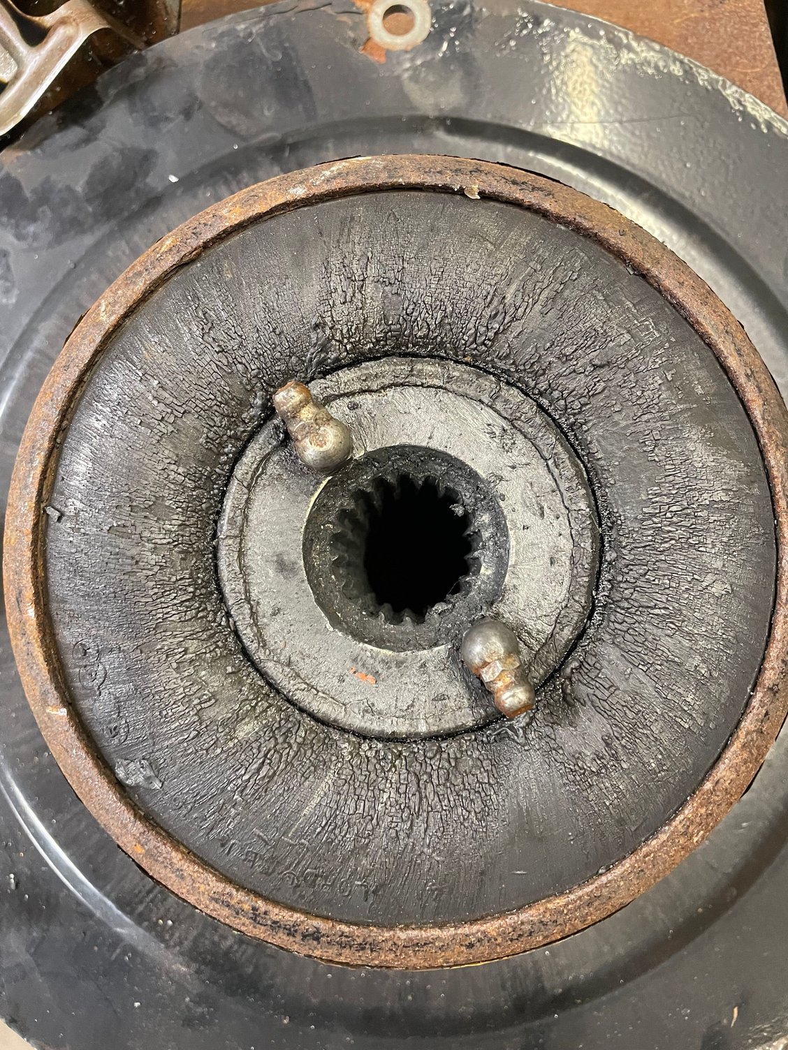

I would check the coupler regardless, this is what I found on my 252 with a 502. Not sure how it lasted?
