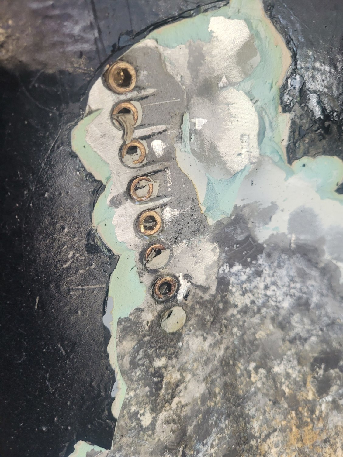

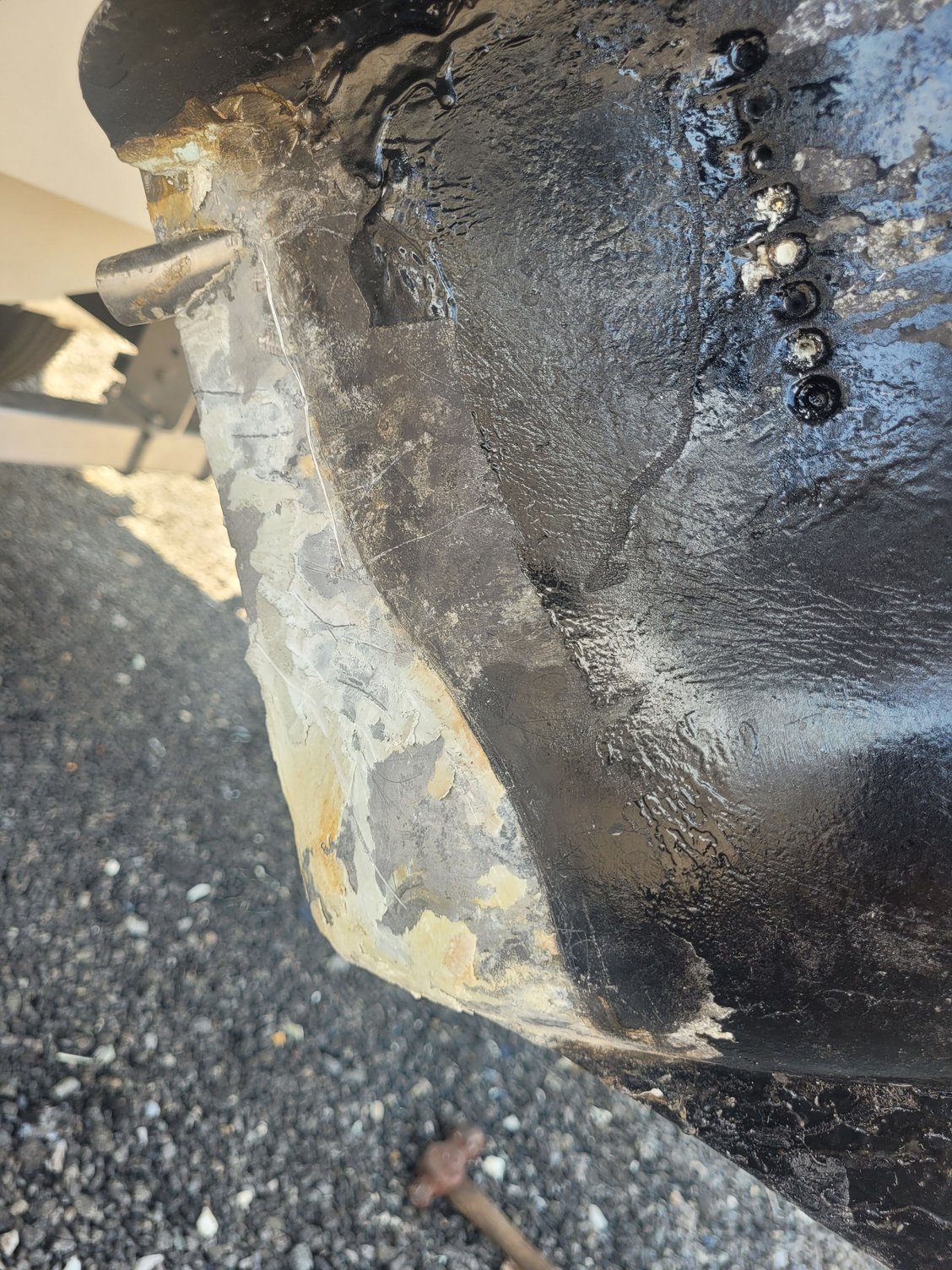

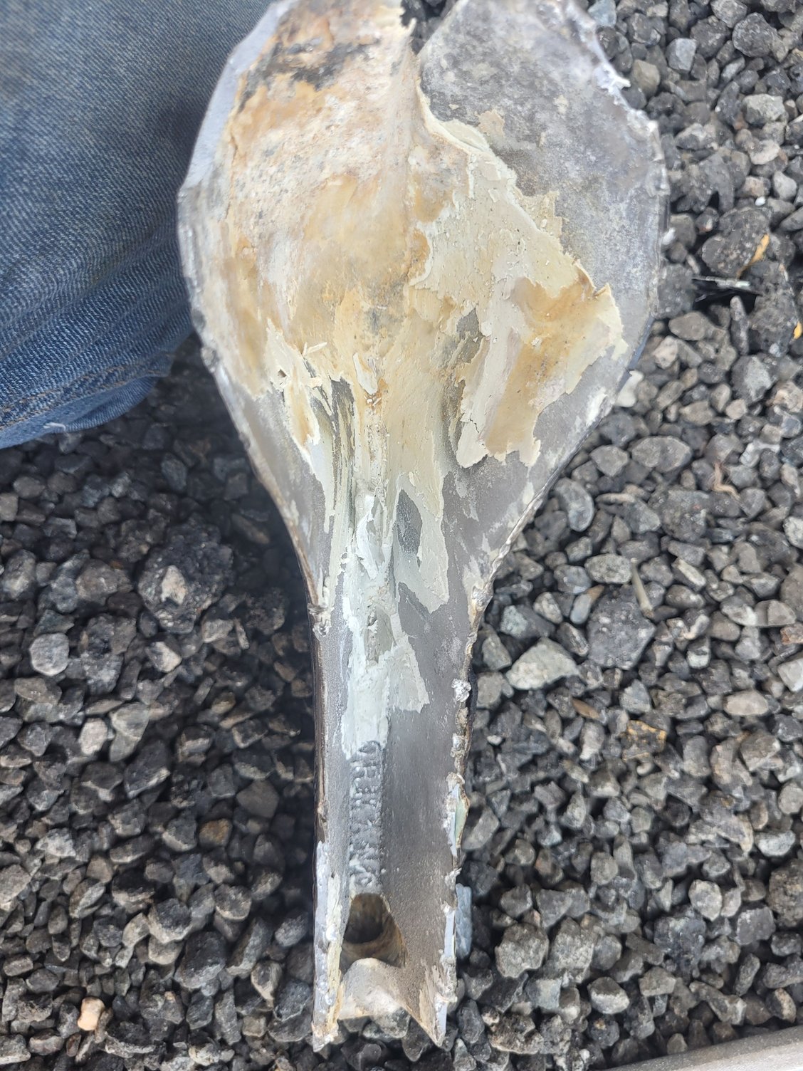

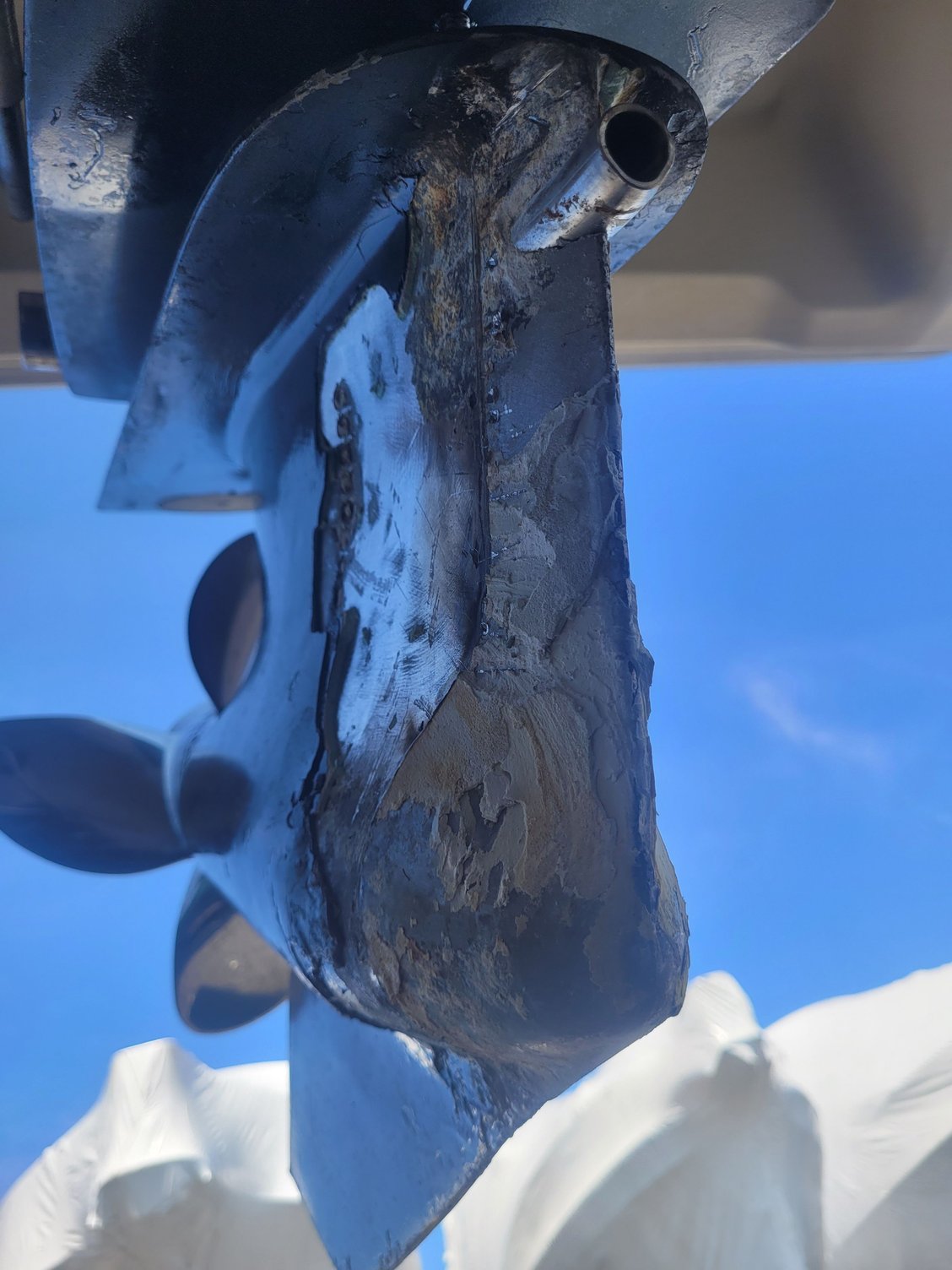

Got one cone off. Looks like it was never a lwp there. Looks like they created it. Now what?
the side water inlets has screw in brass plugs.but some are stripped.
https://cimg9.ibsrv.net/gimg/www.off...2627006880.jpg
https://cimg8.ibsrv.net/gimg/www.off...4285632c39.jpg
https://cimg2.ibsrv.net/gimg/www.off...6c9cea48b1.jpg
https://cimg9.ibsrv.net/gimg/www.off...cd3a6f619a.jpg
35fountain 08-22-2023 01:05 PM
https://cimg2.ibsrv.net/gimg/www.off...7efa119979.jpg
https://cimg5.ibsrv.net/gimg/www.off...ea0df3da34.jpg
Knot 4 Me 08-22-2023 01:51 PM
Wow. Honestly, at this point I'm looking for new lower cases or complete lowers.
Heck, worth the price just to get new cases - https://www.sterndrivereplacement.co.../lower-unit-4/
35fountain 08-22-2023 02:31 PM
I was told to cut the tube flush with the drive. Plug it up with marine tex. Then remove all water inlet side plugs from drive sand paint and your good to go. A lot cheaper than new drive lowers. I think those were SEI?? if not mistaken, A OEM Mercruiser drive lower will not cost only $1199.00 I have heard good and bad about SEI. Why are the so inexpensive?
Tartilla 08-22-2023 03:24 PM
With some heat on the allen plugs, you may get a few out by the threads. Otherwise drill them out.
...no wonder you never got anywhere with little drill bit by hand.
Great progress so far.
