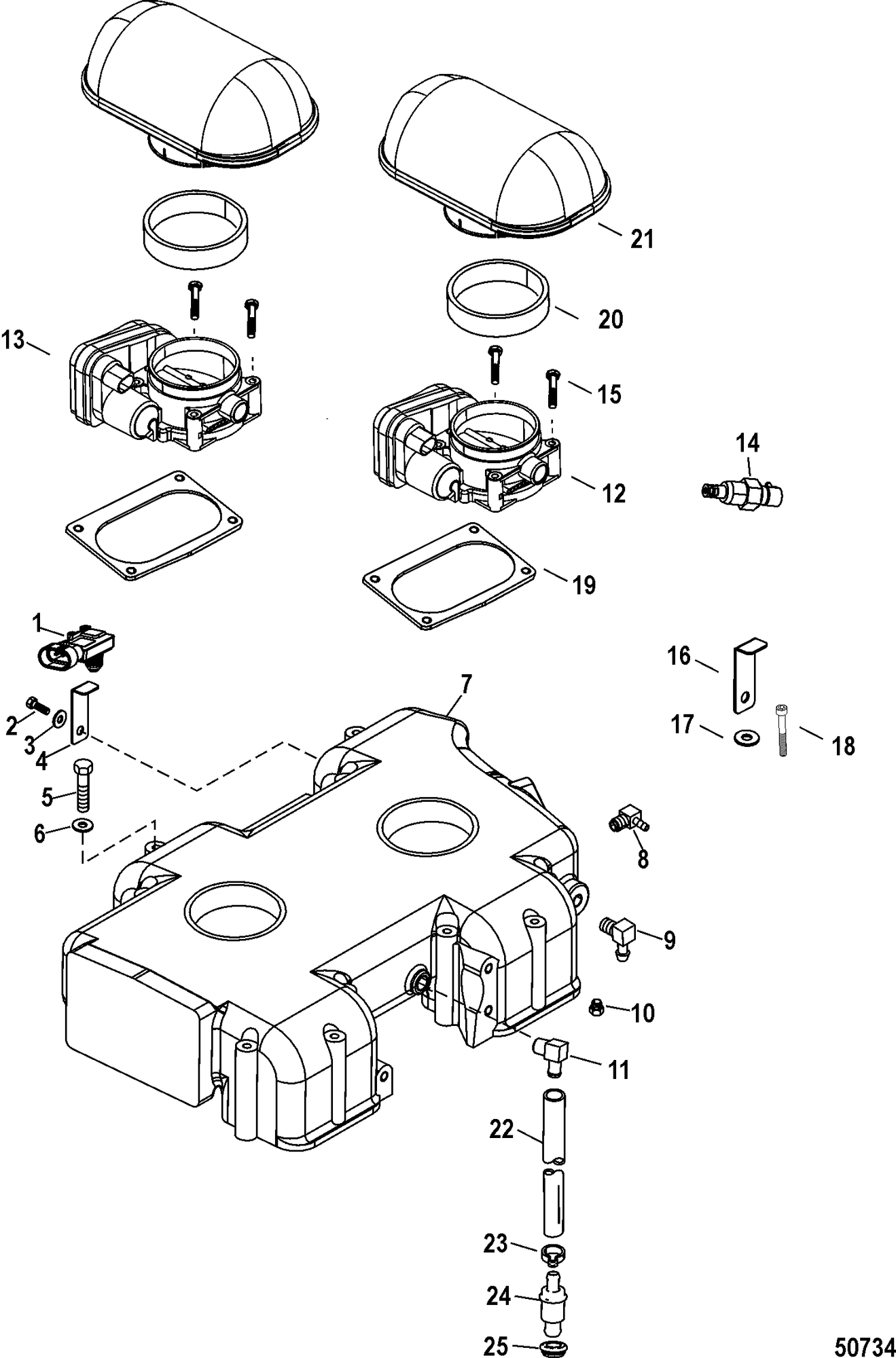

https://cimg0.ibsrv.net/gimg/www.off...87064df01.jpeg
Was browsing and saw this 2023 merc 565, i like this plenum did a bit more searching and found the parts diagram. Do you see like me ? It’s like a 525 plenum with 2 TB on the surface instead on the side. Which I think it makes more sense if you are not planning for force induction.
https://cimg1.ibsrv.net/gimg/www.off...9048da82ab.png
Someone knows the size of these TB merc 565 is using ?
Nosfool 08-17-2023 05:54 AM
I have noticed that as wee on the 565. Looks like two of the mercury 520 throttle bodies on the top. I believe Eddie young did some plenum modifications to 500efi intakes at one time adding a second throttle body and moving them to the top of the plenum as well.
