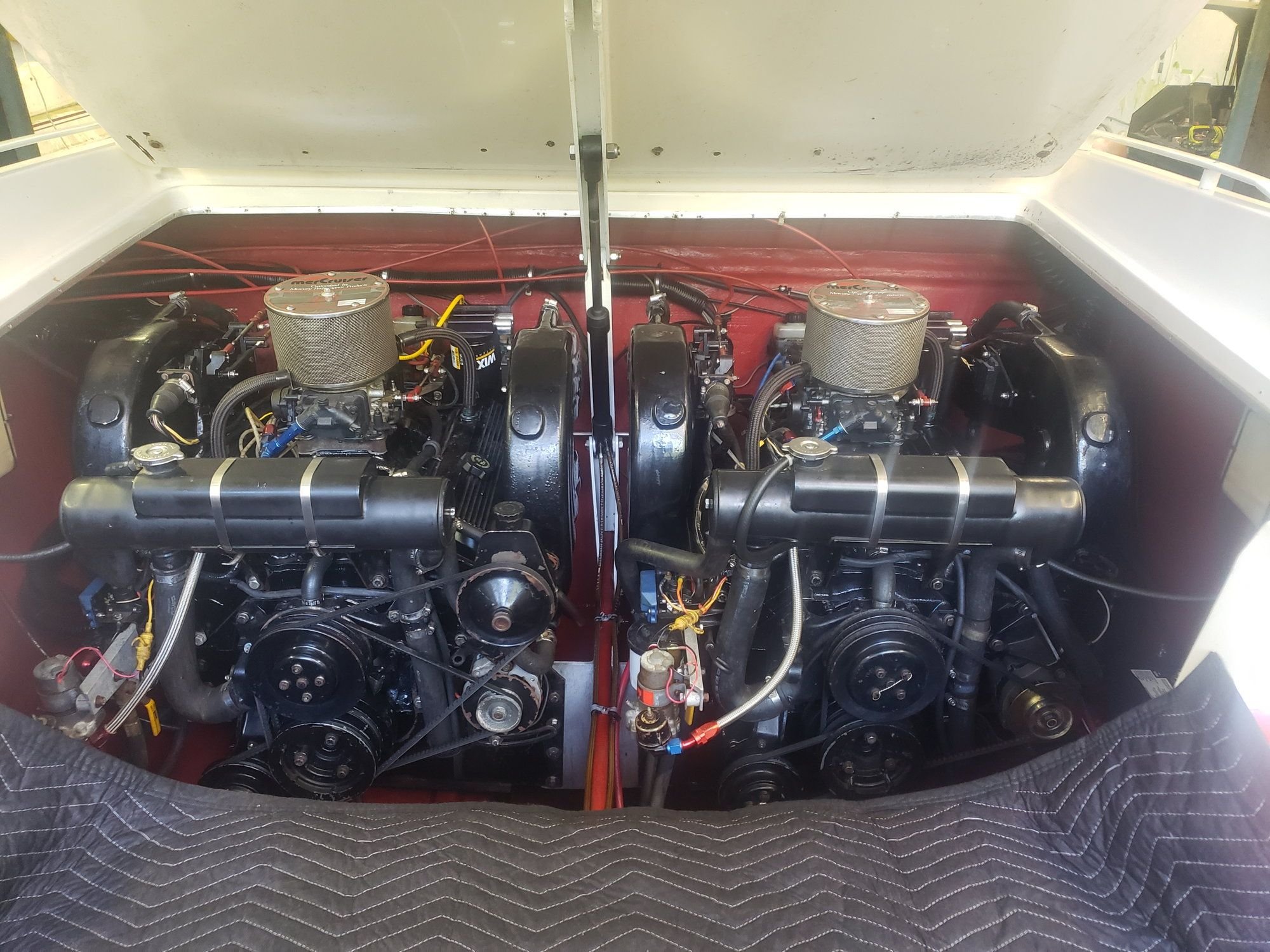

Do not hesitate. In my 17 years of go-fast boating THIS kit and my Daytona CD1 box stand out as the best money ever spent on a boat. I’ve posted that several times on here.
The aesthetic issue was a concern of mine but I got over that instantly. Life is so much better with closed cooling.
servicing is not an issue. Not sure if you have std deck or tall deck motors but it fits both - I have tall decks. Temp NEVER leaves 150*.
mine is a Vbelt arrangement so there was a bit of work dealing with the PS pump, but worth it.

as you can see I painted mine ahead of install. I actually like having them mounted on the motors because if you need to yank a motor they just come off with it as one entity.

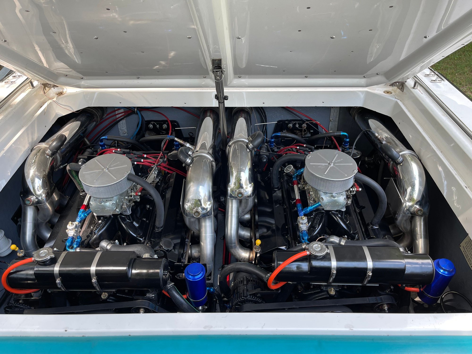

I used a Hardin/Orca kit on my VP and it works like a champ. Mine mounts off the back of the heads... which created a whole 'nuther list of fitment issues, but nothing that couldn't be worked around.
The Orca mounts supported the tank too low... so I had to make taller brackets to raise the tank... and also had to relocate the hatch lift assy.
The instructions were also terrible... so it helps to have a basic idea how the cooling system works and how its divided with the kit.
Factory VP systems used a vertical tank mounted on the starboard front of the engine. I actually like it mounted at the back... so that's a bonus. No interference with front mounted accessories.
