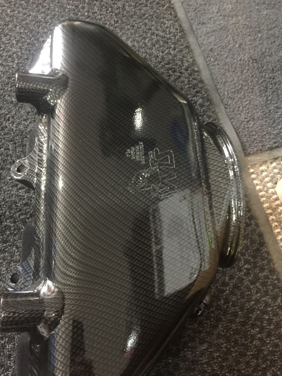

I had em make me a set out of carbon fiber .
With these there`s no different length runners, I would think headers would scavange and flow better . I do like no headeraches and just the ease of install is super nice but my headers were leaking so I had to make a change ..
