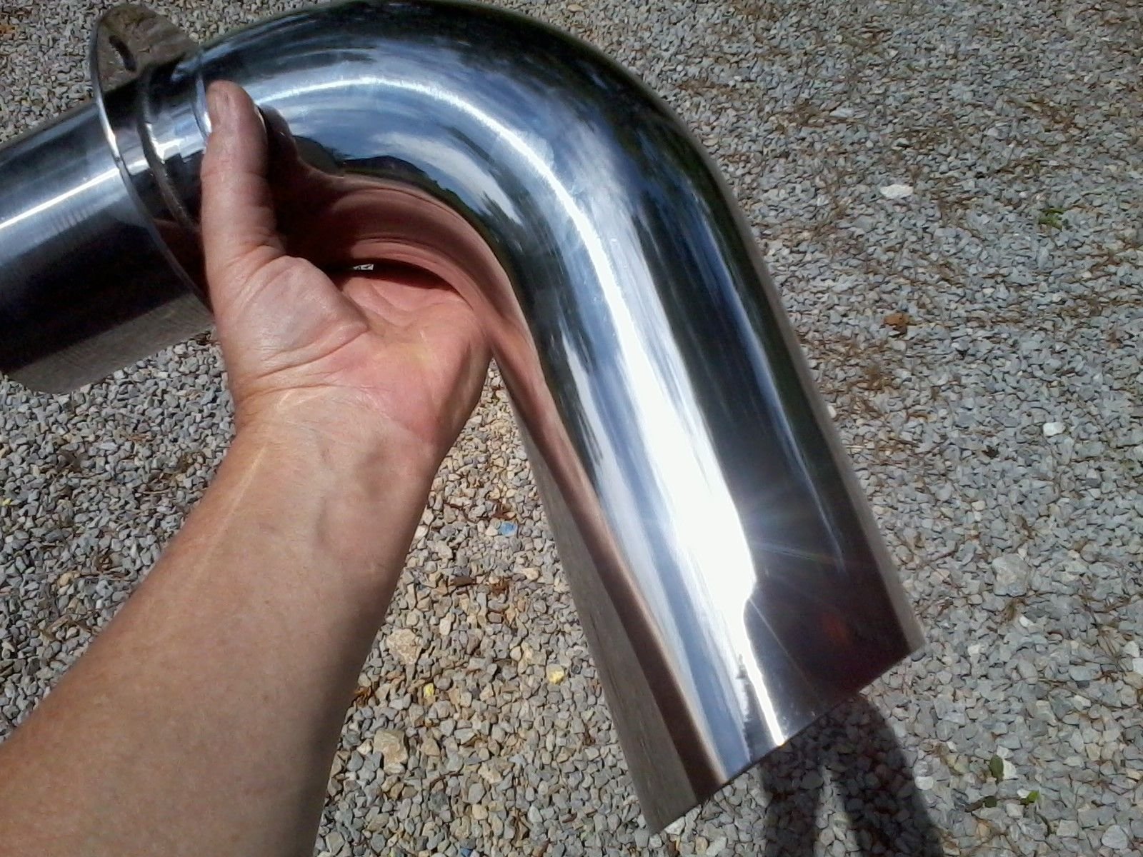

Don't think your going to find what your looking for without something hanging off the back. I installed turn downs, was quite at idle and full sound running
Which ones did you buy?

Spent the last hour looking for what I bought and came up with nothing.
Pretty sure I posted pics in my threads when doing repower but have not been able to find them. Did find my repower thread but no pics of the turn downs. Not even able to find same type looking for new on line
The ones I bought were about 9 inch long after the turn so it put the tips about 4 inches under the water at idle. They were not clamp on they where flange mounted same as tips with sealant and 3 screws each.

Found the pics but still don't remember where I bought them
I have accidentally run across those before but can't find them anywhere now. All are clamp on which with my angle cut tips I don't think will work. They were also kind of expensive and I'm having an emotional battle spending that kind of money on something I really don't want. I like the sound of the open exhaust at all rpm levels but do not enjoy the reversion I am getting. Thanks for the help.
