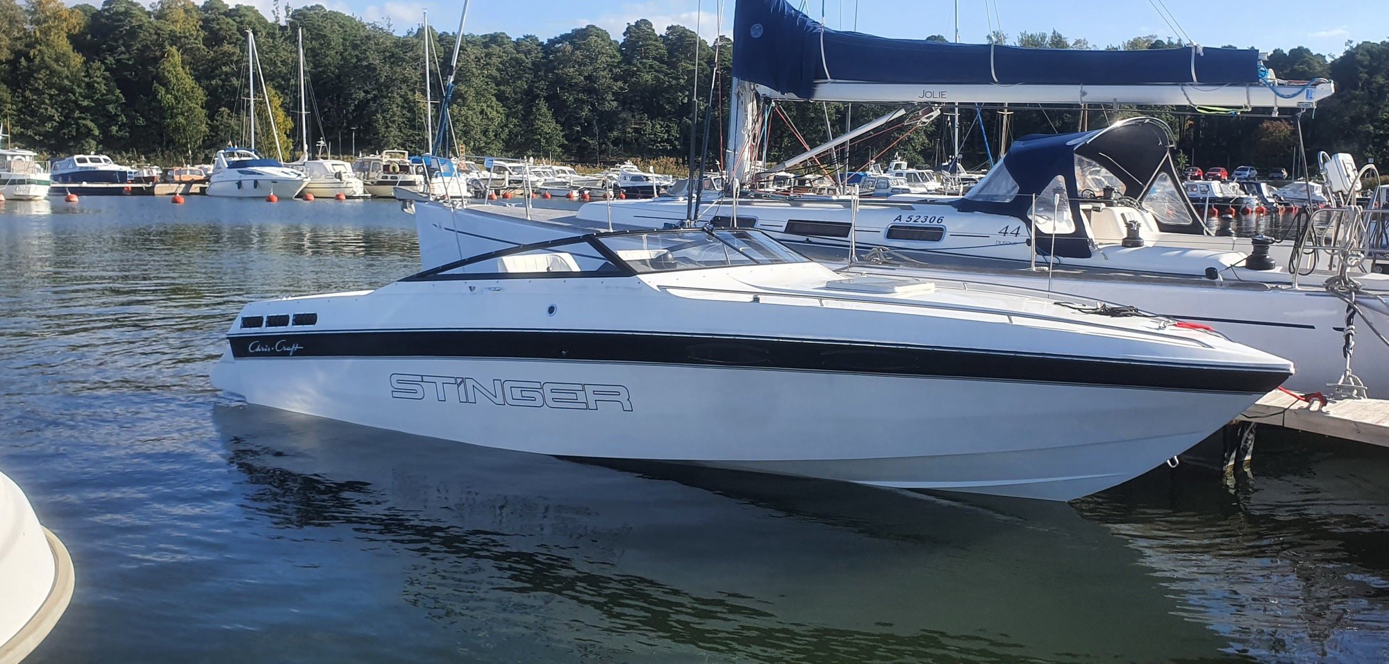

What kind of boat?
Old 26ft cc stinger. Intake manifold is a big question for me right now? I have ms2 efi collecting dust at ny carag, that i could use. Option 1=ms2 efi with single plane intake. Option 2= ms2 efi with modified 502 mpi intake. Option 3= edelbrock rpm dp 7164 with 850cfm rochester q-jet.

4" taller vs stock and dry to transom riser.
Okay, so how do you know it needs less duration split ?

Im kinda surprised your current cam with said duration is peaking 5300/5400. With that said and you plan to stay around the same I’m not so sure I’d change your cam. Heads will be a big improvement… they’ll make your power.
(Comparison) The 236/244 dur cam in 509 was pretty much done at 5500. I definitely would be careful with to much duration on single engine heavy V bottom. (Looks nice btw)
In regards to the split I’d (think) 4 to 6 deg would be about right with those heads. GM heads with chitty exh ports maybe 12 - Just sayin! My worked over promaxx’s like 4 deg split. The ratio btwn int and exh is pretty efficient.
