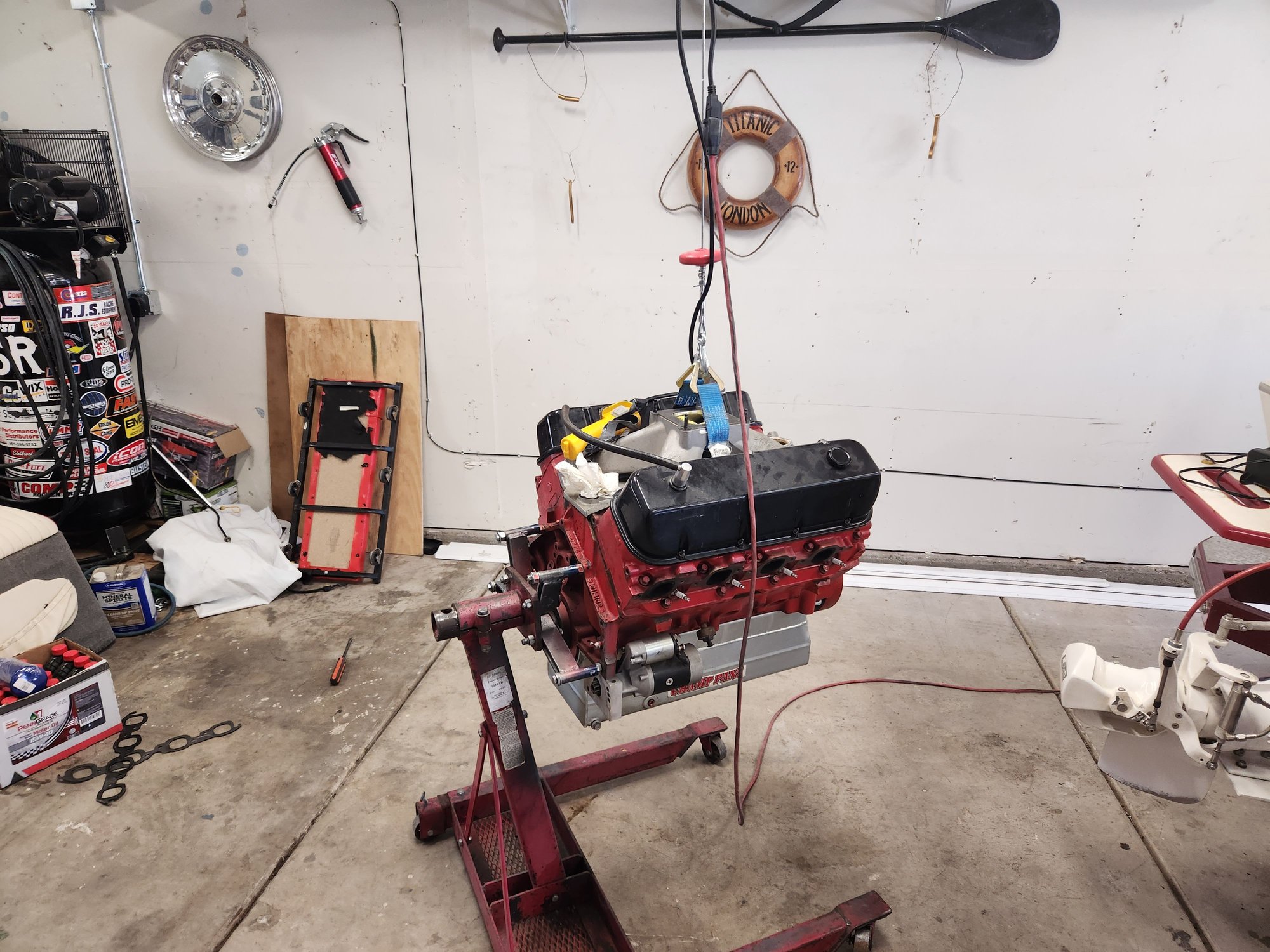

Just pulled the engine to go for rebuild. The pan looks to be in pretty good shape but I still might put a new one on so I don't have any issues and have to pull it for a while. It has the starboard side tube for the original dip stick hole plugged and there is the banjo fitting on the bottom with dipstick in each side under the manifolds. I don't use the starboard side. Any recommendations on oil pans? There seems to be a big price range. I'm assuming the mercruiser oem pans are just paying for the name . Any help is appreciated
