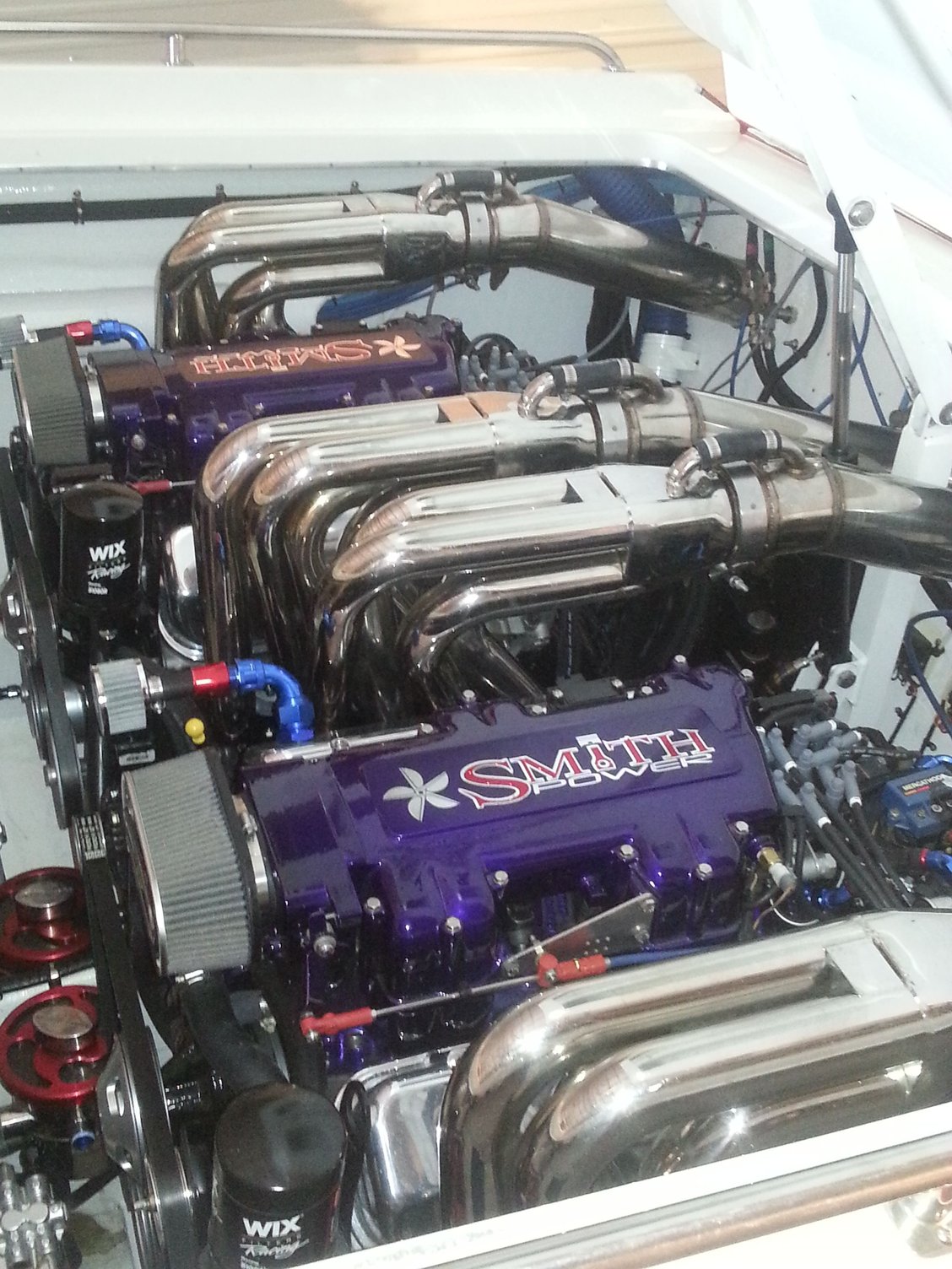

I have a friend that has, with some other changes. Heads, cam, and I think the throttle body.
Here are the results, full dress on dyno.

I had a pair of 565's with the 500EFI intakes that were extrude honed by ASM. Couldn't have been happier with them. Made about 700/700

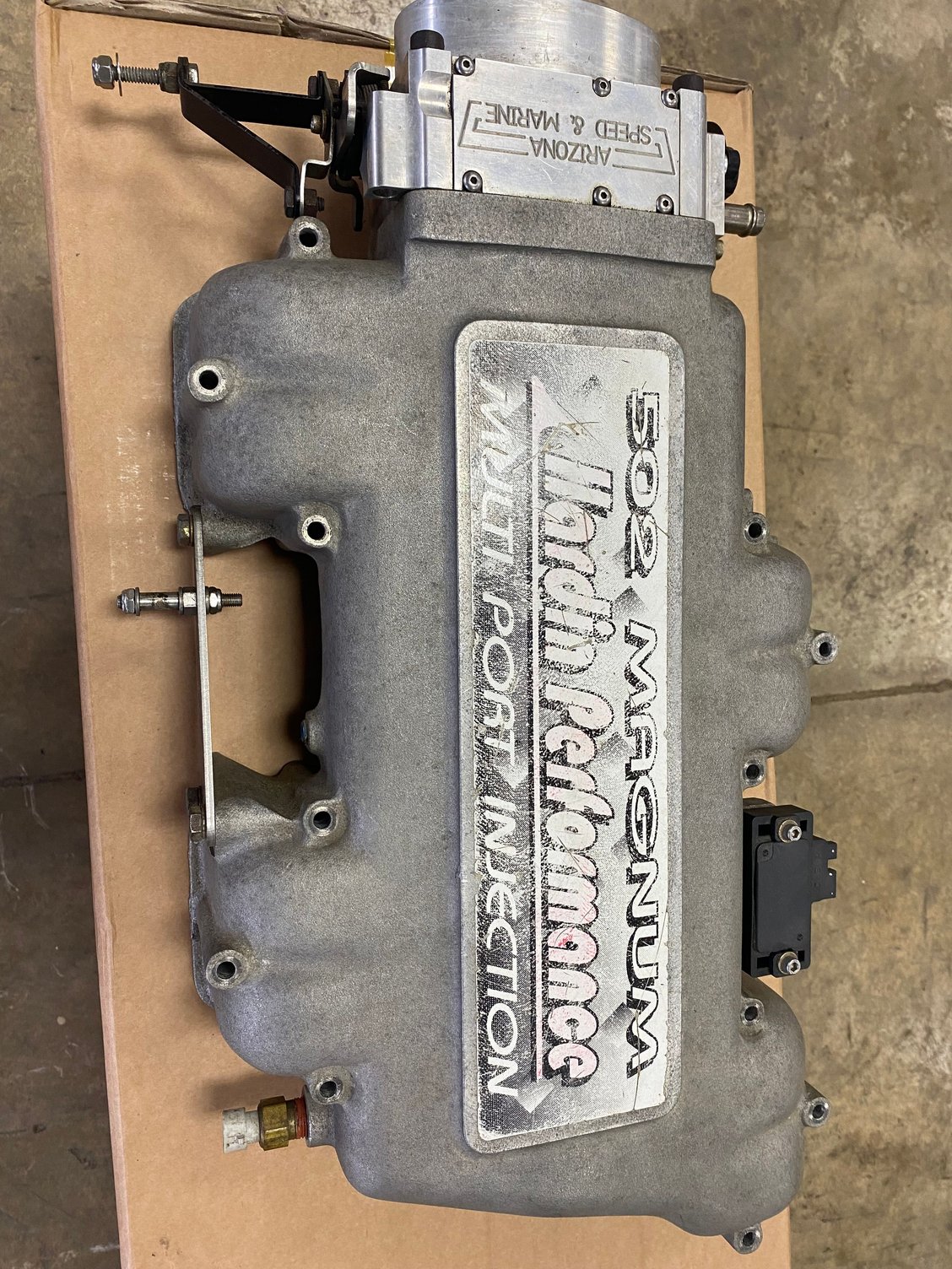

My plan is to go with Promaxx 317 worked heads, the intake is the Hardin Performance MPI with the ASM throttle body. Im told that it is the same intake as a reworked 500 EFI intake.

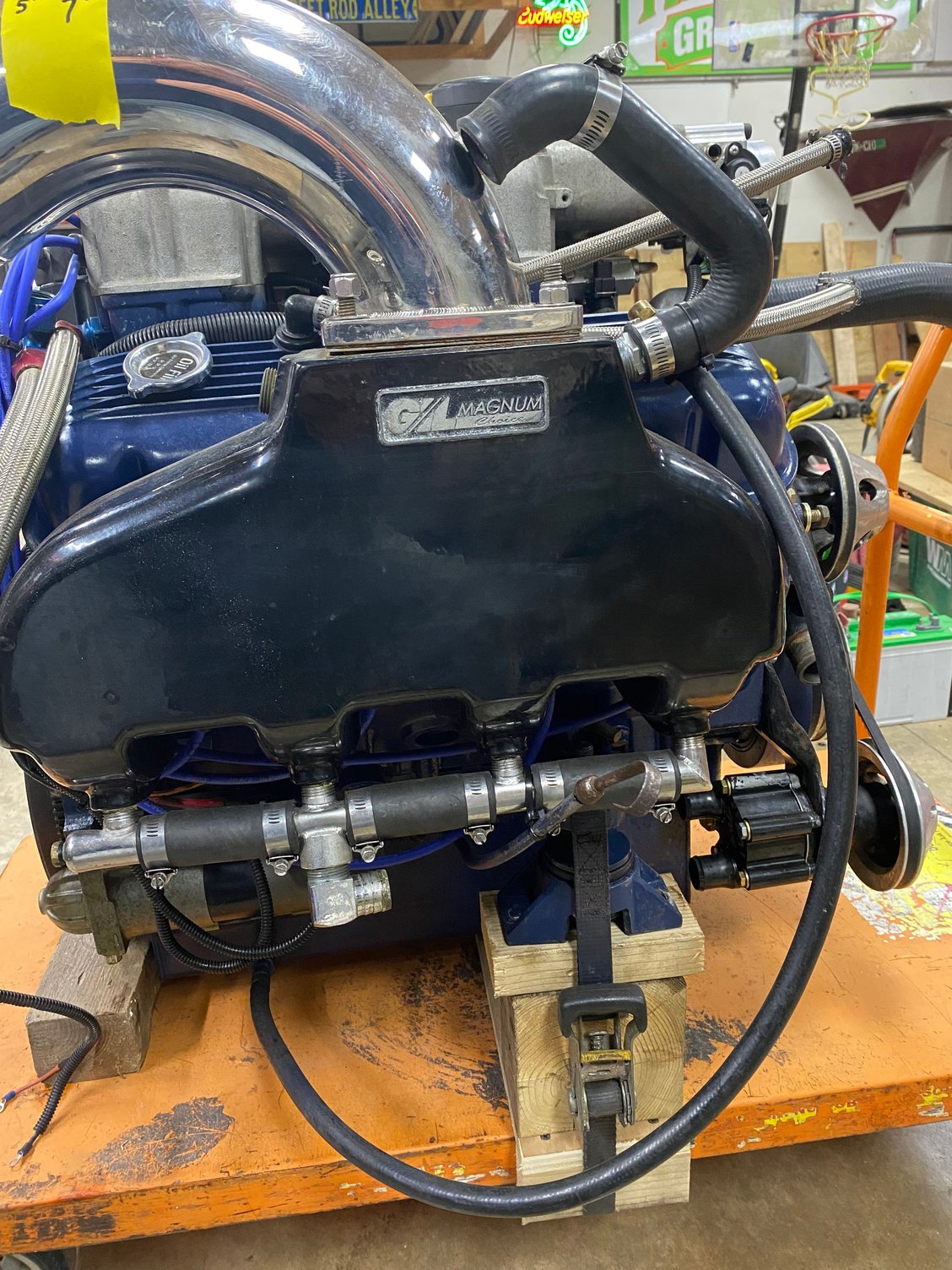

I guess the limiting factor in my equation will be my Gil Magnum Choice exhaust manifolds. Im told that they flow well, but have some reversion issues (any advice I would be grateful for)
