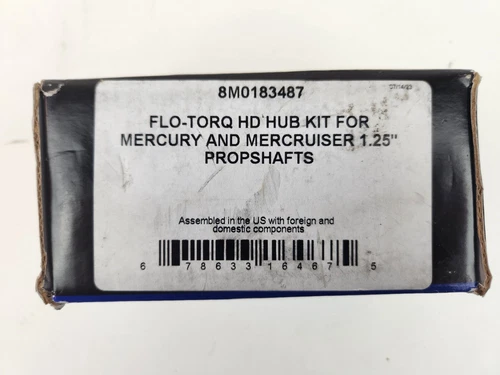

I see a couple variations for this application and was just wondering if this would be correct for my Imco shorty 1.25. Thanks

That's the one you need.

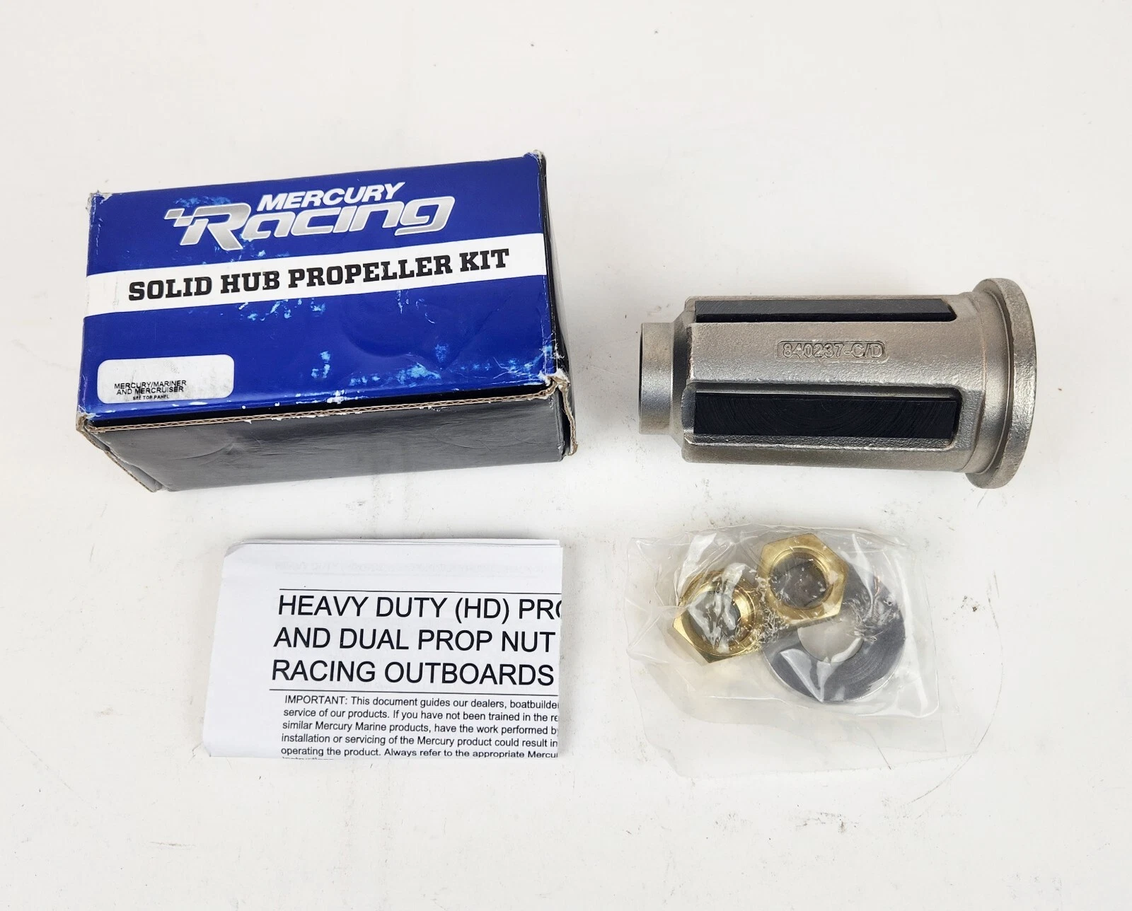

Thanks Brother. Any idea why some have three washers and one nut as compared to this one with two nuts and a washer? Is one just an updated version? Curious.

Honestly I didnt pay attention to the 2 nuts in the package. You are correct the should be 2 heavy washers, 1 crush washer and 1 nut. Alot of time when you see these used the crush washer is long gone, which really doesn't affect anything. The part number is correct though. I have about 8 of these extra that I am going to sell now that my prop shafts are 1 7/16.
Damn, the one in the pic is on the way from Kansas City, MO and was a deal for a new Merc part. I couldn't pass on it.
those nuts look small, I think mine are 1-1/8 socket size......but s Chris said it looks correct.IDK could just be the pic
I guess I'll find out in a few days. So I take it you have the double nut version.
no single
