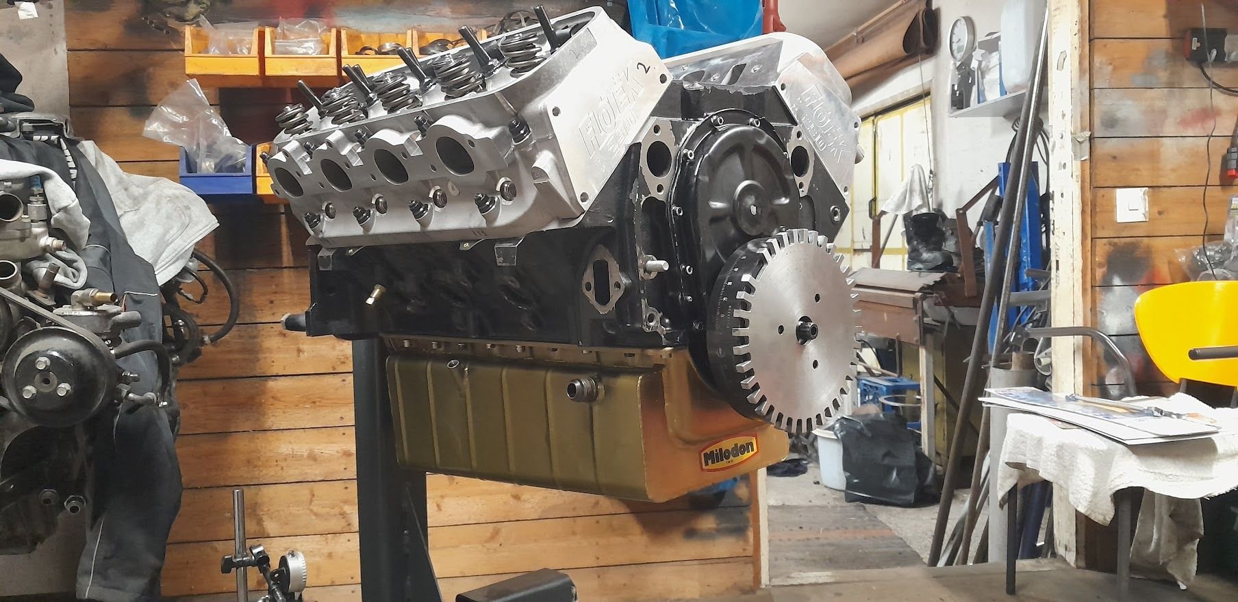

JaniH 09-15-2024 02:16 AM
This project seems to be never ending battle. The oil pan kickout is so wide that there is no chance to make the merc raw water pump to fit. I knew i need some kind of mine starter motor, but i tought the pump would fitt. Wonder how the johnsson F6B-9 crank mount pump would work?
https://cimg8.ibsrv.net/gimg/www.off...c58ae36e71.jpg
sutphen 30 09-15-2024 09:54 AM
make a bracket to kick it out what you need.

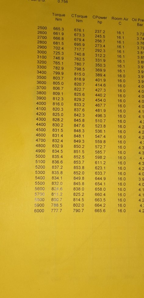

JaniH 02-23-2025 06:17 AM
Engine made 665hp @6000rpm, 854nm @5100rpm. Will post the dyno sheet later.

JaniH 02-23-2025 11:00 AM
Sae j1349 corrected power. 32dg timing. There is still vacum at max rpm, maybe the flame arrestors are restricting the air flow. 2 1000cfm throttle bodies wide open :D

sutphen 30 02-23-2025 01:28 PM
bump that timing to 34°
