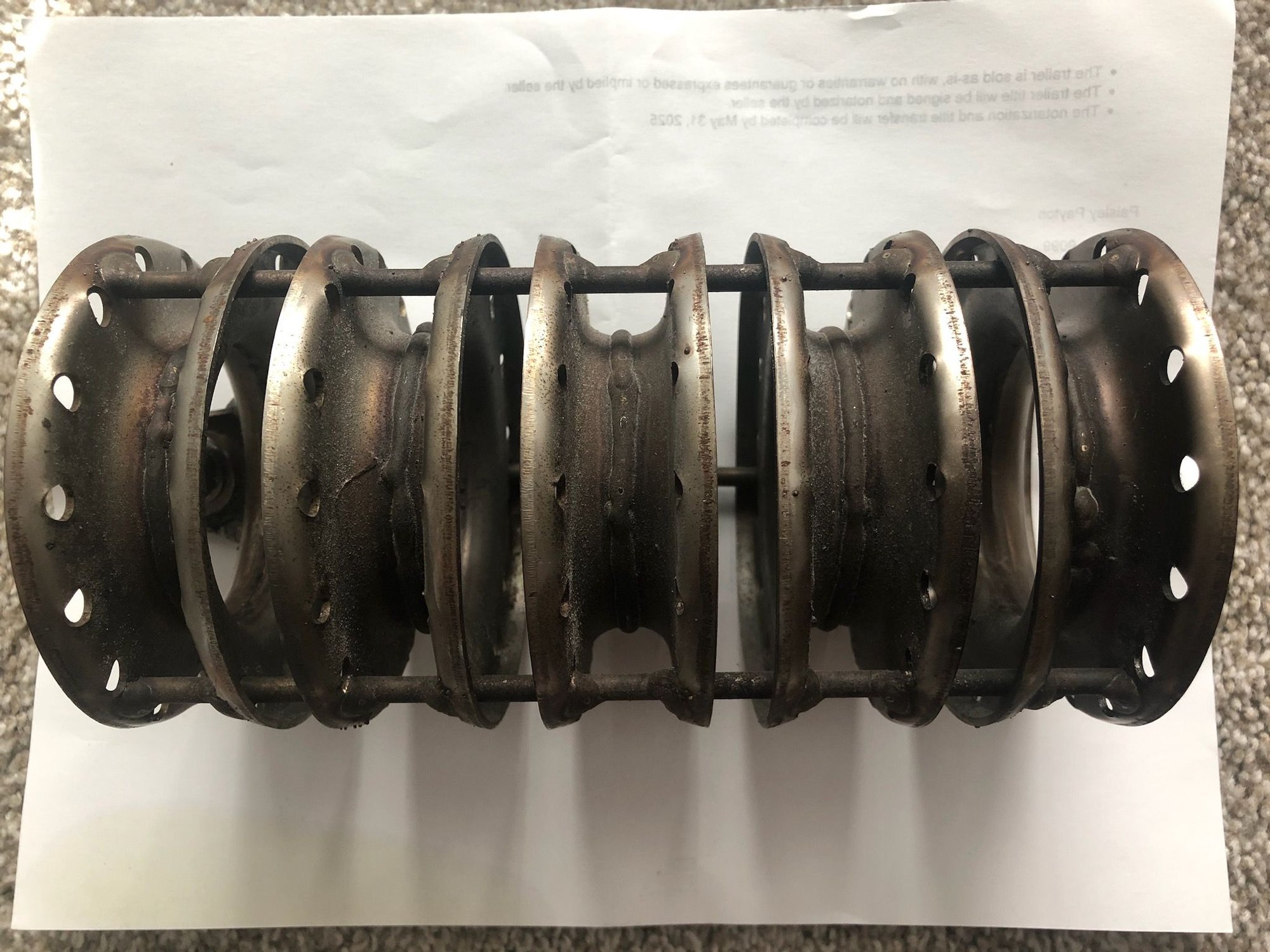

Here's a pic from their website:
And here's a couple pics of the GGB's for reference since I mentioned them. I think these are correct, they're the only pics I found online from nearly 20 years ago:

They look identical to the GGB insert. Only difference i can see is the space between the rings appears a bit larger on the GGb VS. the stainless header insert.

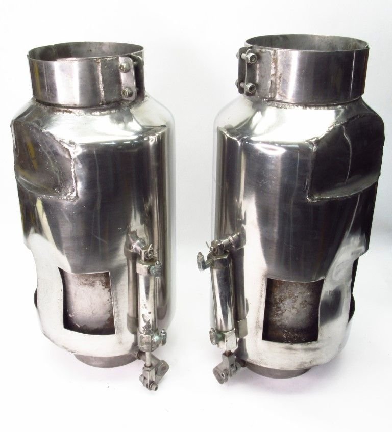

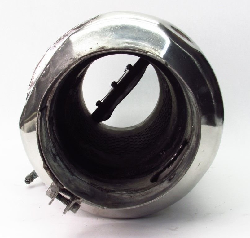

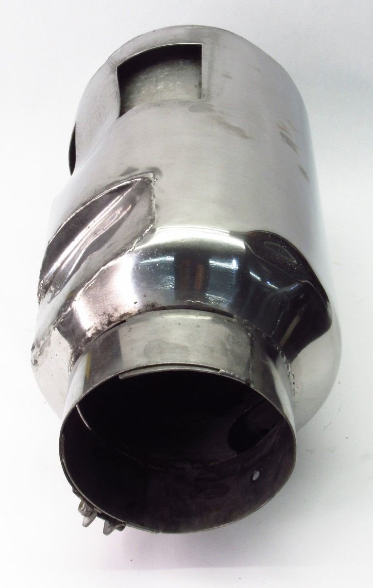

These are some mufflers I made for my BAM Cigarette (RIP). Gaffrig & I sketched out the original design on a napkin at Bootleggers in Ft Lauderdale
1000 HP with Y pipes.
No difference in power open or closed. Made for 5" tail pipes and built to last.
Not pretty but will for sure do the job. Water feed is hidden, 1" hole in top of tailpipe. My tailpipes were really close to the drives, Bottom shows the result from trimming all the way up..
Make offer if interested.
