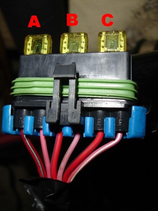

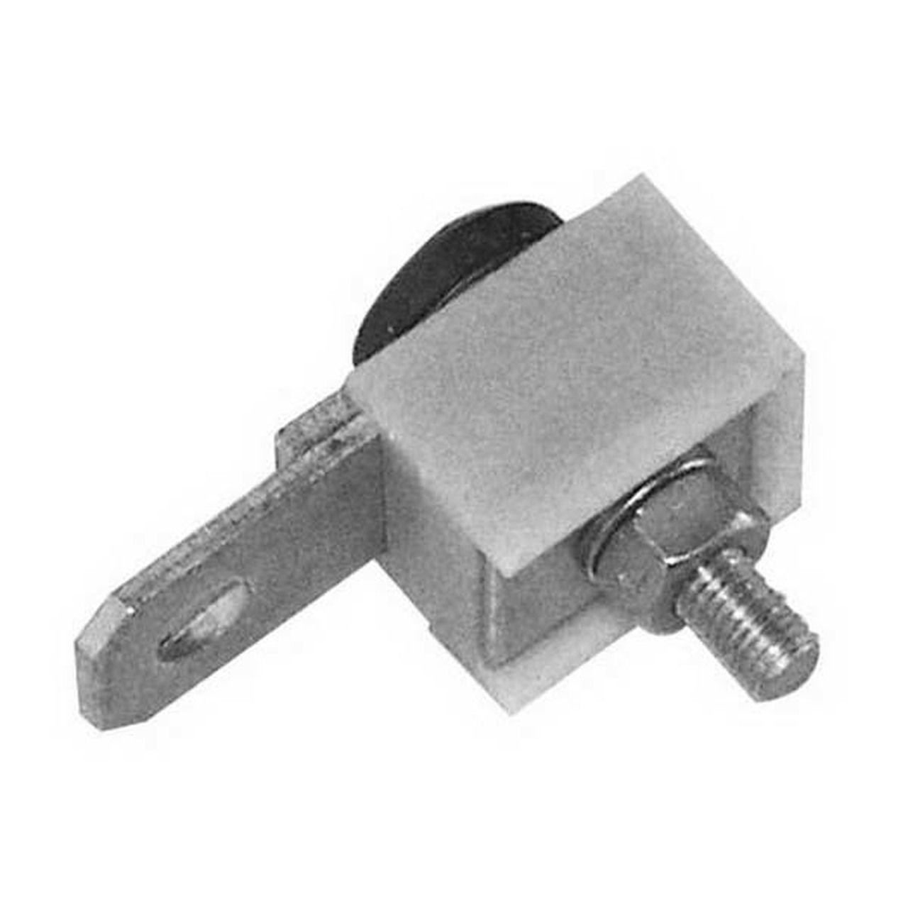

have you checked the fuses on the harness, one is for the fuel pump
where is the inline fuse for the fuel pump on 500 efi? Port motor just quit and when the key is cycled the pump does not come on.
Robert Schwartz is offline
Old 02-03-2025 | 09:45 PM
Joined: Jun 2010
Posts: 4,838
Likes: 928
The inline fuse is on main power post next to starter.
back of the engine pain in the ass…ask me how I know
1MOSES1 is offline
Old 02-03-2025 | 09:48 PM
Joined: May 2022
Posts: 6
From: Hopkins
oh boy of course, I will look into it, thanks
Old 02-03-2025 | 10:07 PM
F-2 Speedy's Avatar
Posts: 11,439
Likes: 3,970
From: Midwest & T-Rock
starter fuse takes power to the top of the engine
fuse holder by the ecm powers the pump
