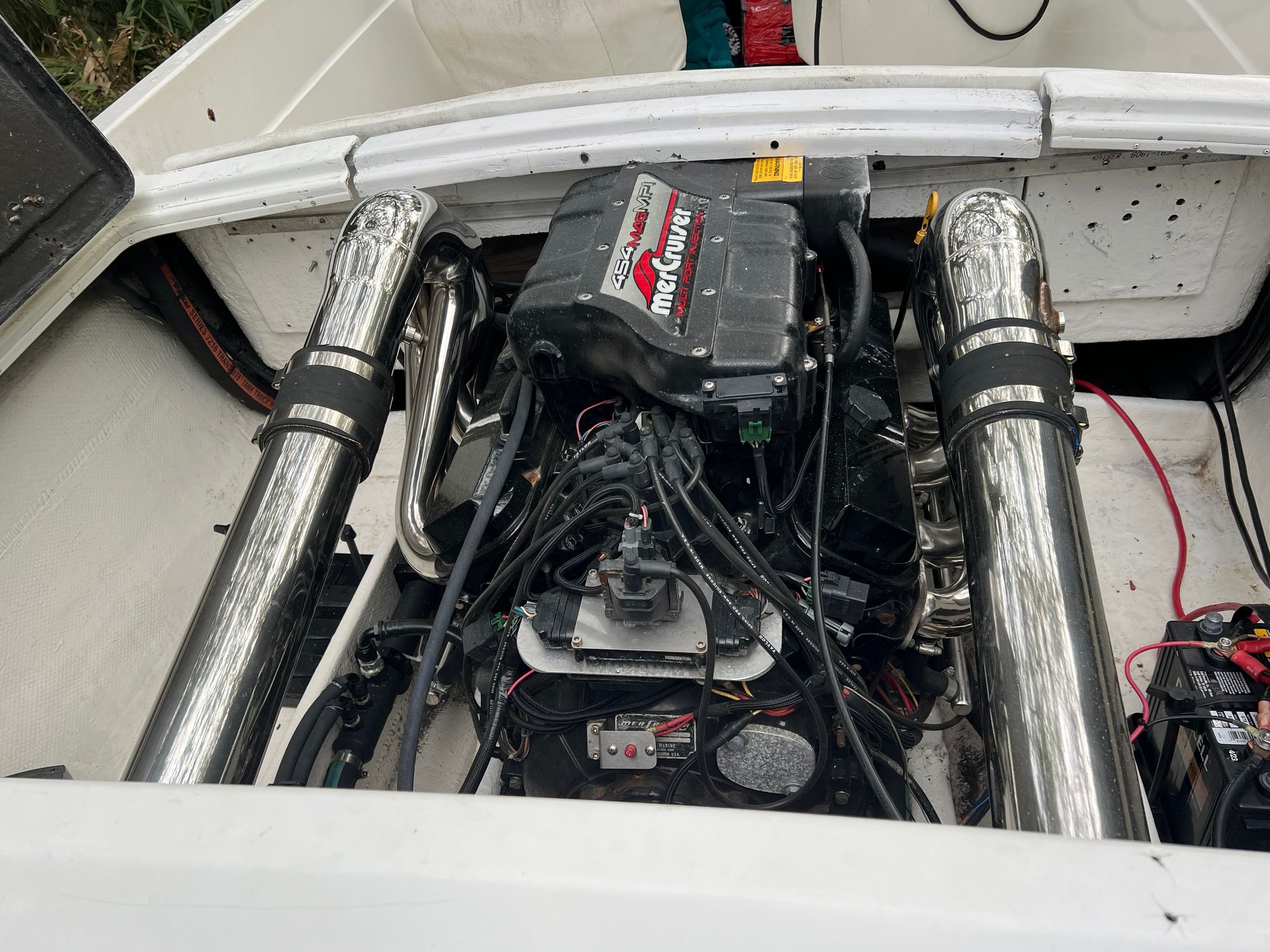

Hey everyone!
I have one that is stumping me.
Excalibur 27x7
454 Mag MPI based 468
Merctrans
TRS Drive
I picked up a boat and noticed it has a vibration, during sea trials I expected it to be the u joint going to the drive.
I got it home and realized that the vibration is NOT in the drive. So I started by checking out the engine out, making sure that the timing was not off, making sure that I was firing on all cyl., etc. engine is running well and is pretty smooth at idle for a choppy cam.
What I have is a vibration that gets worse with speed through 3000 RPMs, literally rattling the floor. Way worse than say a race car with solid motor mounts.
Correct me if I am wrong, all 454s are externally balanced? That means that the proper flywheel must be used otherwise we will have issues.
Before I rip the drive, engine, and gear out to verify this, is there anything else I could check? Any of you all run into this problem before?
Thanks!
