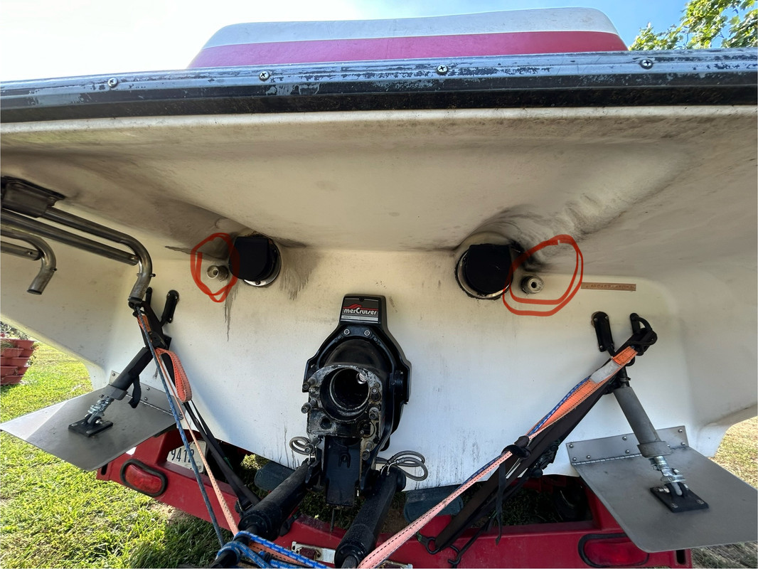

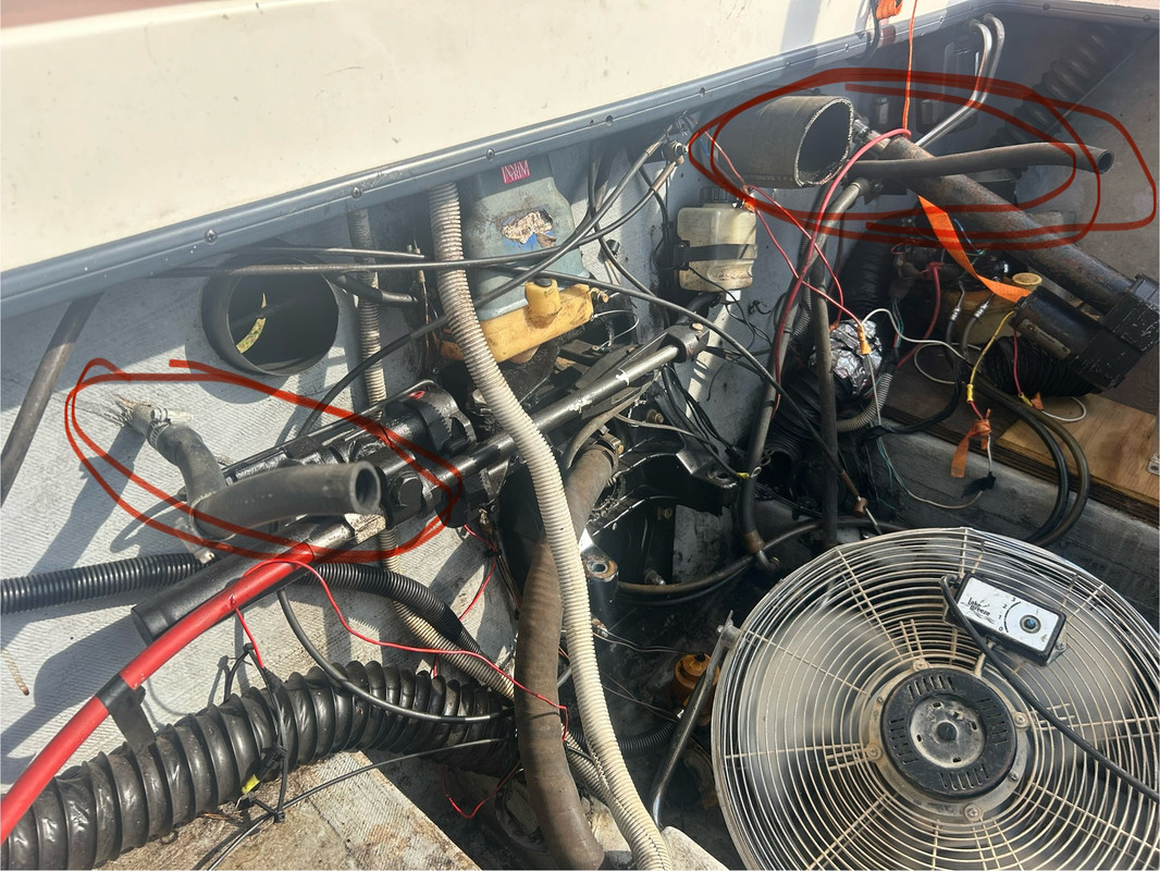

anyways, today looking it over I saw these 2 hoses and outlets mounted to the transom near the exhaust outlets and am wondering what they were/are for???
is it possible this was one time a dry exhaust and they routed the water through there or am I missing something else?
also while we’re at it, I decoded the serial numbers on my outdrive case and accord to what I found it says it’s a Aplha 1 gen 2 drive?
surely that’s not factory for a bandit is it?
if so how hard would it be to switch everything over to a bravo 1 if I wanted?
I included some pics so you all can see what I’m talking about.
I circled it in red.
thanks

definitly for dry exhaust those 2 hoses !
to switch to bravo, you are going to fill in the transom ( read redo transom) and cut hole for bravo making sure sure X dimension or the height of your drive will be perfectly at the right height to be able to plane, and reach the best top speed possible !

That’s a bravo transom assy.
The most noticeable difference is the shift linkage on the alpha,
It’s not there, just the cable that sticks out of the bell housing on a bravo
I had a 91 bandit, cool looking, fast, fun boat, ride wasn’t great unless you were on relatively smooth water, due to the 15* bottom

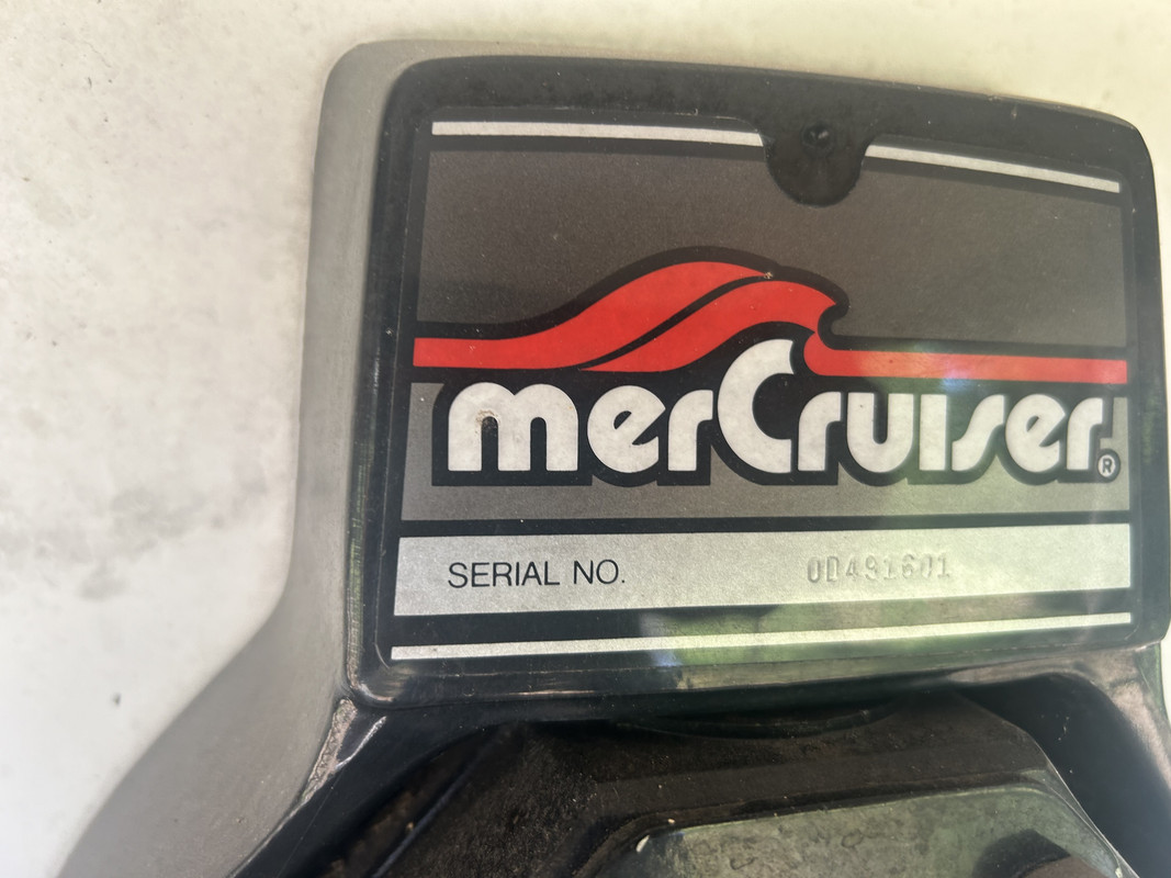

According to my serial number off the housing.
the numbers are as follows,
hope you can read that.
I get OD491601 it’s off a 1991 Baja bandit.
unless it is not original it was added later.
and yes I’m going to use a big block.
Tom272Baja is offline

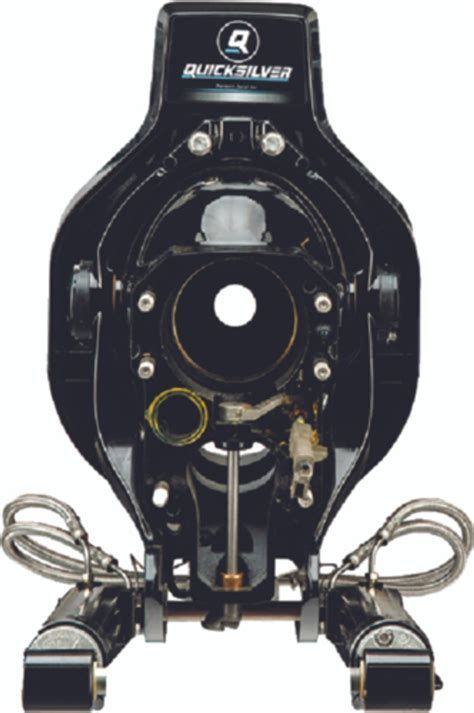

Here is a picture of an Alpha 1 gen 2 transom assy, notice the shift shaft running down the middle of the exhaust cavity?……. the one on the boat doesn’t have that, it’s a bravo
JaayTeee is offline
