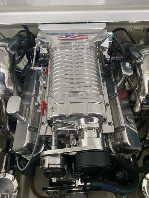

Does anybody have the procedure for adjusting the idle air control valve on a 3.3L Whipple ? It has the common Gm IAC , it's been replaced . The TPS is adjusted to around .5 volt. The main throttle blade stop has been adjusted numerous times , the supercharger auxiliary air valve has been upgraded from the restricted bronze filter to the larger fitting with the small K&N air filter . The problem is , the idle doesn't flair when I start the engine , hot or cold . I just recently replaced a bad by-pass air valve actuator also , the last one the diaphragm was bad . I would like the idle to come up a little when cold / first start , and maybe come up a little when I drop in gear . The computer is set for 750 rpm as per indicated in scan tool . The engine is 565 CI Paul Phaff with a 3.3 L Whipple that I added at a later date . I do have ground and power to the IAC connector . Any thoughts , comments ?
This is the IAC and upgraded aux air intake
This is the blower aux air valve actuator that I just replaced
Top of engine

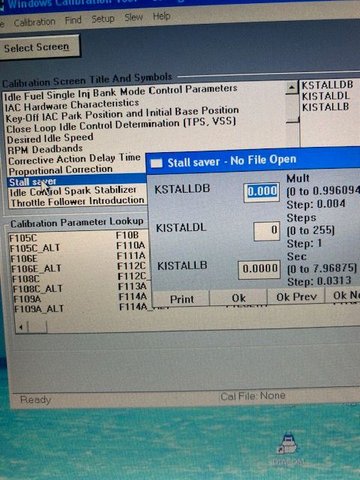

I'll fire up my laptop and look,mefi4b's can change the rate of opening and closing.for some vortech 540's I ran dual iac's.also had a switch on the trans for load anticipation which would call for a certain amount of iac opening.

heres what can be done to the iac and supporting ecu functions for drive ability.this was for the 4b,,but I looked at mefi3's parameters and they had basically the same thing.
what tuning program are you using?
