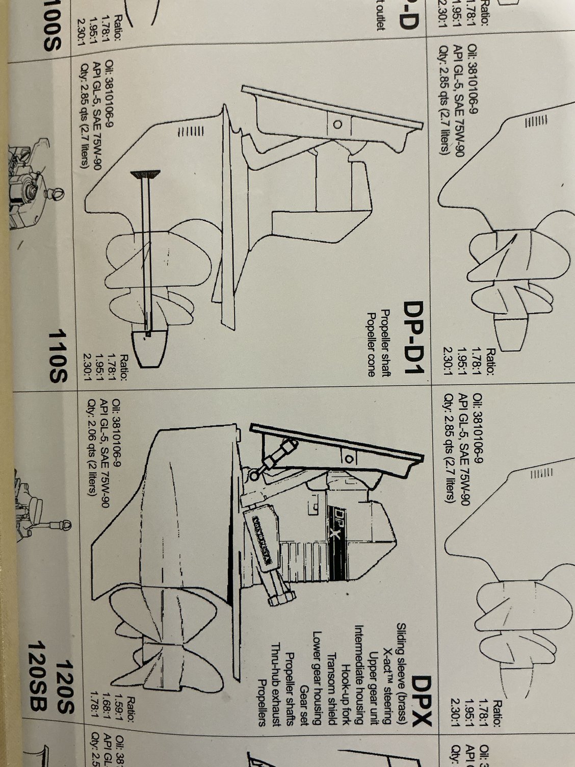

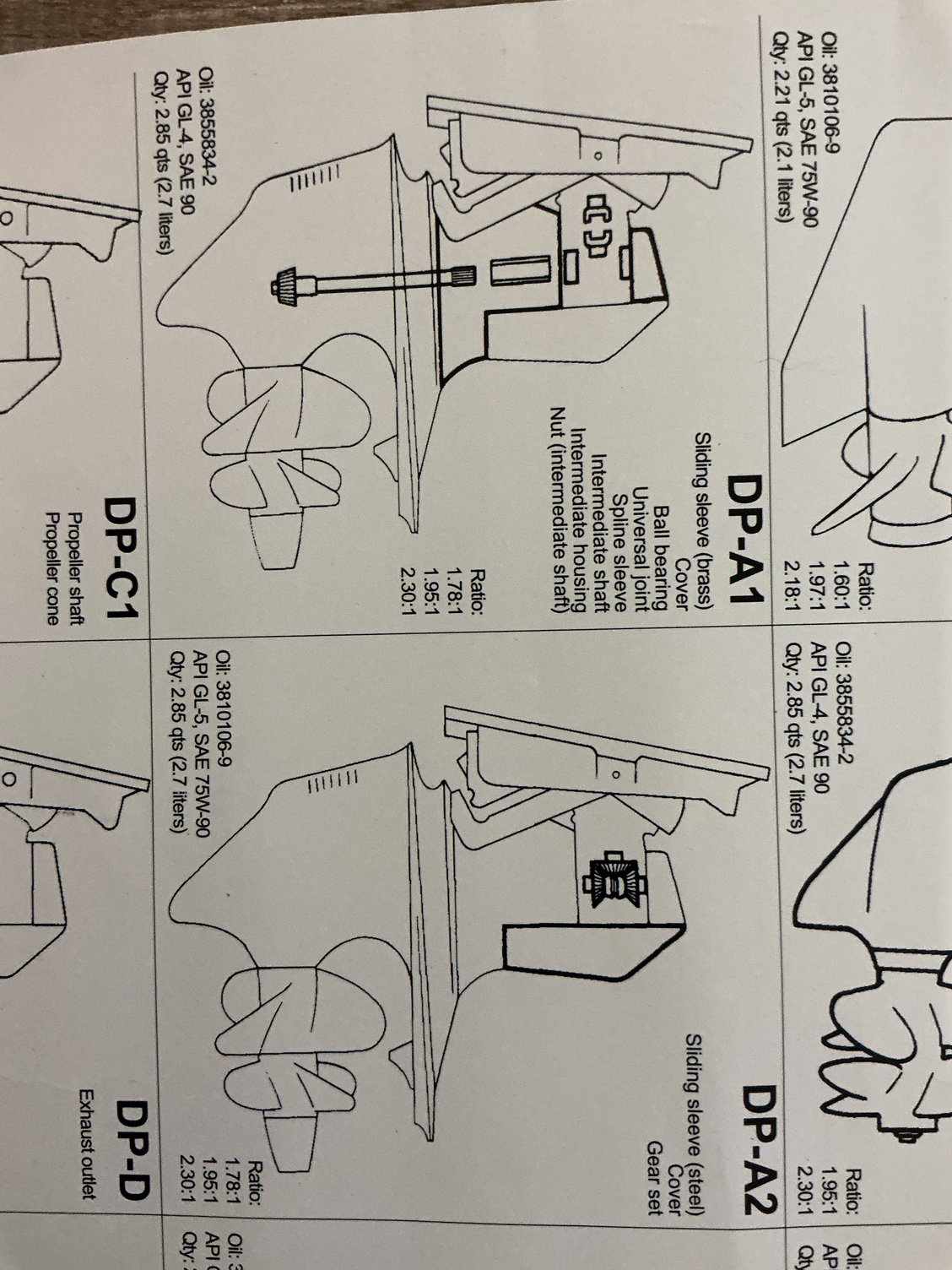

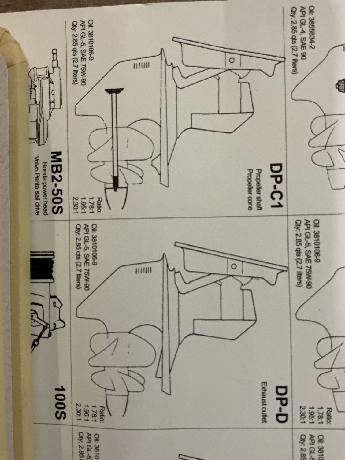

496blower 04-27-2026 11:17 PM
Here is a pic of the Volvo drives and their oil requirements, it’s a long diagram but took oic of maybe what you have, I know some of the early 280 drives say use 30wt oil, I have always run 75/90 in those just not synthetic 75/90, on all my dp drives the synthetic 75/90 will get pic of the oil can tomorrow for you

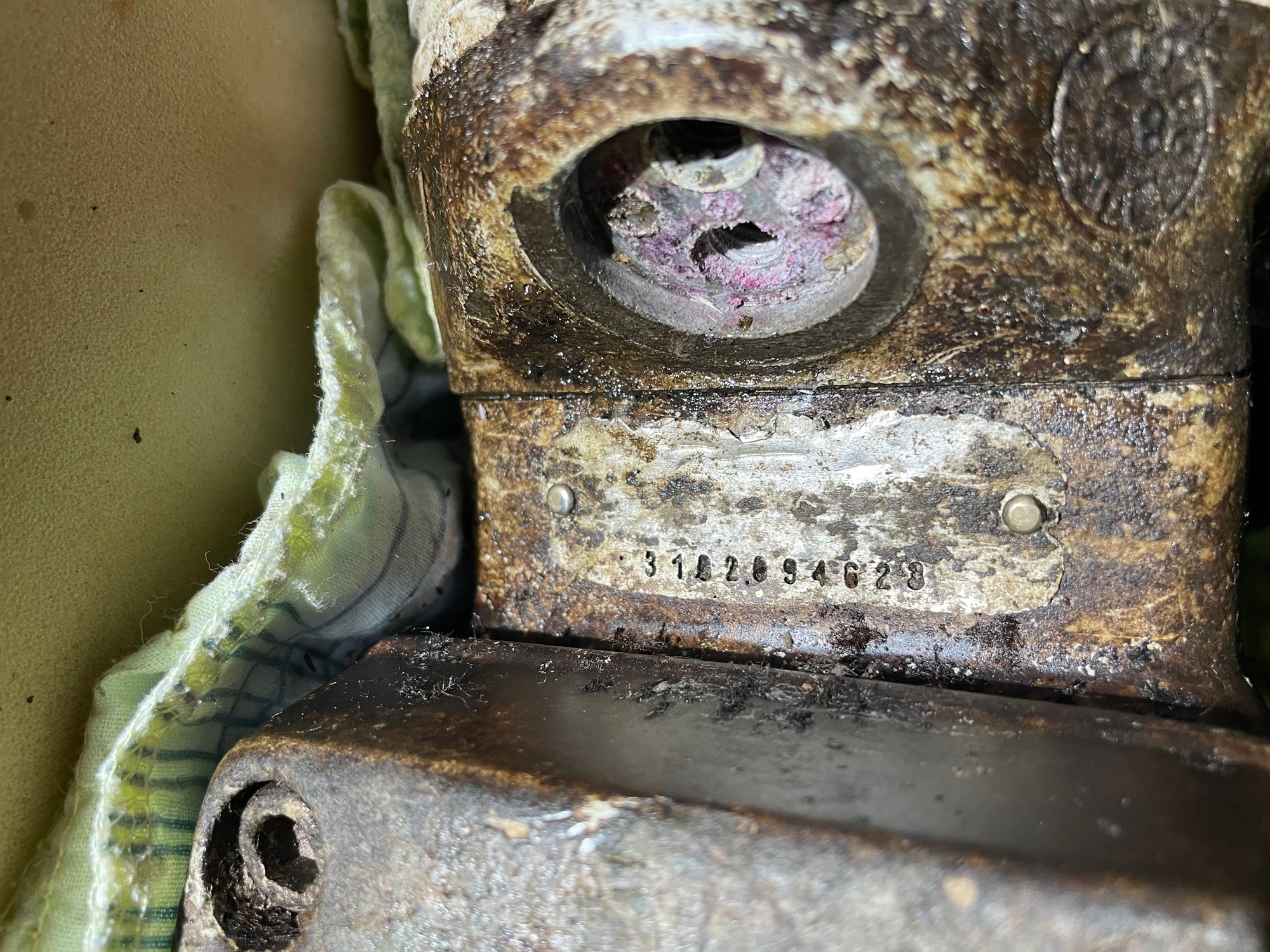

Thank you very much! Unfortunately the identification number on the little metal plate corroded away so I'm not 100% sure what DP version I have.
Have to spend some time going through the silhouettes to look for features which match my sterndrive.

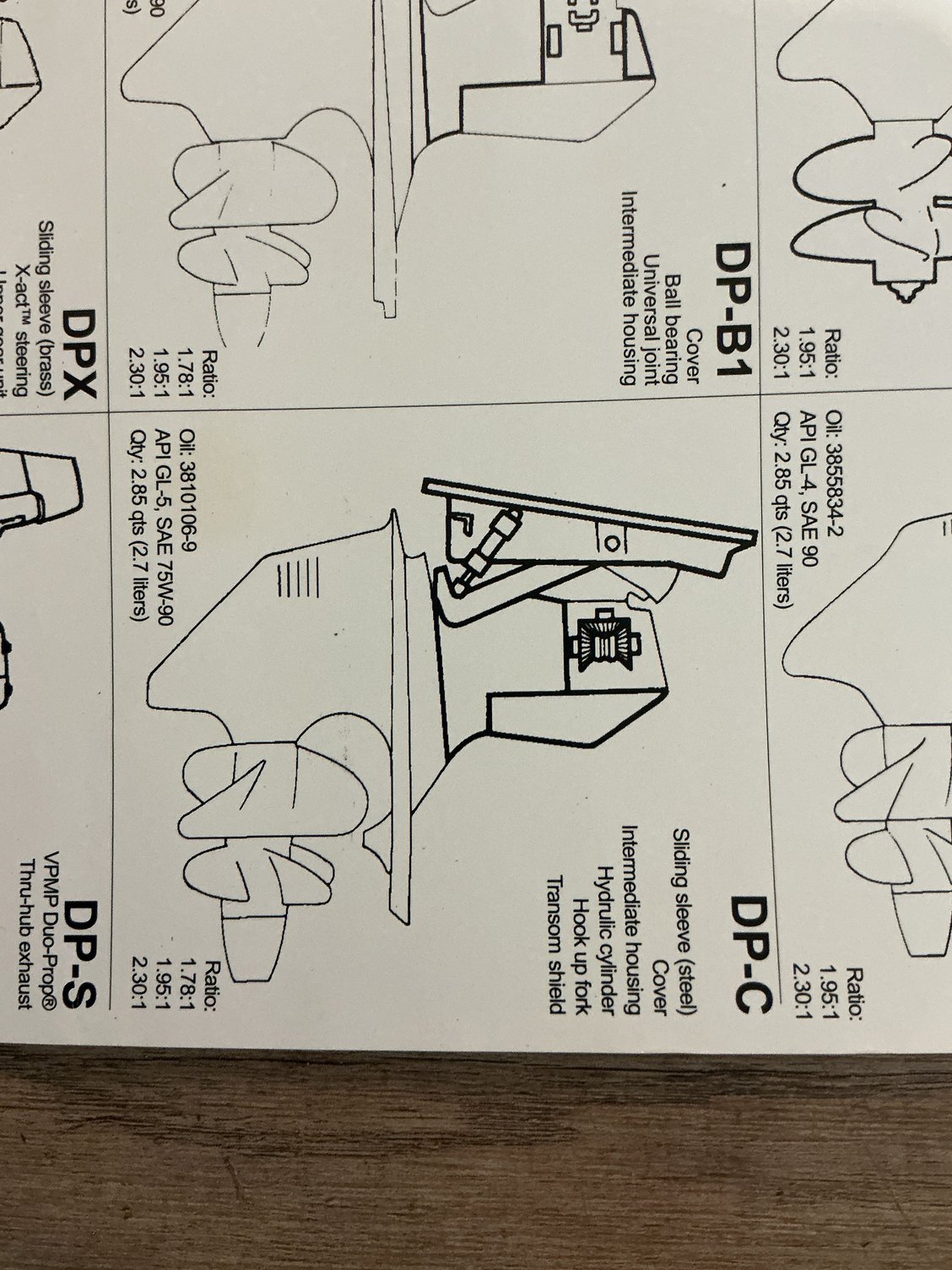

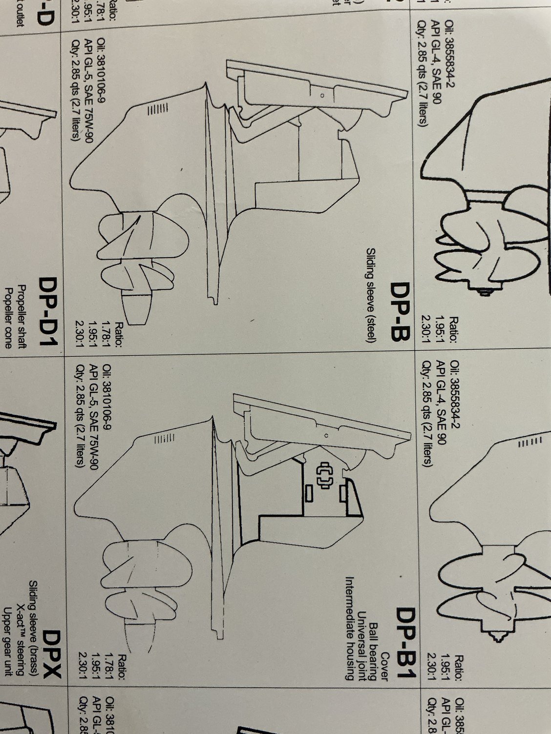

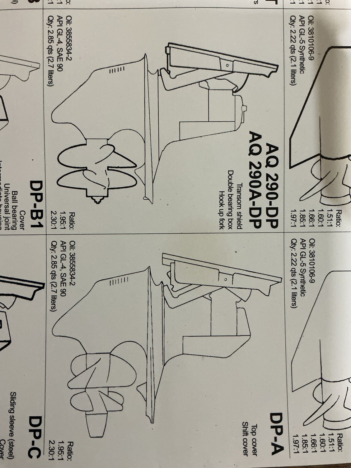

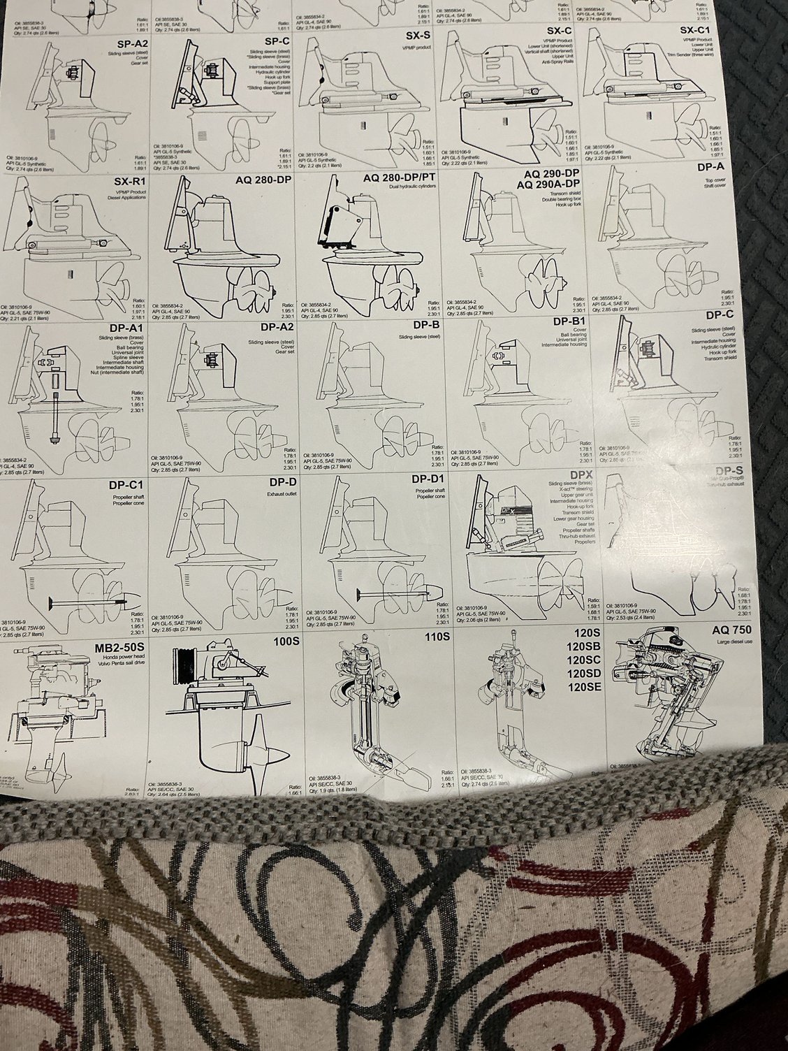

496blower 05-01-2026 09:17 PM
I know A and B series have a metal bracket that the power trim rams mount to on the drive, I think c,d,e series the rams mount directly on the drive., I will try and take closer up pics of the drive diagrams, unfortunately too large to scan and email

496blower 05-01-2026 09:28 PM
This is some close ups of drives, it does not show dpe but its is the same as the D and uses vp gl5 75/90, the earlier models show gl4 90, not sure Volvo makes that anymore, check your Volvo dealer. Sorry my guy is out and have not had a chance to speak with him

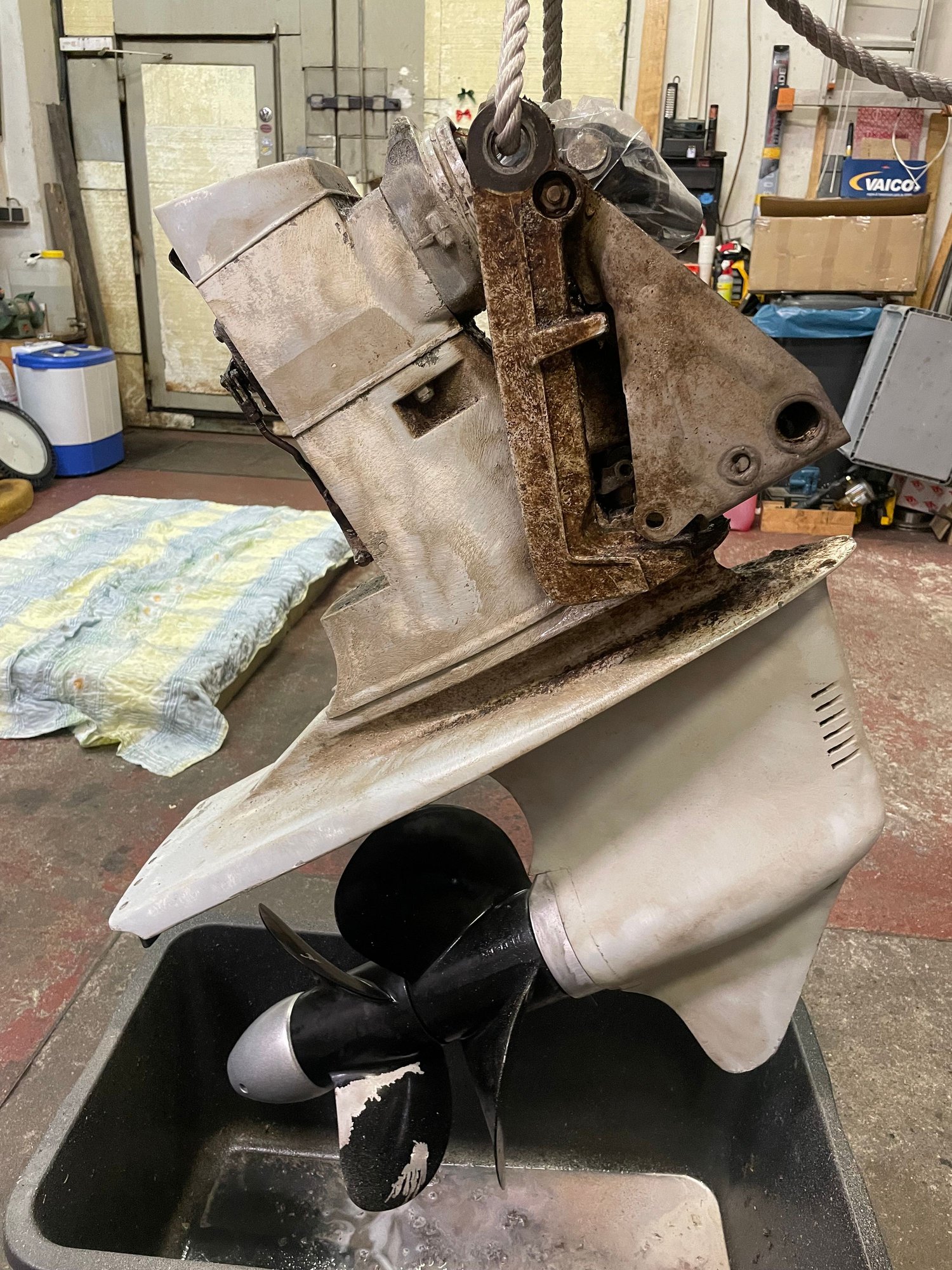

Insane87 05-03-2026 10:44 AM
Hi
Here are three older pictures. One from the previous owner and two while I was cleaning it after the purchase.
https://cimg8.ibsrv.net/gimg/www.off...a3f41f495a.jpg
https://cimg4.ibsrv.net/gimg/www.off...d9299b424.jpeg
https://cimg3.ibsrv.net/gimg/www.off...d0b1bbddb.jpeg
