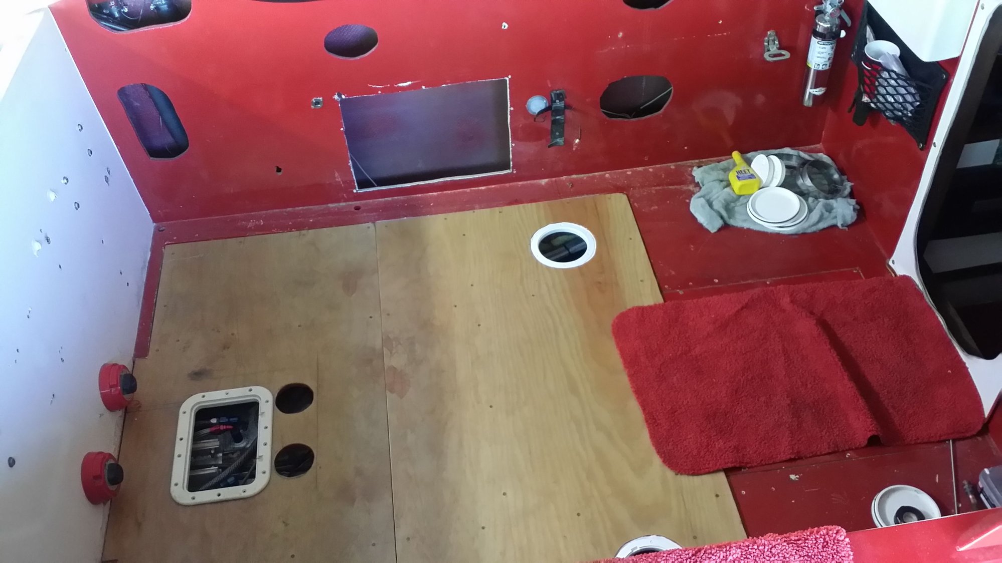

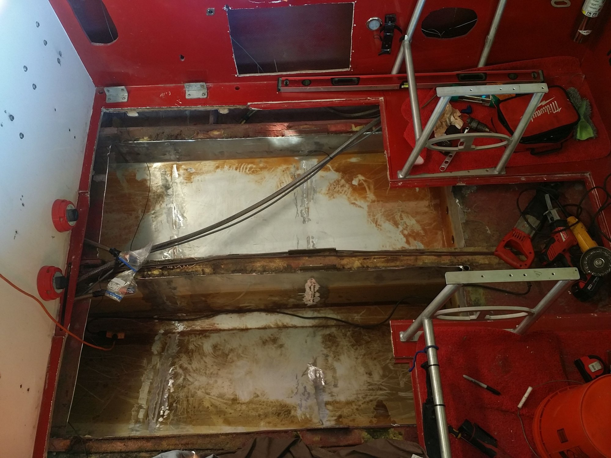

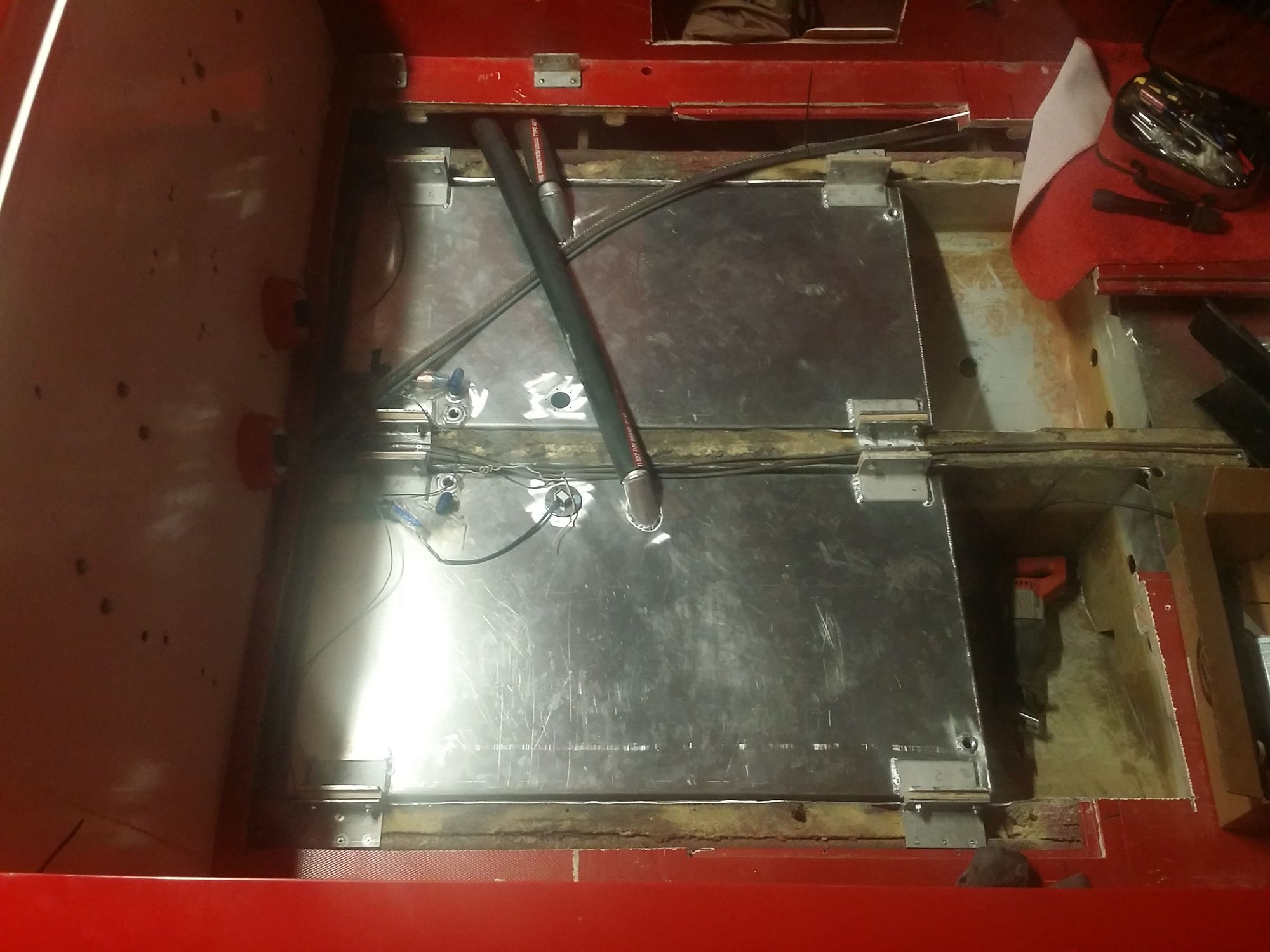

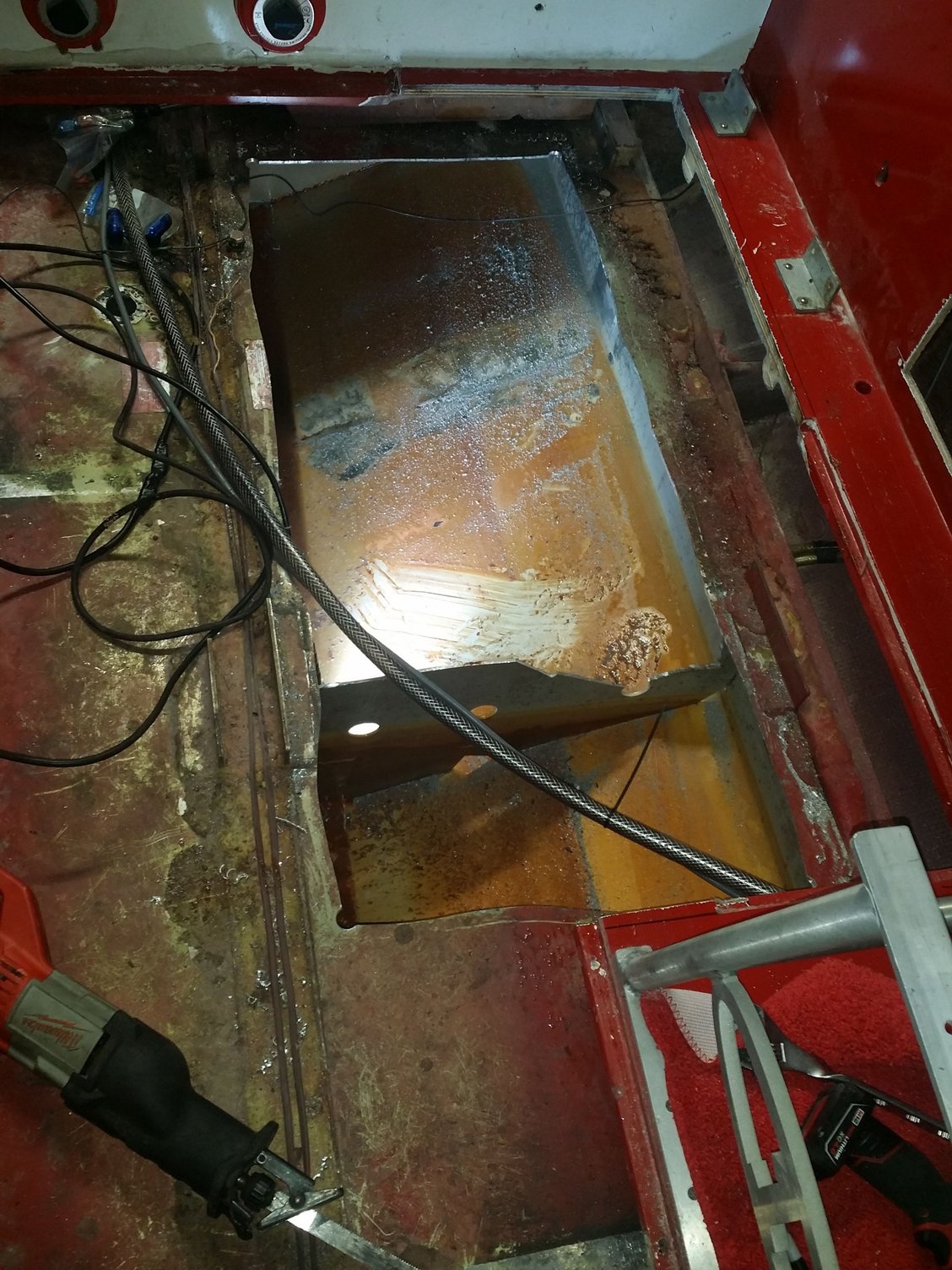

Thats was a project I`d rather forget .

-10An for return and supply.
3/4 bungs.
I remember when you first came on the site and excited about your new flat deck. Next thing we know you’re cutting up the floor, at the time I thought to myself what a rude awakening to buying a big expensive Hole in the wallet.
Whoops you did it again .
