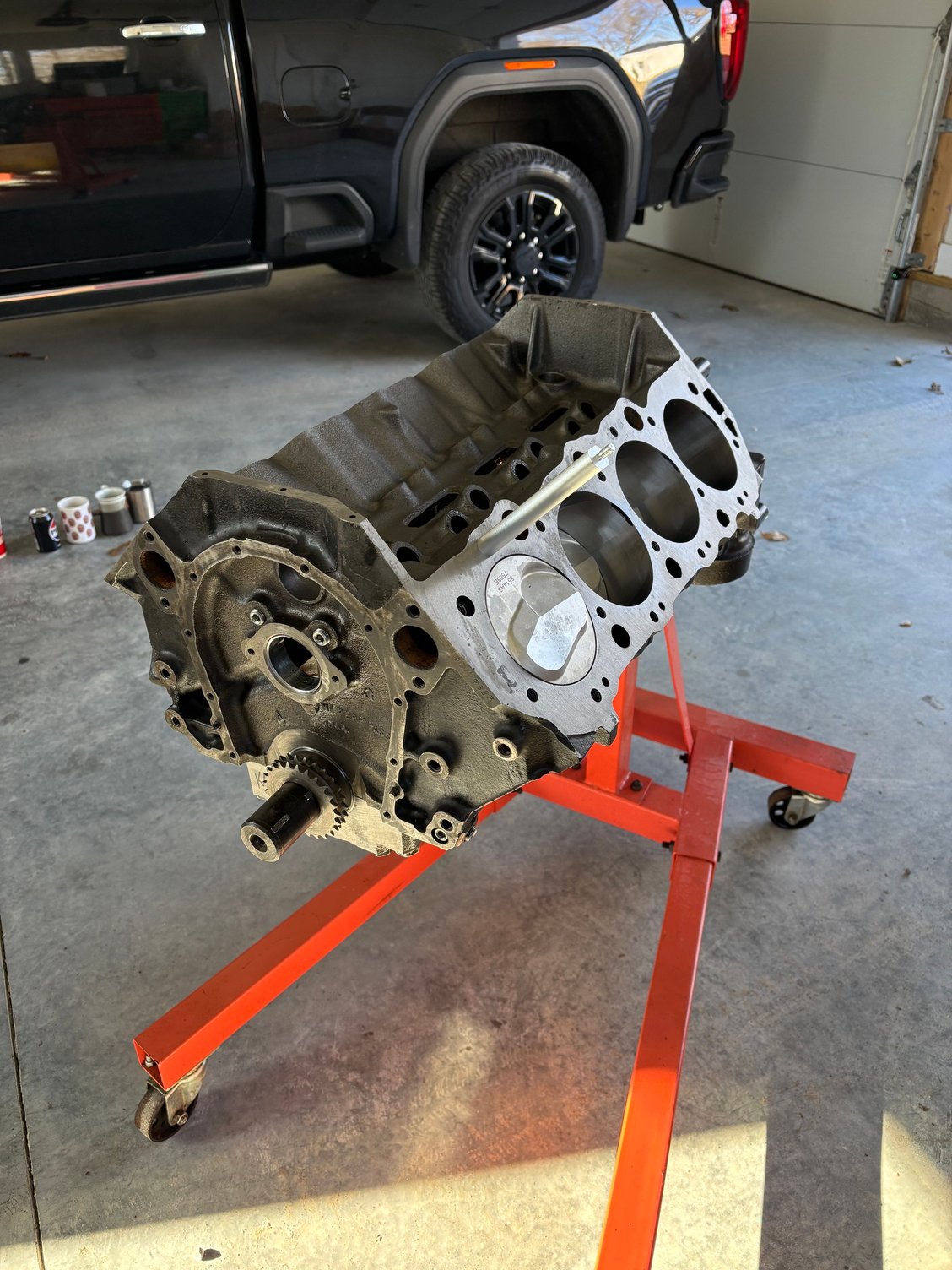

Got back from machine shop and got short block done, installed cam tonight. See shot of card.
SkiDoc is offline

Need help picking head gaskets. The block was decked and I did not have the machinist do a smooth finish. As a matter of fact it seems rough. The heads are very smooth. I purchased some cometic mls .040 gasket and now realize that a rough surface is problematic with a MLS style gasket. The short block is assembled and I don't want to go back. From the research that I have done it seems like a copper gasket with the seals seems like the best selection for the situation, a rough surface deck and very smooth head?

I always use Fel-Pro 17042. I have been using a light film Permatex 80697 copper spray with great results.

Thanks how do you apply it? Do you tape off cylinders? Thanks
SkiDoc is offline
Old 03-14-2025 | 08:11 AM
Posts: 3,601
Likes: 1,169
From: taxachusetts
just spray the gaskets
