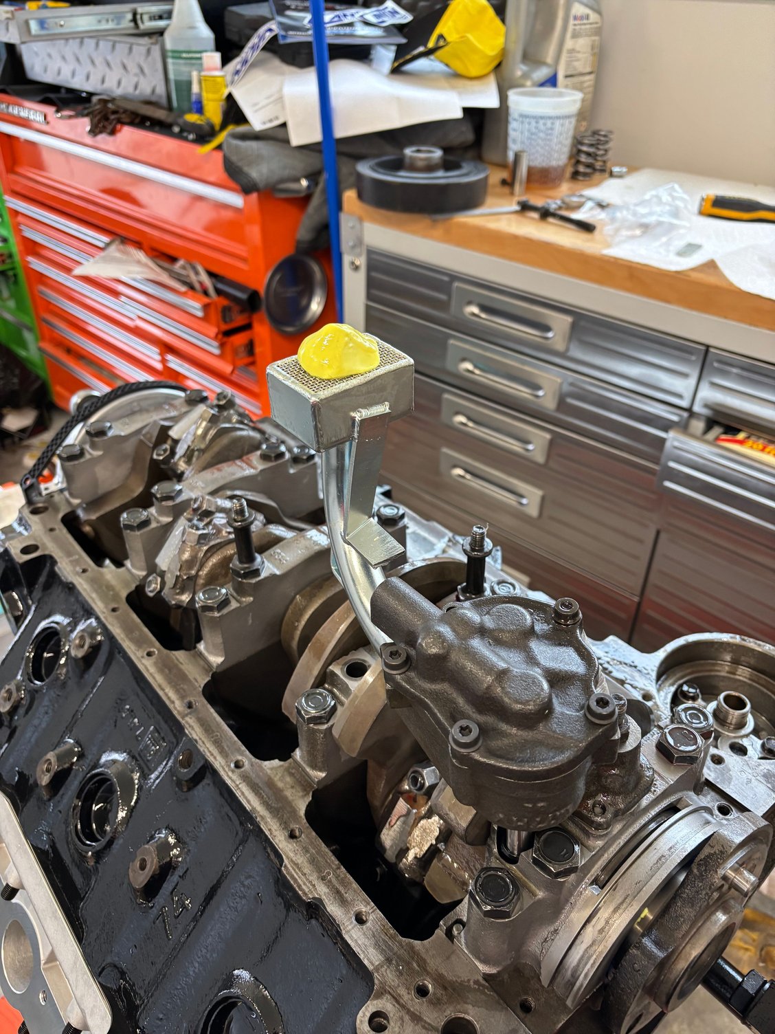

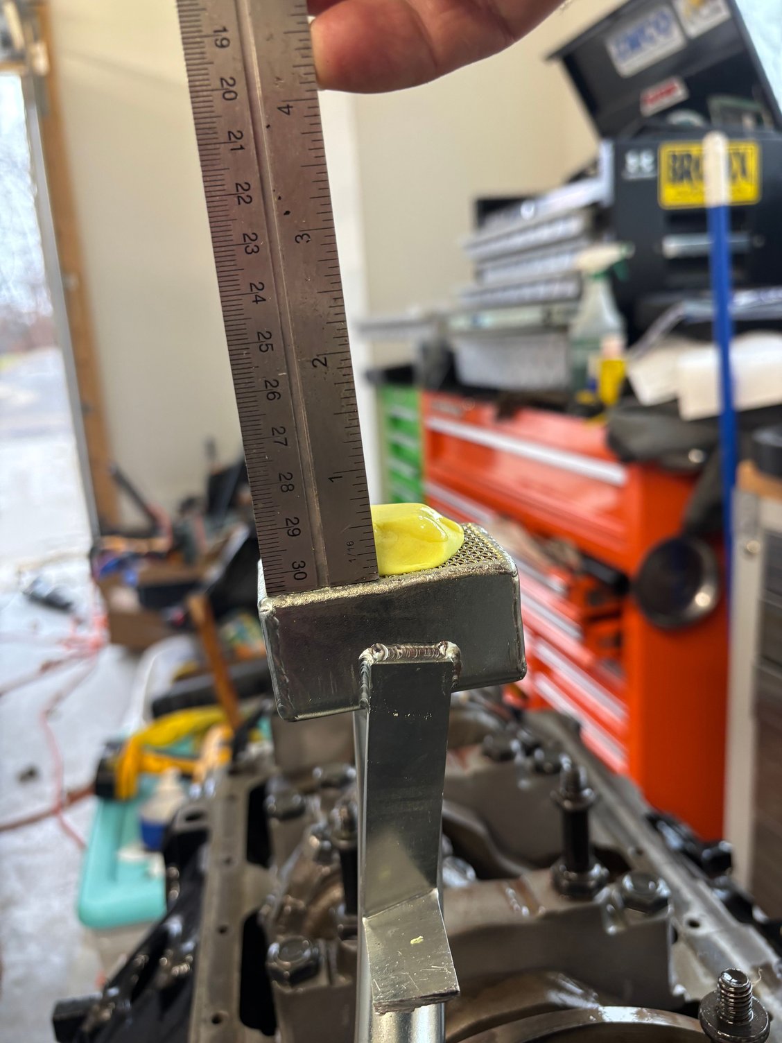

I ordered some of the FelPro head gaskets. I hate to waste money but it seems that everyone has had no issues with them. Assembly should be done this week just as soon as I get the head gaskets balancer and push rods. I disassembled 2 cylinders of head and all the guides were finished nicely. I should have checked them all.
i ordered some of Jegs dowels, installed them and the heads wouldn’t go down. The dowels were.007 wider than the head! I taped the whole deck and dremeled them down. Got the high volume pump installed, customized the pick up and welded it to the pump.
Thanks for the help

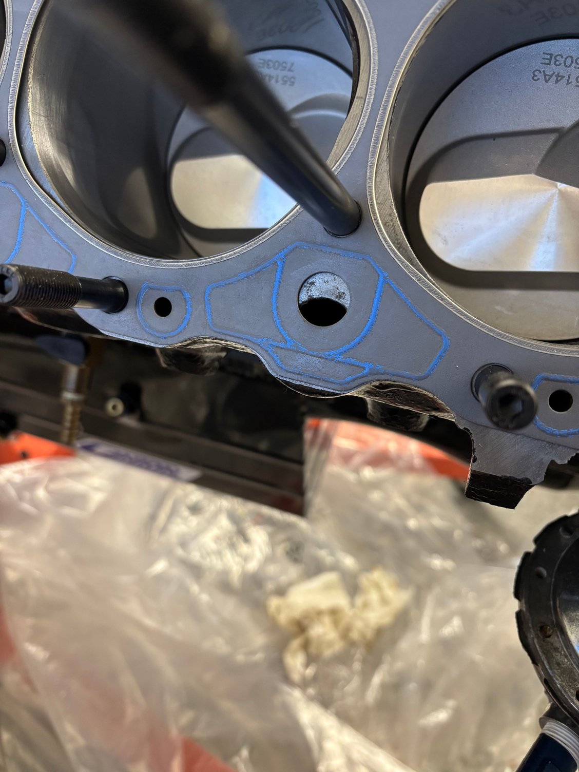

Should I do anything about the discrepancy between the water hole in the block and the head gasket. The old head gasket, the cometic, and the new FelPro are all mismatched the same way?
what is the gasket part number? What block mk4?

Please post a picture of front and rear of gasket, gasket installed to the block.
