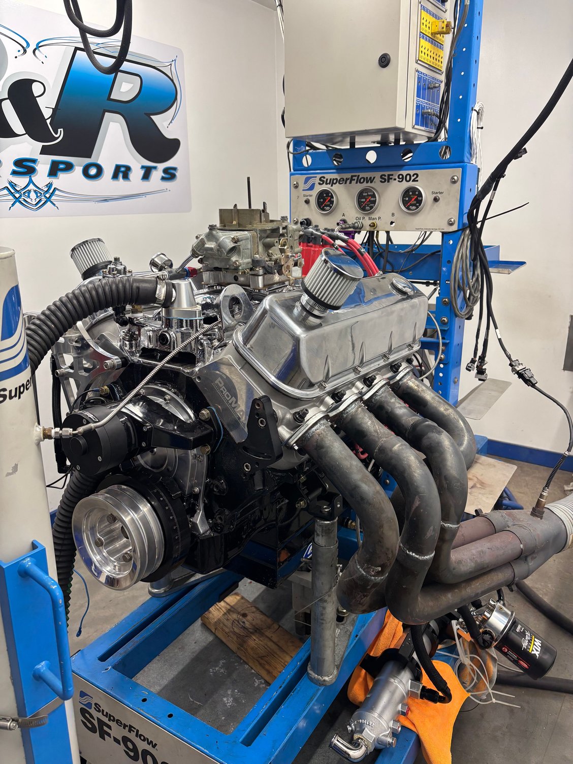

Finally did dyno the engine. Thanks to Ray at R&R Motorsports. I will post the sheets. Ended up about 530 HP and lots of low RPM torque. I made the mistake of not buying a new carb and just using the old one so that compromised my ability to tune in the idle. I’m not sure anything significantly more going to happen on the big end.
i was really nervous this being my first build but it didn’t scatter and it looks like I built a good engine. No leaks. It went very well. I’ll post more data so that it can help others with their build choices.

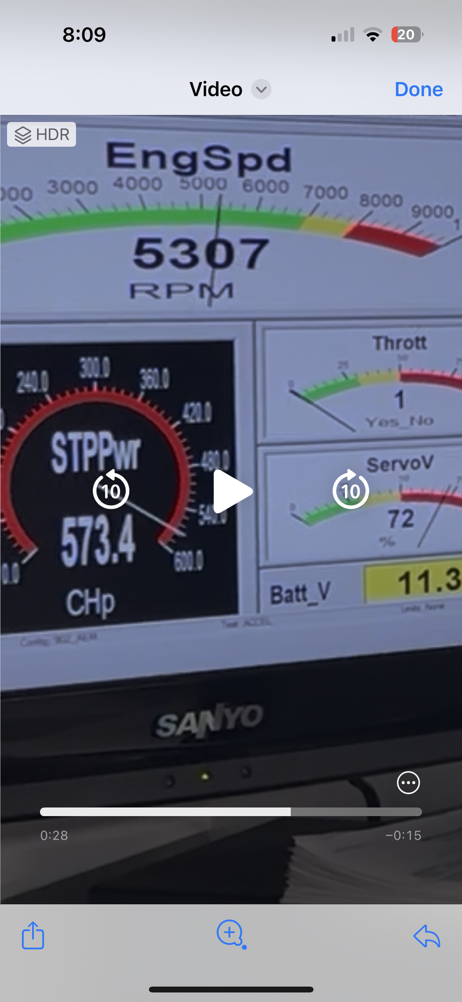

This is a snap from video of the best pull with not my carb was the best Hp. Was a Willy’s carb. I will post sheet in a few when I get to office
