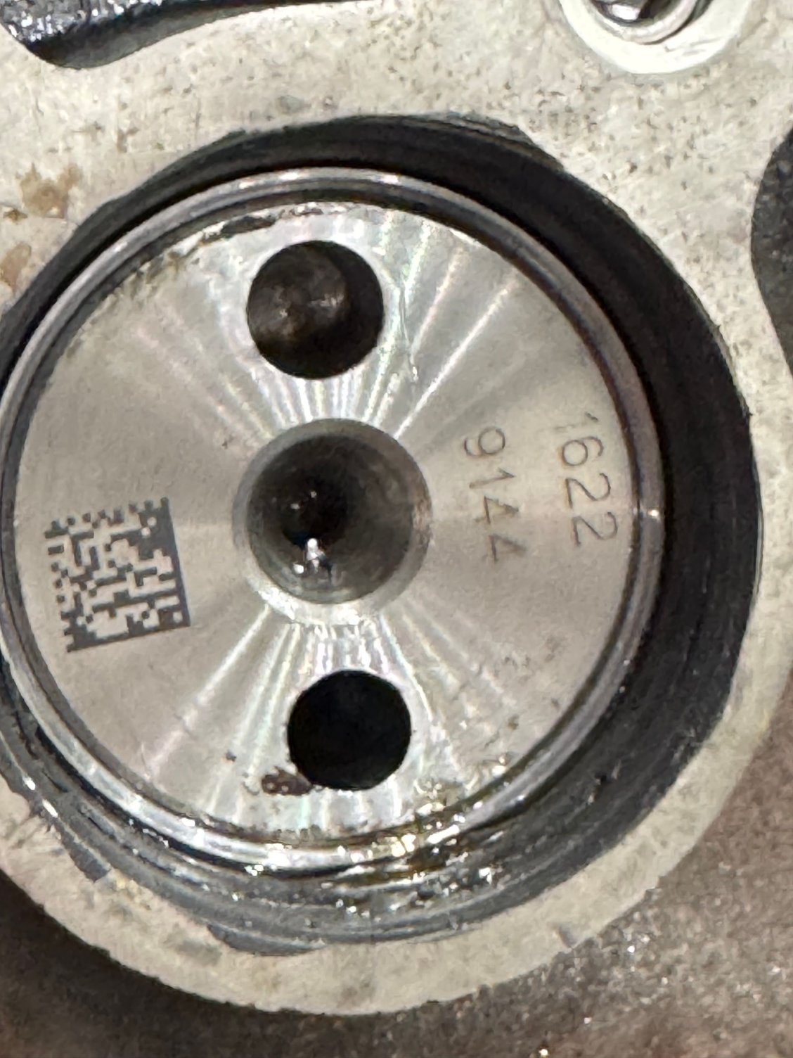

What does this cam tell you. Once the engine was rebuilt, it ingests a small amount of water and we cannot seem to figure the issue out. It has captains call and Flappers on the tips. Possibly looking into the cam being an issue.
When we pull the exhaust off there is water around the valves, and when we pull the intake there’s water in the valley.
Here’s what we have checked.
Block
Heads
Oil Cooler
Intake
Exhaust
Any help is appreciated! Thank you.

can you take a pic of your engine in the boat w/ the exhaust.are you sure you don't have a small exhaust leak,,that will suck back water.

All new Exhaust, All new Corsa

Can you scan that upc code with your phone and get any info ?
We have all tried to scan it. No dice.

and why was the engine rebuilt?
Engines were originally going for top ends just as a refresher. The owner decided a full rebuild was a better option so there was “no issues” in the future.

are they original cams before rebuilds ? this happening on one or both engines, who rebuilt them
This is happening on both engines. The work order from the builder said he replaced with “good used cams”
it’s a gentleman out of Lebanon Mo.

need to know the specs on the cam,if he put hp500 efi cams in,,that cast iron exhaust is a problem.also,look round the exhaust ports for signs of leaking exhaust gas.that will cause reversion.
