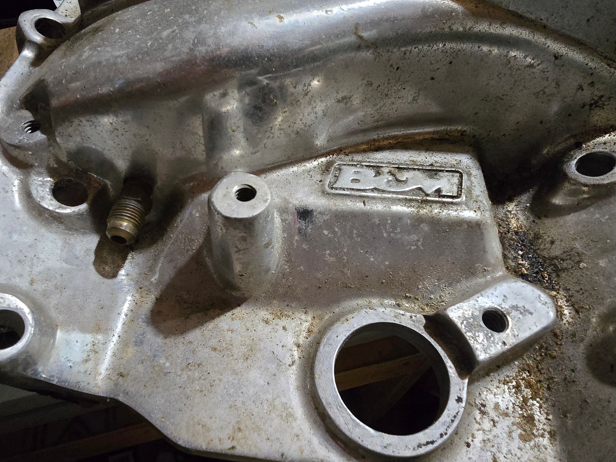

Originally Posted by A.O.26
btw where is the best spot to install air temp sensor?
This is a photo of my 420 Megablower BBC intake. Assuming the 250 intake is the same thing.
Not sure this is stock...but there's a boost pressure port at the rear of the intake. You could probably drill/tap anywhere along the rear rinner here. In the center would not interfere with flow as much. Should be short enough to not interfere with the distributor.
Or if you don't have a sprung back fire plate, then you could use that to make up another plate with some meat to drill/tap there.
There may be port on the 250 blower bottom you can use. I'll check my 420...but it's packaged up atm.
