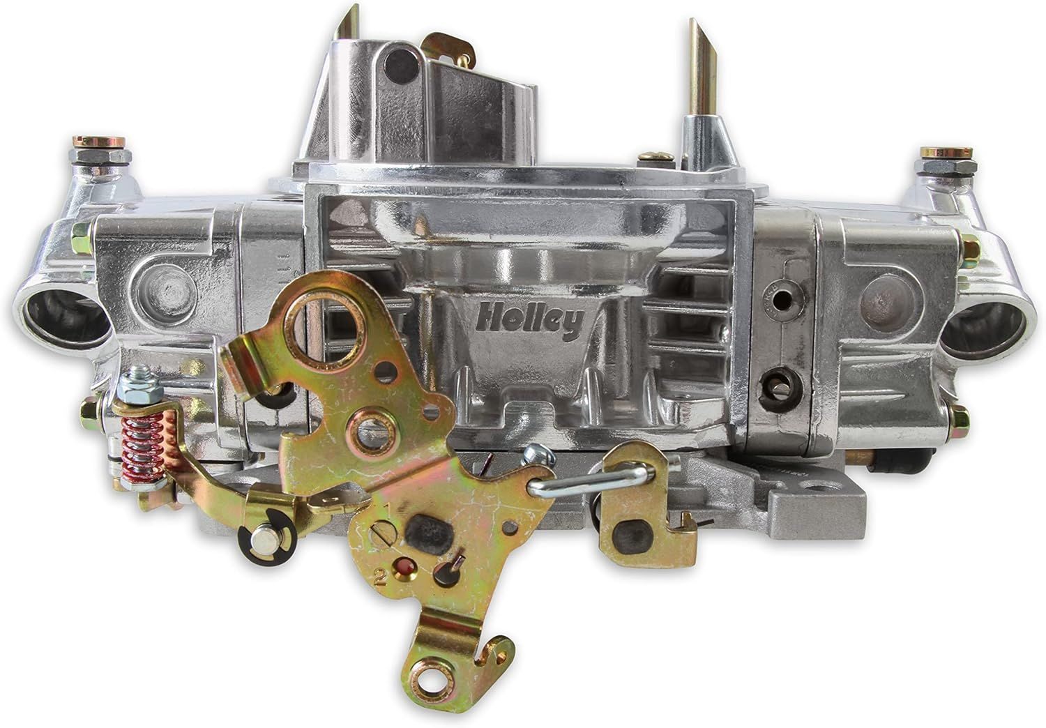

Holley 0-4779S Street/Strip 750 CFM Square Bore 4-Barrel Mechanical Secondary Manual Choke New Carburetor
AO,
Just to put it out there.... The carb in the pic is not a marine carb. Don't know if the carbs you are using are the same, but those overflow tubes should really be J-tubes. Or so I'm told....

you can put a rubber hose betw. them and cut a hole in the upper most part of the hose.had that set up for years on my boat,never a problem.

AO,
Thanks. Brad.
Brad is correct...this likely would not be to USCG spec.
USCG only requires that the excess fuel from the carb would drain into the carb and intake.
Pulling and twisting the bowl vents so the angled cut faces the carb bores, would meet the USCG requirements.
All throttle shafts are sealed...or you would have a vacuum leak.
Insurance providers may have other requirements. But we're talking safety and the legal requirements.
