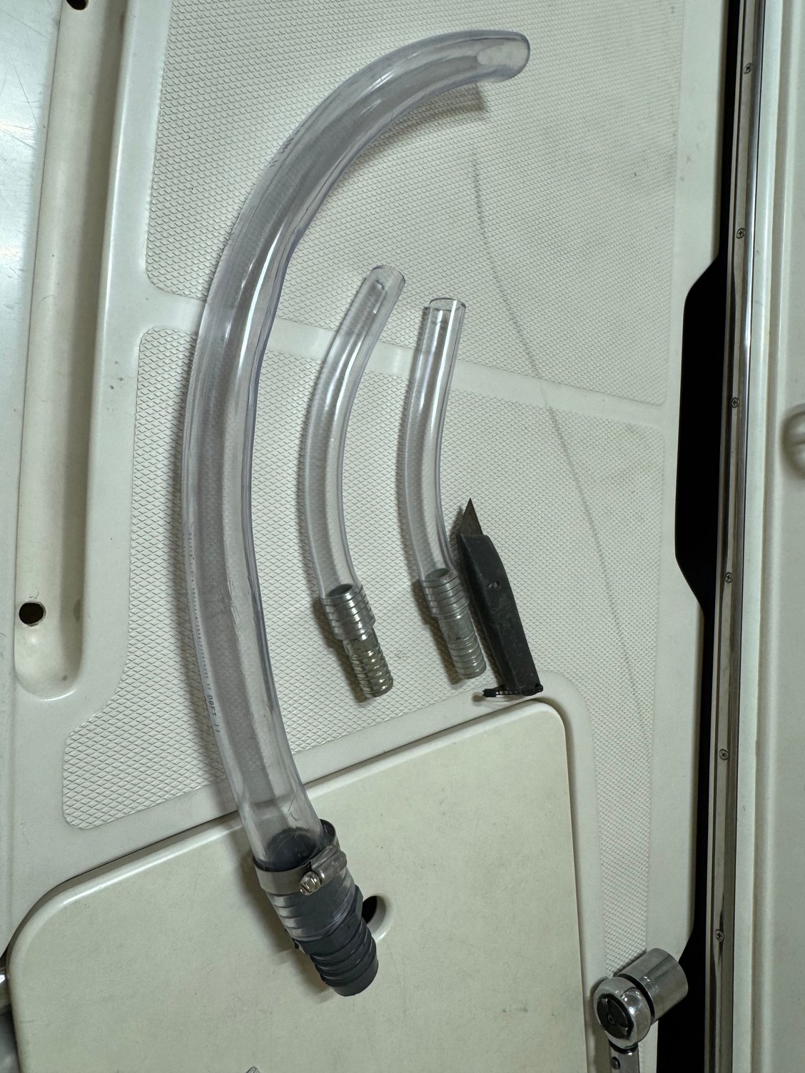

Clear hoses in place for intake air leak and head gasket leak bubbles test.

PROBLEM DIAGNOSED!!!
Head gasket leak. I was fooled by a cold engine compression and leak down tests that looked perfect. Clear vinyl hose test should have been my first test, but since leak down is supposed to be confirmatory I jumped straight to that. Good grief. It’s what I least wanted it to be. Now to figure out which head by attempting leak down on warm motor.
Pressure hose from raw pump on left, water out from block and heads on right.
