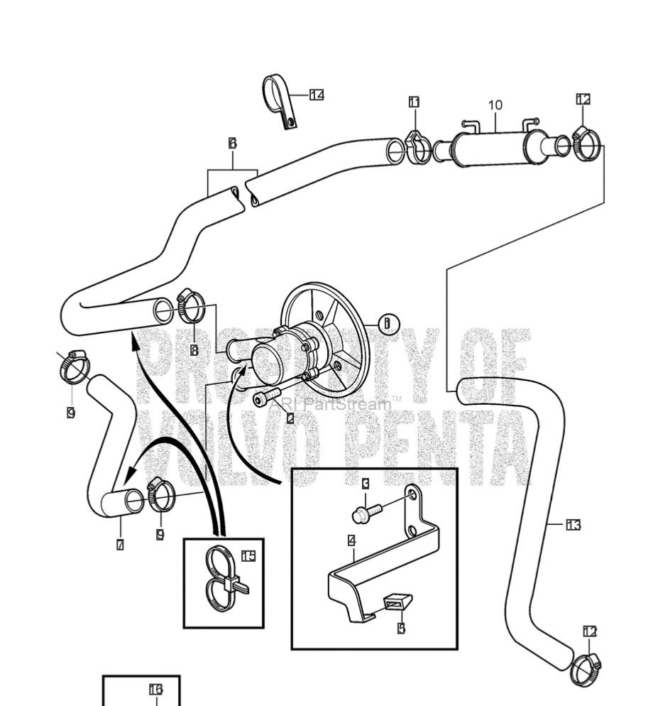

The hose from the outdrive to the seapump could possibly be collapsing under suction from the sea pump. The first thing I would do is hook up a mechanical water pressure gauge, either permanent, or at least temporary. Don't know a lot about what data you can see with a scanner hooked up on your engine, but you may be able to see water pressure as well.

No water pressure sensor or gauge on this one. I can probably hook up a temporary one inline. I thought about mounting a GoPro back there to watch that hose. Wish they put a stainless steel spring inside or a stiffer hose. What did your friend do? Just replace the hose?
