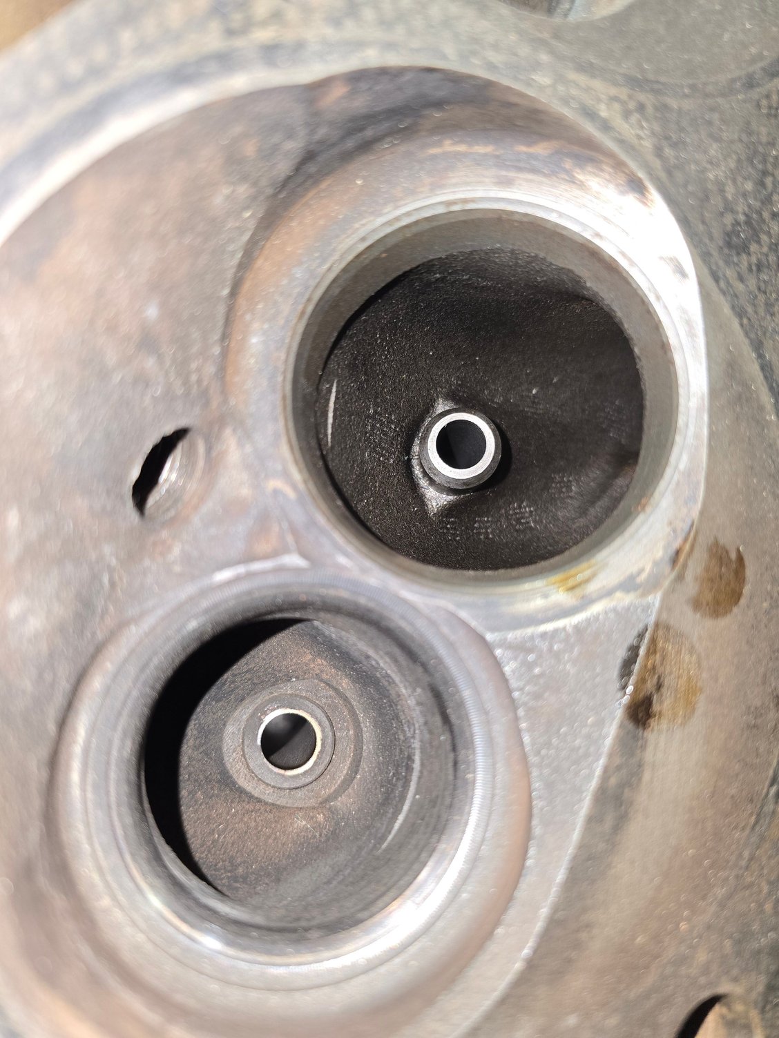

TThse are my stock 088 heads with 25 hrs of use. They just hogged in, then put a seat in for the intake valve. No venrturi under the valve. This really hurts flow. Aluminum, you could weld it up and shape it. Iron...all you can do is put 2.300 valves in and see if the throat is small enough at 90%.
But the 088 heads will flow with some cam and rpm. You should have inconel exh valves as well...if stock.
Let us know how it runs when you get it wet.
