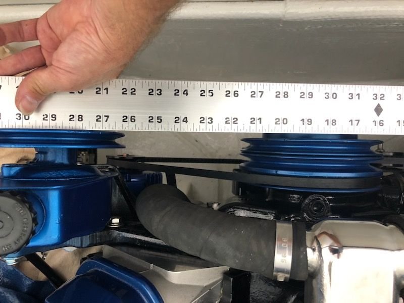

Been slowly getting the engine back together and have this problem I cannot figure out how to correct.
New OEM engine block with new Promaxx aluminum heads. OEM brackets and power steering pump.
Sea water/fuel pump alignment looks great.
Power steering and alt appear to be almost 1/4" too far forward. If they were too far back, I could use washers and move the bracket forward. Not sure what to do to move it back?

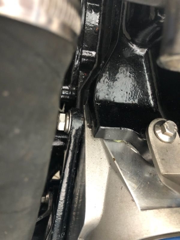

I'm kind of thinking the Promaxx head is a bit too long. In the pic you can see the head sticks out more than the intake manifold (even side cylinder head sits about flush with the intake manifold) and even a little bit past the engine block.

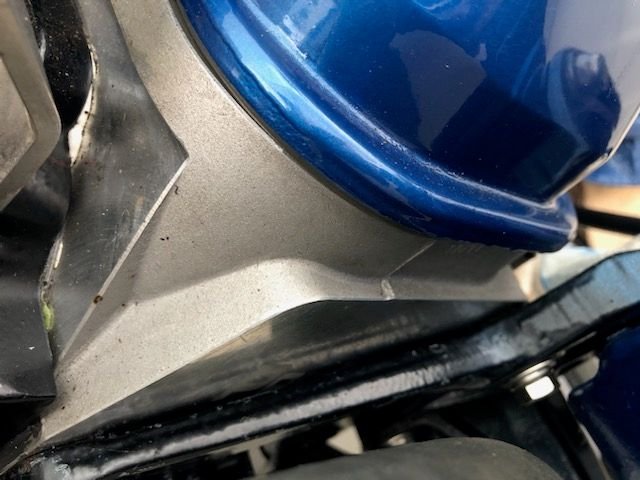

I know I can shave a little off the "bosses" (raised up area around the mounting bolts acting as stand offs) of the bracket to bring them closer, but not a 1/4"
Please let me know if I'm missing something here. Thank you
Sea Pump side. See how it finishes about even with the intake manifold?

These are what  Im talking about shaving down a little.
These are what I'm talking about shaving down a little.
power steering side sticking out past the intake manifold and the block.

Do the water pumps pulleys line up with the crank ok ? Hard to tell from your picture.
Water pump pully appears to be spot on with the crank. The sea pump appears to be fine also.
Thanks for the comments guys. I'll get some more pics for you soon.

How does the water pump pulley line up with the crank pulley?
