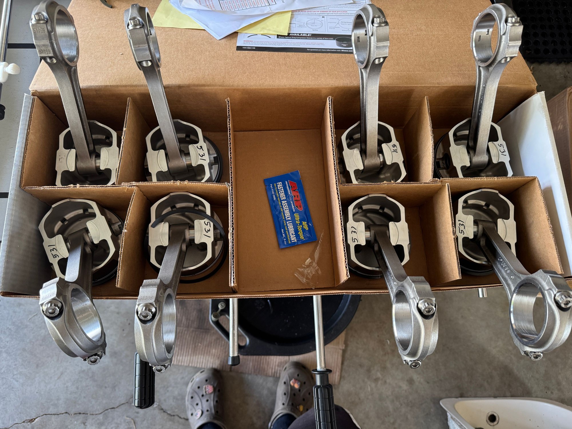

Block is back from machine shop. Bored 30 over, cleaned, crank polished, did not recommend cam bearing change said “they look like new”. Decked 2 thousands.
New Wiseco Forged pistons and New Scat forged rods. Balanced and gapped.
I assembled the pistons and rods. Broke one 2nd groove ring. Waiting till Monday until wish opens to hopefully get the one ring. Anyone have an extra set for one piston?

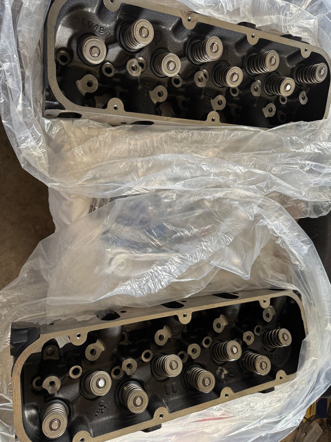

New GM cast iron heads sent to Machine Shop and moved over the old with new keepers and 4 new intakes and 1 new exhaust valve.

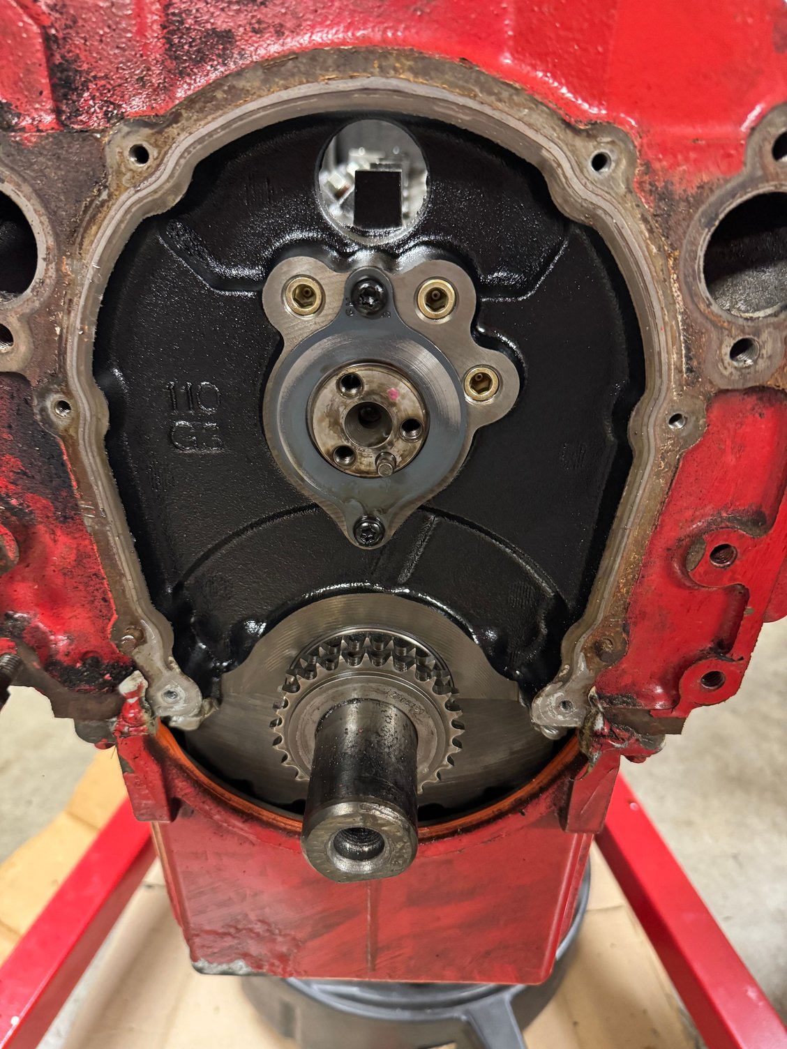

Have a couple questions, the 3 plugs in front above the cam, had holes in them. Anyone have a source for these? Or can I get some iron plugs from the hardware store and drill a 1/16” hole and be good? Below is what it had that machine shop did not return. Most of the plugs were destroyed to remove.

Yes you can use iron plugs and drill them, but I would use brass, a little easier to drill and easier to go into the holes. I have seen 1 of the plugs drilled but not all three.

There should be some allen style pipe threaded plugs available locally. Easiest would be to drill and tap a piece of metal and screw them in...to drill them in a drill press. Or in a vice pinched with 2 pieces of wood and a hand drill. Small drill bits break easily. You need high speed rpm.
I don't remember the hole size to drill...but should be ok here somewhere. I would do all 3...as per the original block.

I don't know for certain on a Volvo, but on a Mercury 496/8.1 they do have 2 oil bypass valves from the factory. The one in the center, and the one off center are utilized on a Merc. Be sure to use GM part number 25161284 as this is the 30psi valve.

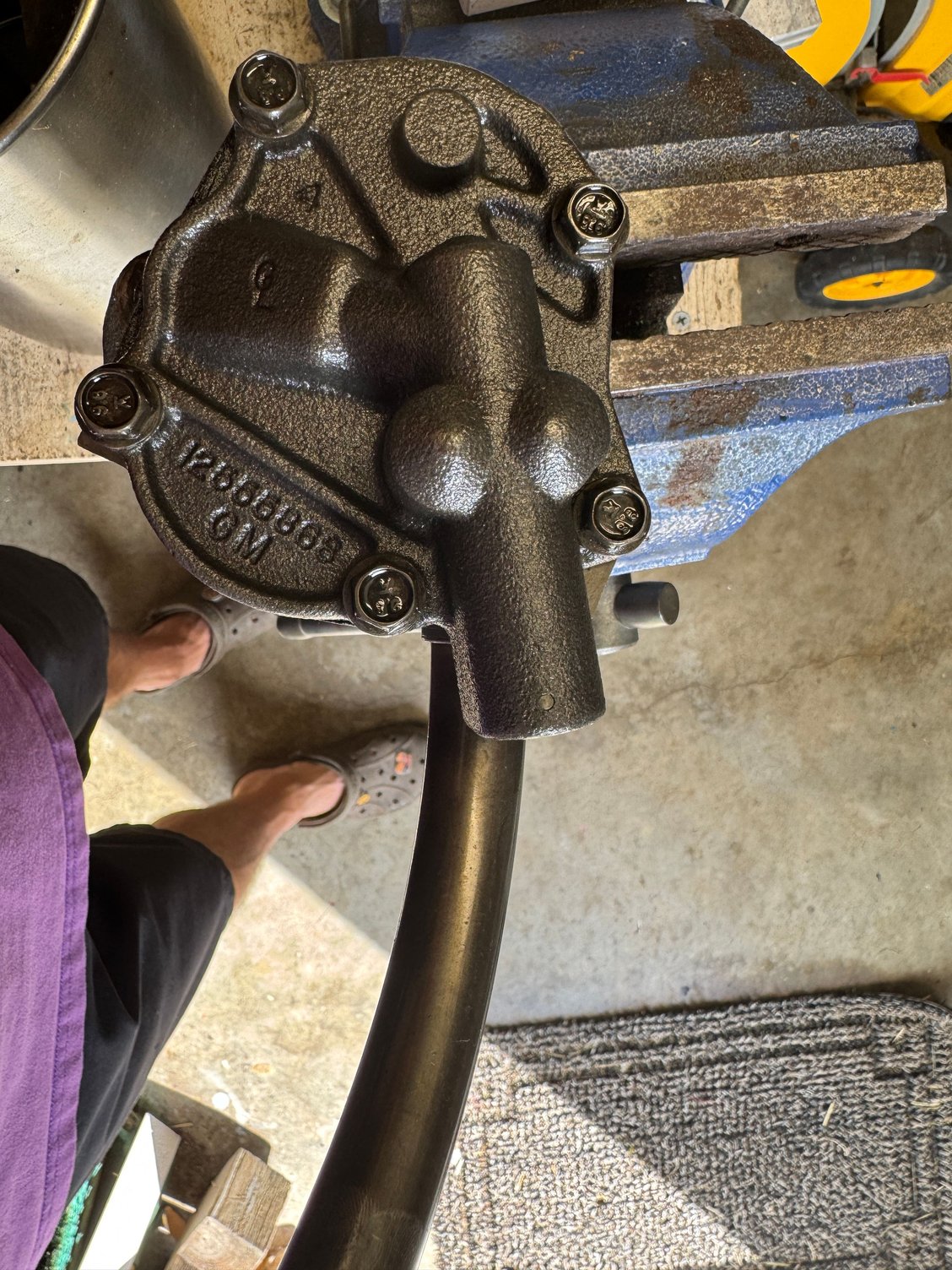

Oil Pump:

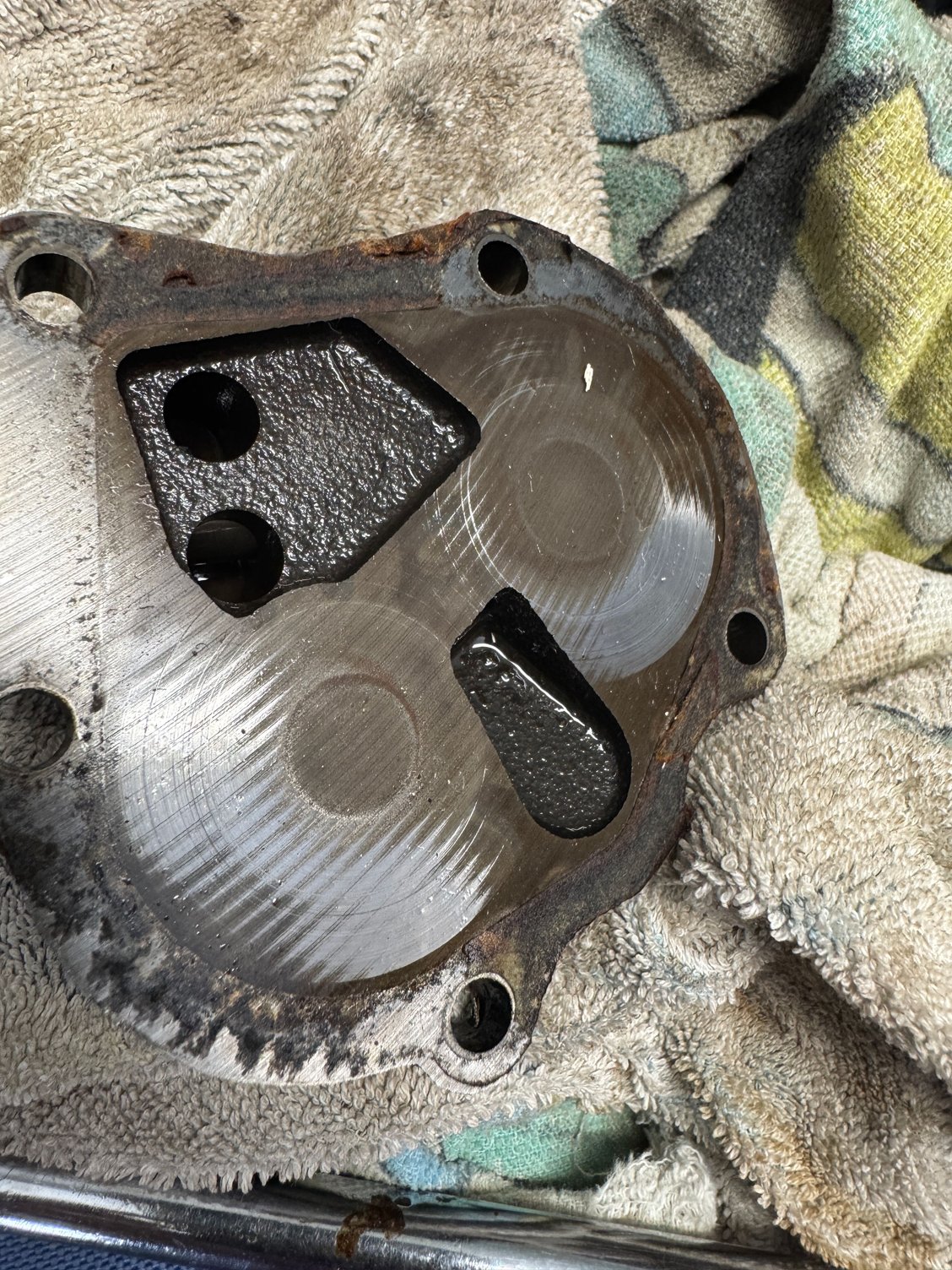

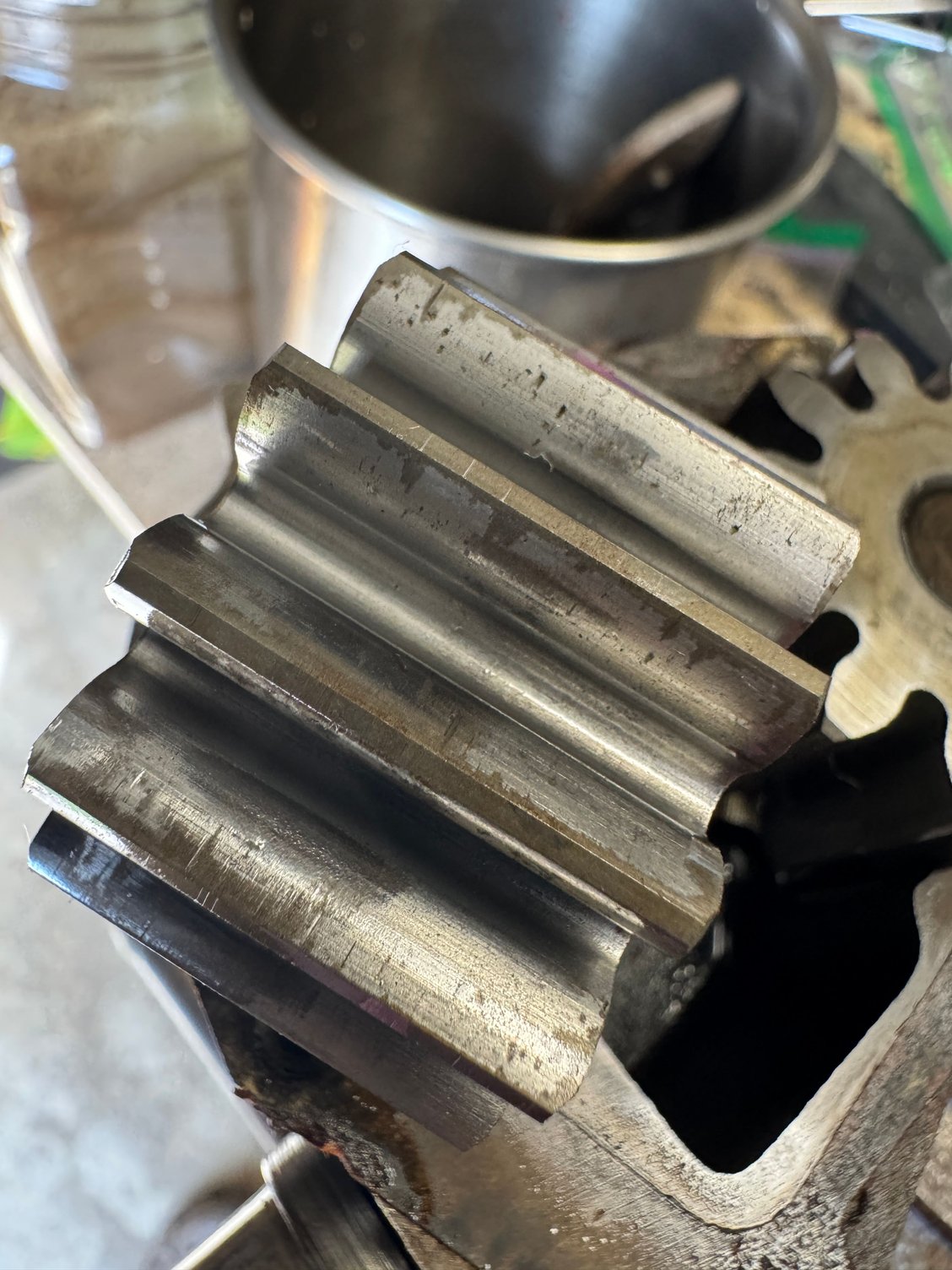

Opened the oil pump. Held down with five 10mm bolts. The cap had a paper like gasket requiring a light tap with a ball pin hammer to separate. The inside of the cap had some scoring above both gears which my nail could catch on. Also, the the gears had many scoring marks which my nail could catch on along with some pitting or tiny pits. Will order a new oil pump.
For the sake of getting this project done, I contemplated not opening this up thinking it should be ok since I never saw any oil pressure issues. Since I have plenty of time, waiting on parts, and working on other small projects on the boat, I opened it up. Glad I did. Question is, do I stick to the stock oil pump, or upgrade to the higher volume pump. Is there any downside to the high volume pump in an essentially stock engine. Yes its a marine engine that operates at a much higher load consistently vs in an "over the road" application. Is that enough to upgrade? Undecided on this topic and will research other sources. I'm leaning more toward a stock GM pump.
Oil Pump part number: 12555868

Are there any downsides to a high volume. From my short "google university" search, not required for essentially stock engine. The high volume oil pump also takes MORE power to run and there is some potential for the oil pump shaft to shear??
Looking for AC Delco or GM unless there is another Brand (Melling?) thats is more recommended.
