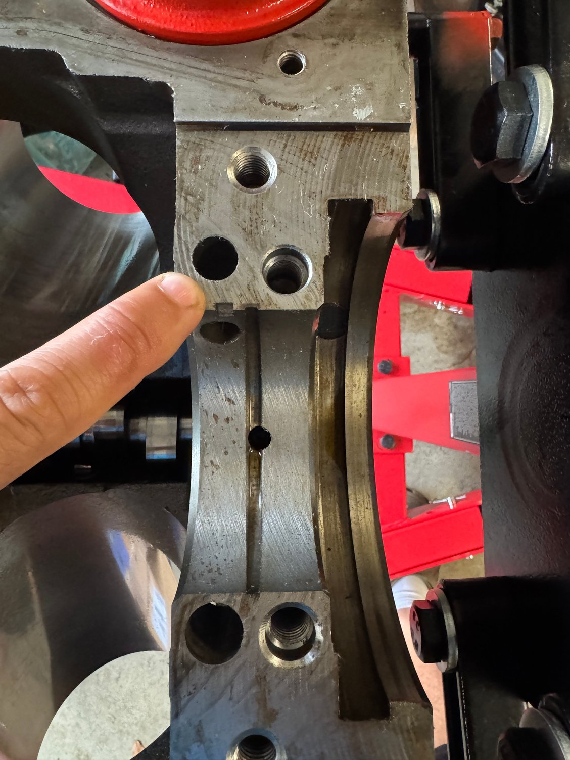

Double checking there isn’t an o ring or gasket for the oil passage on the rear cap to block joint.

can you post a pic of the rear main cap
lmannyr is offline

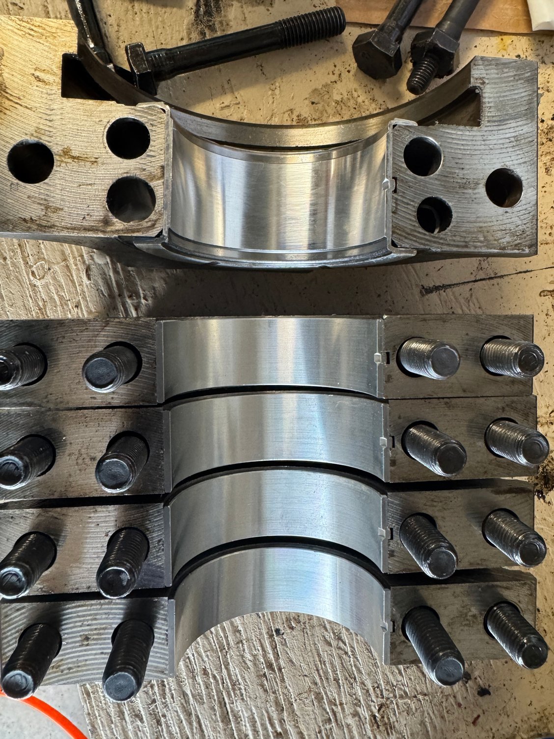

Crankshaft Main Bearing oil clearance.
1- .002
2- .0015
3- .0015
4- .0014
5- .0019
All within spec

How did you measure the main bearing clearances? Very tight for a marine BBC.
1- .002
2- .0015
3- .0015
4- .0014
5- .0019
All within spec
That's spec? Seems tight to me, my rods aren't that tight.
I thought at least 0.001"/in

In another life I built a lot of engines. Sometime in the beginning had a problem with one in particular that was eating main bearings. After a couple of failures I finally figured out that the machine shop I was using at the time didn't know wtf they were doing. They managed to align hone the blocks so they were small at roughly 60 deg before & after vertical. Wasn't until I had my own align hone that I saw how easy it was for that to happen. Had never run into it before, always just measured vertically. That was a real wakeup.
So - here is what I came up with - all measurements with a dial bore gauge that can read tenths, same with the mike. Measure journal in 3 places (find smallest dimension) Record all and take an average.
Measure crank in at least 3 places, check for taper, out of round. On an engine with some hours on it this is somewhat normal. Record largest & smallest dimension and take an average.
Subtract largest crank measurement from smallest journal measurement. This is the one that will get you in trouble the fastest. Actually printed out a form and kept it each engines file.
