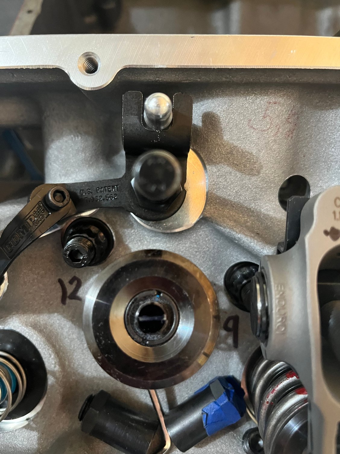

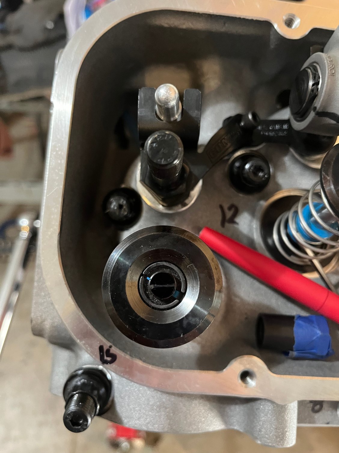

Update: So these promaxx heads needs some more work, ie longer rocker studs.
So I got a couple lengths of those, and then also got the 0.090” and the 0.050” backset rockers.
In conclusion, on my exhaust valve a longer stud and a 0.050” backset on gave a great, repeatable pattern that is fairly close to center. Estimated witness mark width is 5/128”. On my intake, the 0.090” backset gave a great repeatable again fairly close to center pattern. Estimated width is 7/128”.
Exhaust
Exhaust
Intake
Intake
Thank you to everyone for their input to get this near perfect!

That is as good as it will ever get.

Great work. Thank you for getting a good detailed solution and photos.
