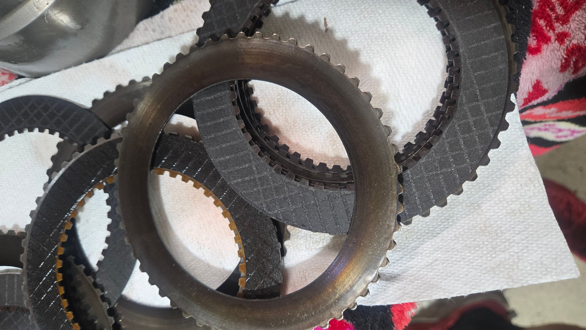

I have 2 transmissions rebuilt by Bam in 2020. Probably 100 hrs on em now.
One puked all the oil out the front seal, clutches still looked okay.
I replaced all the clutches, seals, steels and o rings.
Put it all back together , it pukes all the oil out the front seal again , in neutral at idle
WTF is going on , any ideas??
I did not replace the shaft metal seals since everything looked fine in there , figured they were fine.. fyi

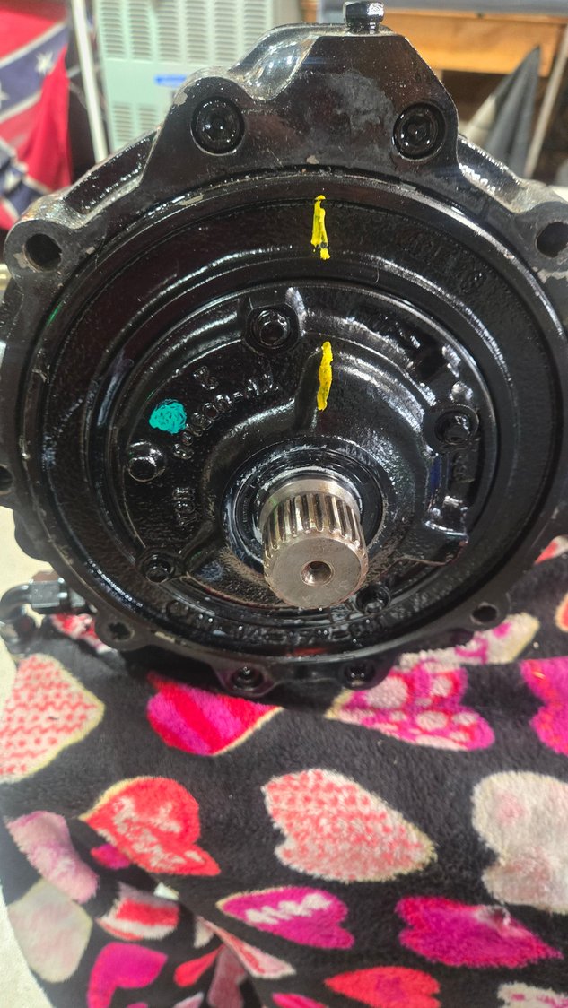

The seal blew out ..thats my problem. I have found a metal rim seal insted of these rubber deals that suck.
These have 11 clutches. Can`t fit anymore in there unless you got LV
On the heavy Cig I had a bam 1200 or something .. it is the only thing that never broke, except for the new owner, if that held up for 12 years on that old heavy cig these 1300 should be able to handle the cat.
I`ll use locktite on this seal.

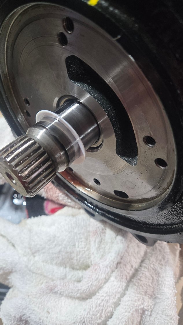

I also have 2 diferent pumps, the Bam one has a groove that leads to the seal area , not sure why or if thats a mod Marc does. The other does not .

Like in your facebook post, a few mentioned you can drill and tap, and then "faceplate" a custom aluminum washer on the outside of that seal, all mine now have that. Was trying to find a picture for you but I don't have one. I'll try to text you pic later.
I would suggest getting with someone who knows these trans / upgrades to save you time in the long run. These quick fixes will rear their ugly head down the road (loctite, metal seals, etc). I think what you have are probably good for 800-900 ft lbs.
You probably had some unicorn transmissions in the Cig!
Looks like some crap went through it. Change the pump, machine the reverse adapter, ultrasonic the oil cooler. Flushing won't do it. Once there is too much clearance in the pump and reverse adapter they will develop pressure behind the seal. Retainer can't hurt but that only solves the symptom, not the cause. Next thing is they will build enough pressure to blow the lip on the seal out even though the seal stays in place.
Vibration from a drive plate problem or drive/driveshaft mis-alignment also plays hell with the pumps.
Do you have the serial number of the transmission?
11 plates is the max for any of the classic 72 series. Have to move up to an LHP (Merc QV4 style) for more. We can get 22 clutches in one of those.
As far as delivery we are currently running 1-3 weeks. Depends on what we have going on.
The deep sump is not so much about adding thermal and fluid capacity, What is does is assure a steady fluid supply and gets the fluid away from the rotating drum which in turn cuts drag and lowers the temp. We highly recommend the deep sump for anything turning over 5500 RPM.
