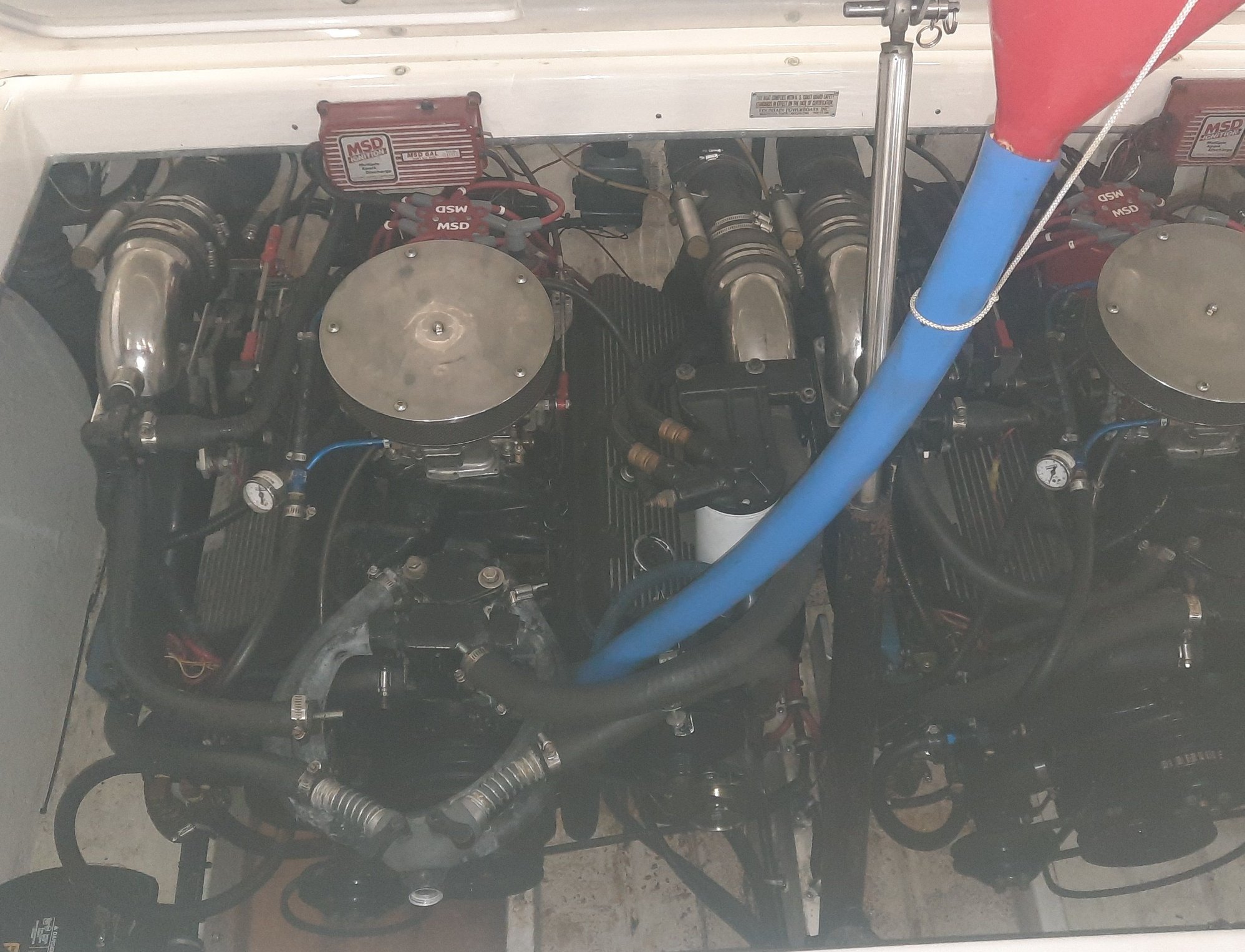

Got the treatment (Thermocure) into the eng and up to 160 degs before shutting off. Went pretty smooth except It did burp on me and made a small mess.
For the exhaust cooling hoses, plugged the hoses for the exhaust elbows. Used a garden hose Y adapter for exh manifold water hoses. The hoses fit right over the garden hose Y adapter threads and used the orig hose clamps to secured them.
Plan is to start the eng a few more times this week and drain/flush next weekend.

Got the rust treatment flushed out. It was definitely dark brown but not black like some online videos showed. Looking thru the hole on the intake for the thermostat housing, I can see there's a little bit of rust still in there but does look like it took most of it out.
With the thermostat housing, I coated it with Ospho inside and out. All the surface rust turned black and if you wipe it with a rag, nothing comes out on the rag. I'll see what it looks like next season.
Didn't put Ospho into the block. Wasn't able to find much info abt that. One commenter claimed it would block heat transfer to the water??
