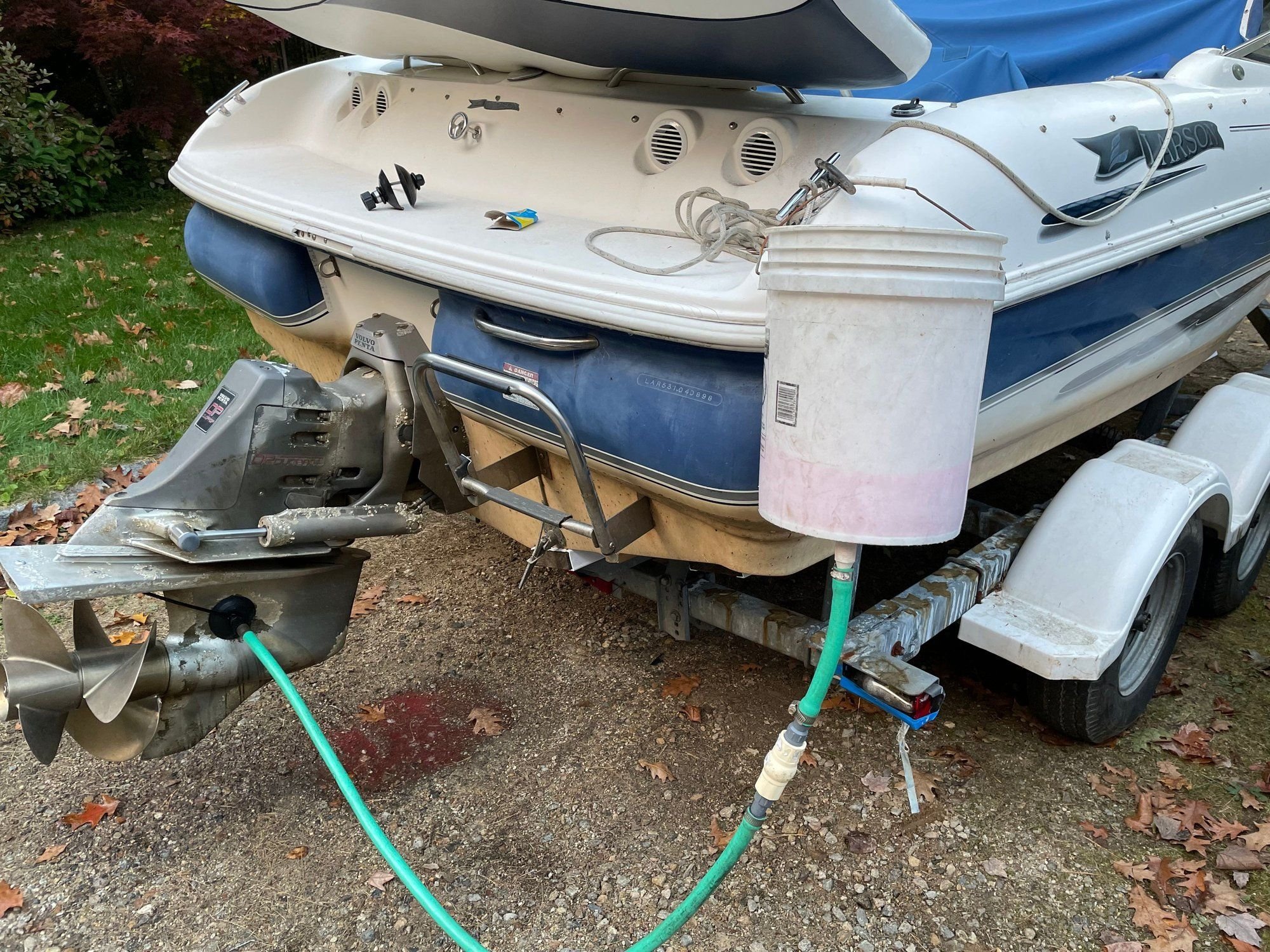

Maybe doing a set up like this that many of us do to run antifreeze thru motor for winter storage. Here’s mine on a neighbors boat.

Yup, I have a pretty much identical set-up that I use to get the pink anti-freeze into the eng. Looking for method that will allow the treatment to remain inside the eng thru a few heat cycles so it has a chance to work. Something more like what a car (or any closed loop sys) would experience since the stuff is really made for cars/trucks.
