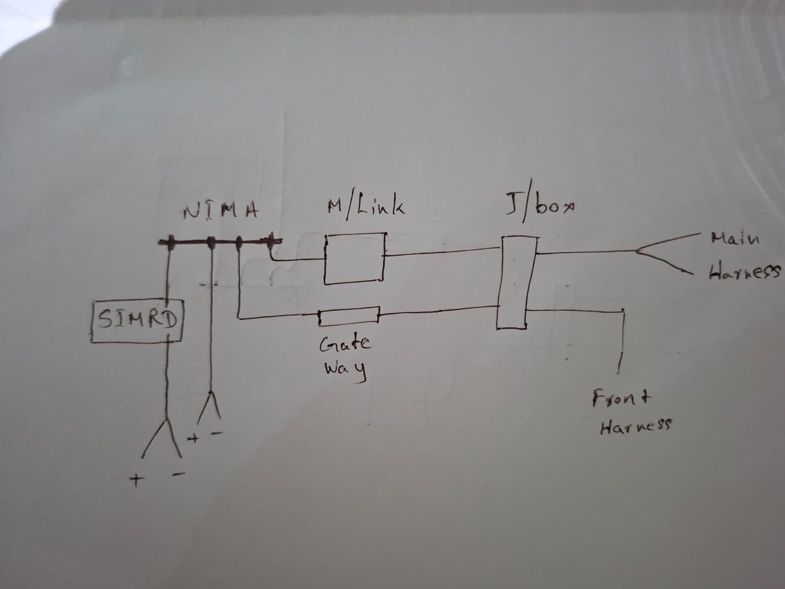

Old 10-15-2025 | 09:19 AM
Joined: Jan 2012
Posts: 204
I do not know if that would work for tachs I have attached a drawing how I’ve wired everything to nmea
thanks!

Old 10-15-2025 | 02:14 PM
Joined: Jun 2020
Posts: 523
Likes: 188
From: Holland MI
thanks!
Is that J Box mercrury? They make an adapter harness that plugs into the j box and has analog gauge output wires
Ryanw10 is online now

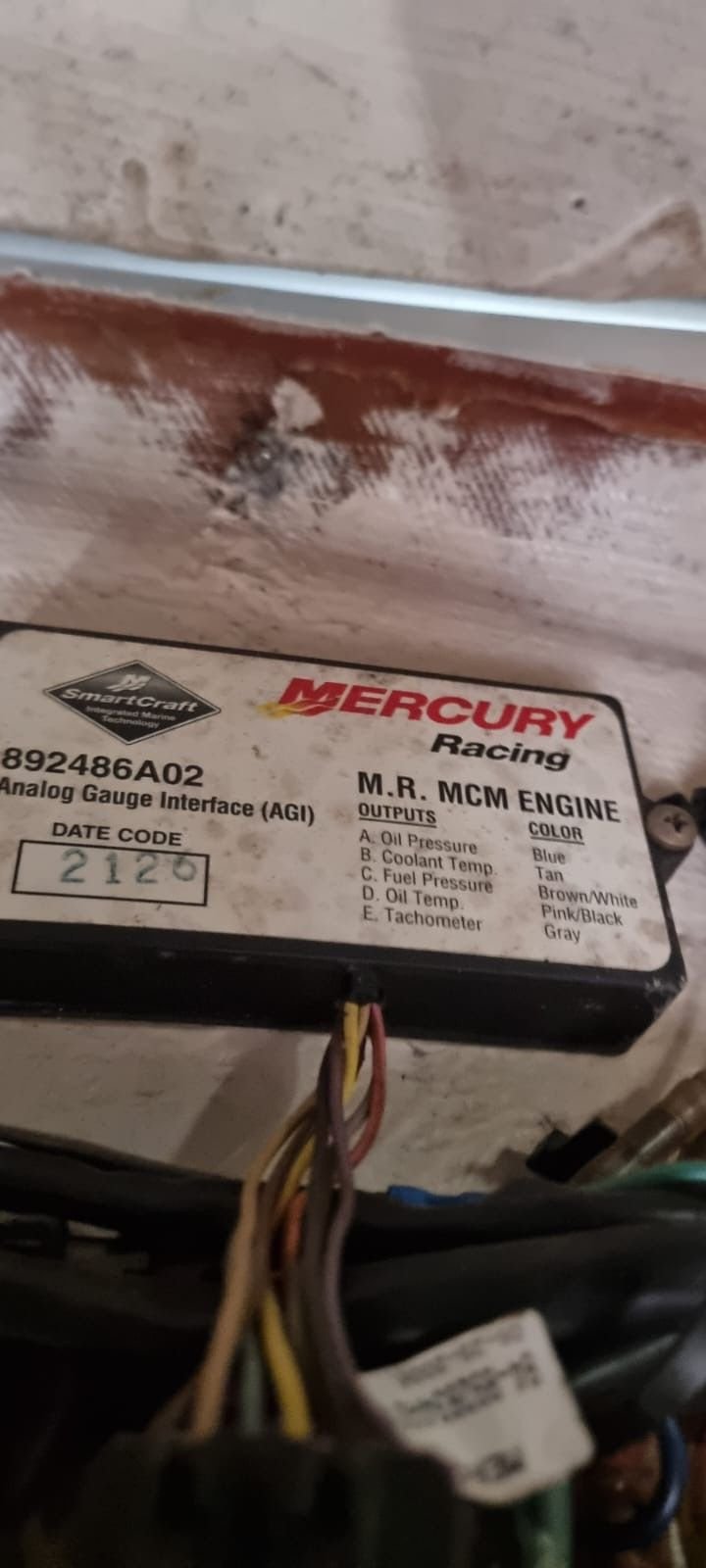

Old 10-17-2025 | 09:43 AM
Joined: Jan 2012
Posts: 204
it is a j box
I believe what you are referring to is the agi? Attached
intimid8 is offline

Old 11-18-2025 | 04:06 AM
Joined: Nov 2025
Posts: 10
Learning
Triage is offline
Old 11-18-2025 | 04:12 AM
Joined: Jun 2020
Posts: 523
Likes: 188
From: Holland MI
This is what I was thinking of, but you may need to run the agi box in addition.
https://www.greatlakesskipper.com/me...BoCHcUQAvD_BwE
