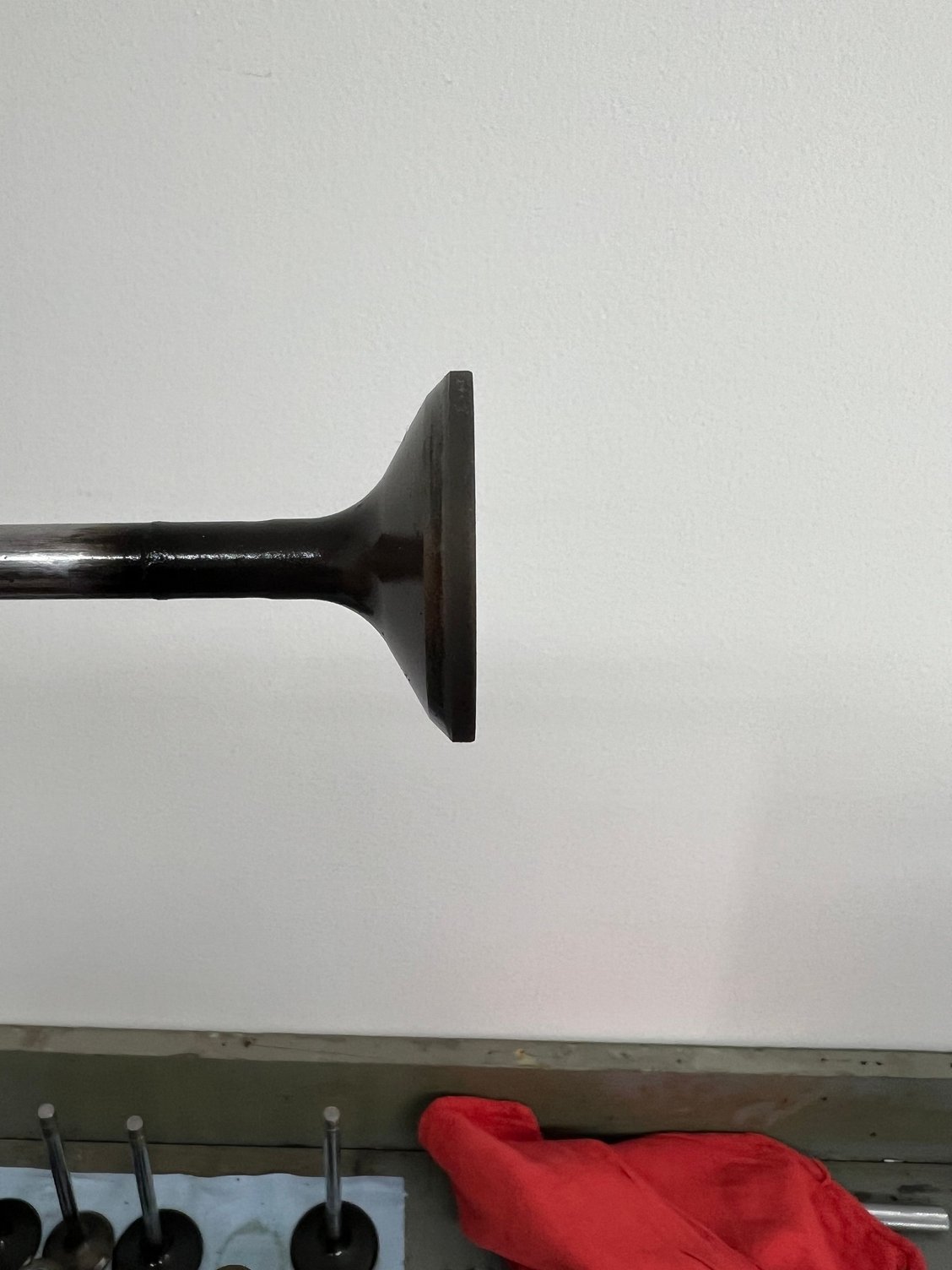

Hard to say how you'll fare without the ski jumps. The help bias the port flow and induce swirl...helping keep the fuel atomized and assist in healthy turbulence. It should increase the cfm a bit.
Have you back cut your intake valves 30°?
Helps with low lift flow..and getting the air moving earlier...allowing it to flow more on the larger valve opening phase.
Larry tells me they are primarily for automotive applications, to improve efficiency at lower RPMs. This engine was OEM designed to spend its life at 1700 RPM. We NEVER run 1700 RPM, other than sweeping through it, getting on or coming off plane.
I didn’t do the valve job. Given the builder primarily does high HP marine engines, I have to assume he did the valves properly for the application. And, to be honest, I haven’t really looked at the valves, as I wouldn’t know what I’m looking for.

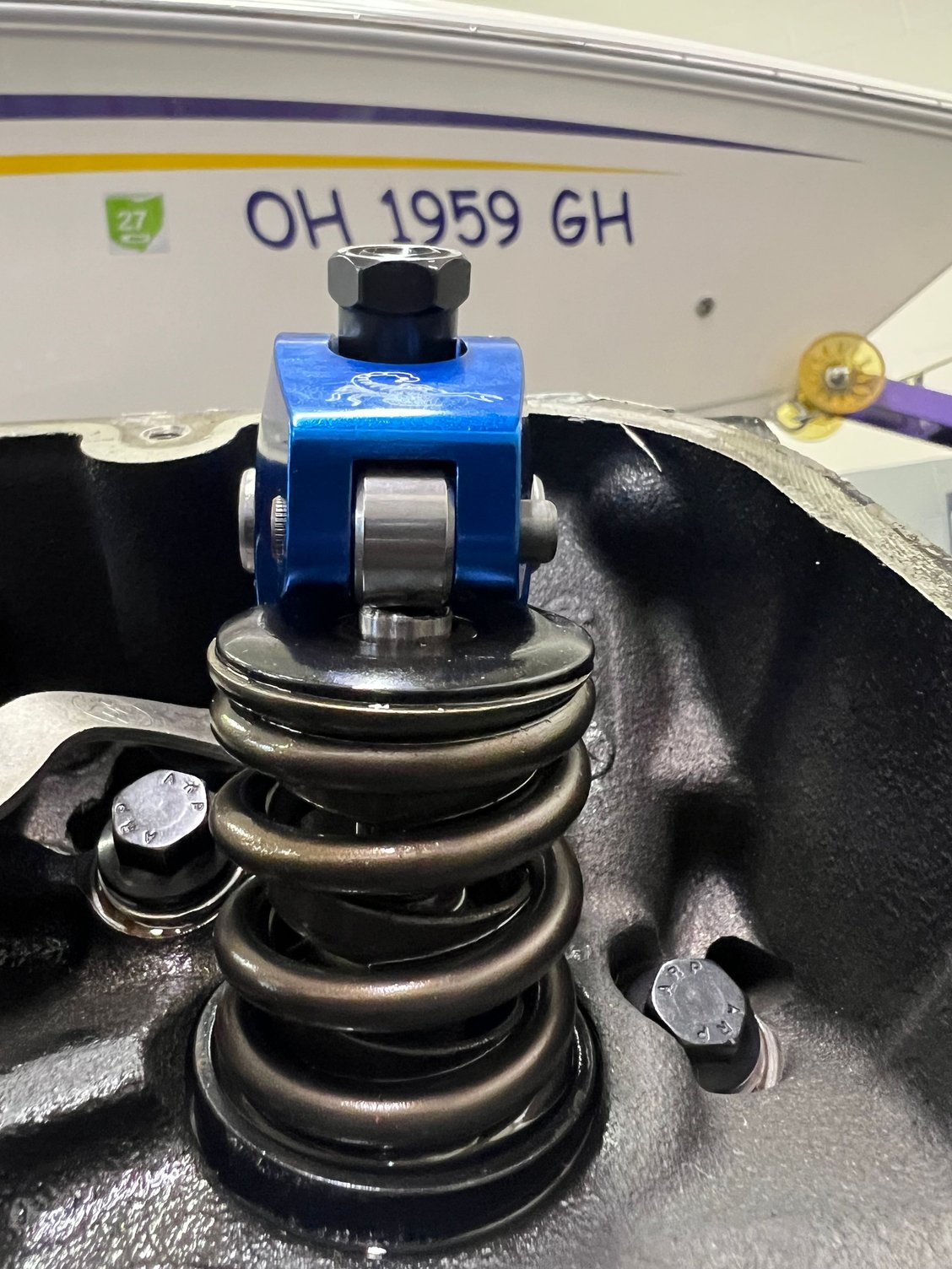

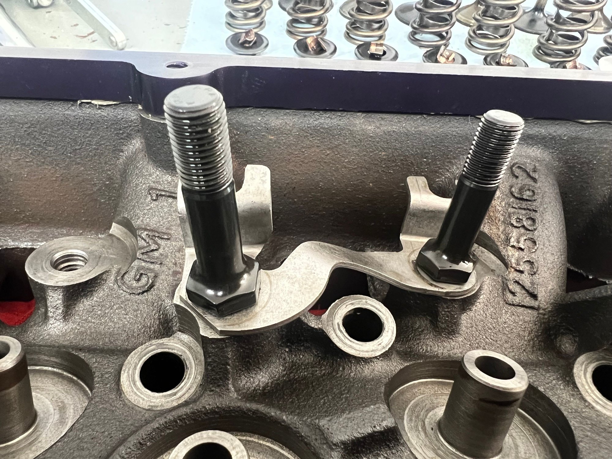

Guys,
Fun fact…. Guide plates are hardened. I wasn’t expecting that. I had to buy a 7/16” carbide reamer to open them up for the new rocker studs. Slow and easy, and lots of MolyDee cutting oil, and they cut like butter. Seemed to hold location pretty well, too.

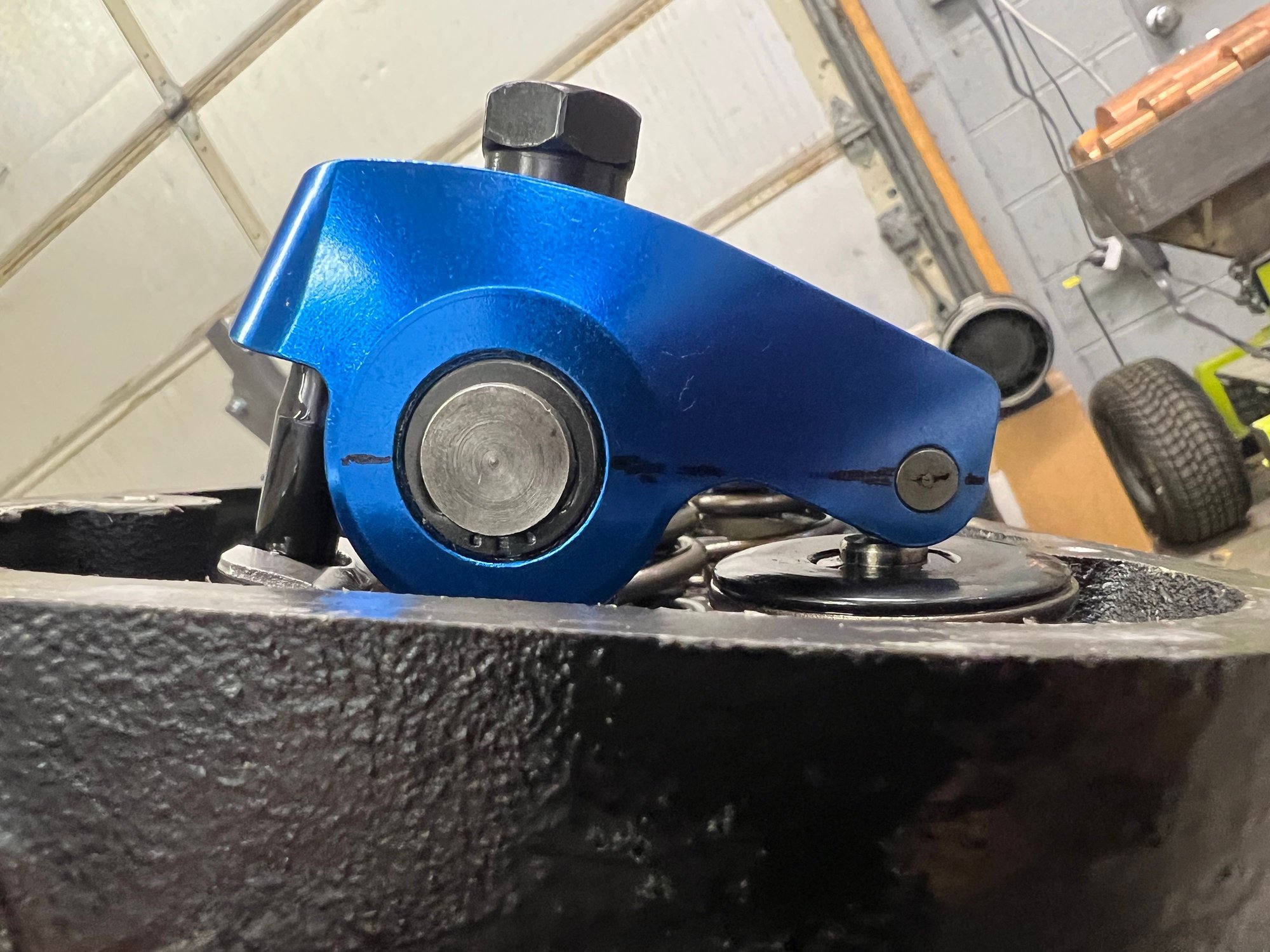

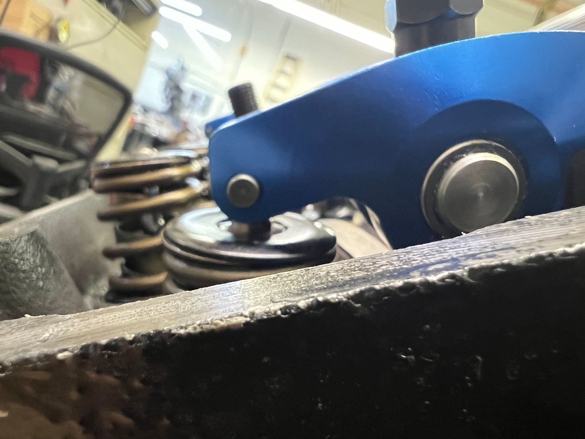

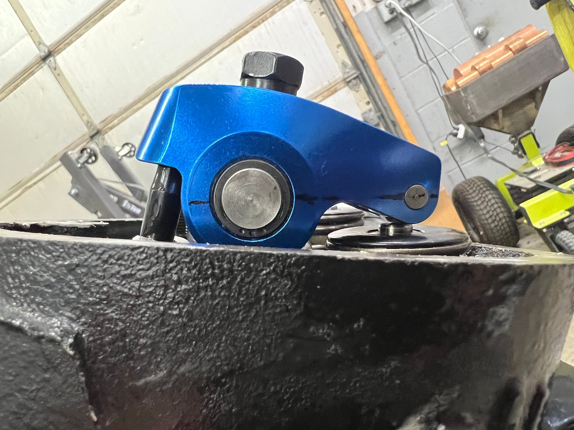

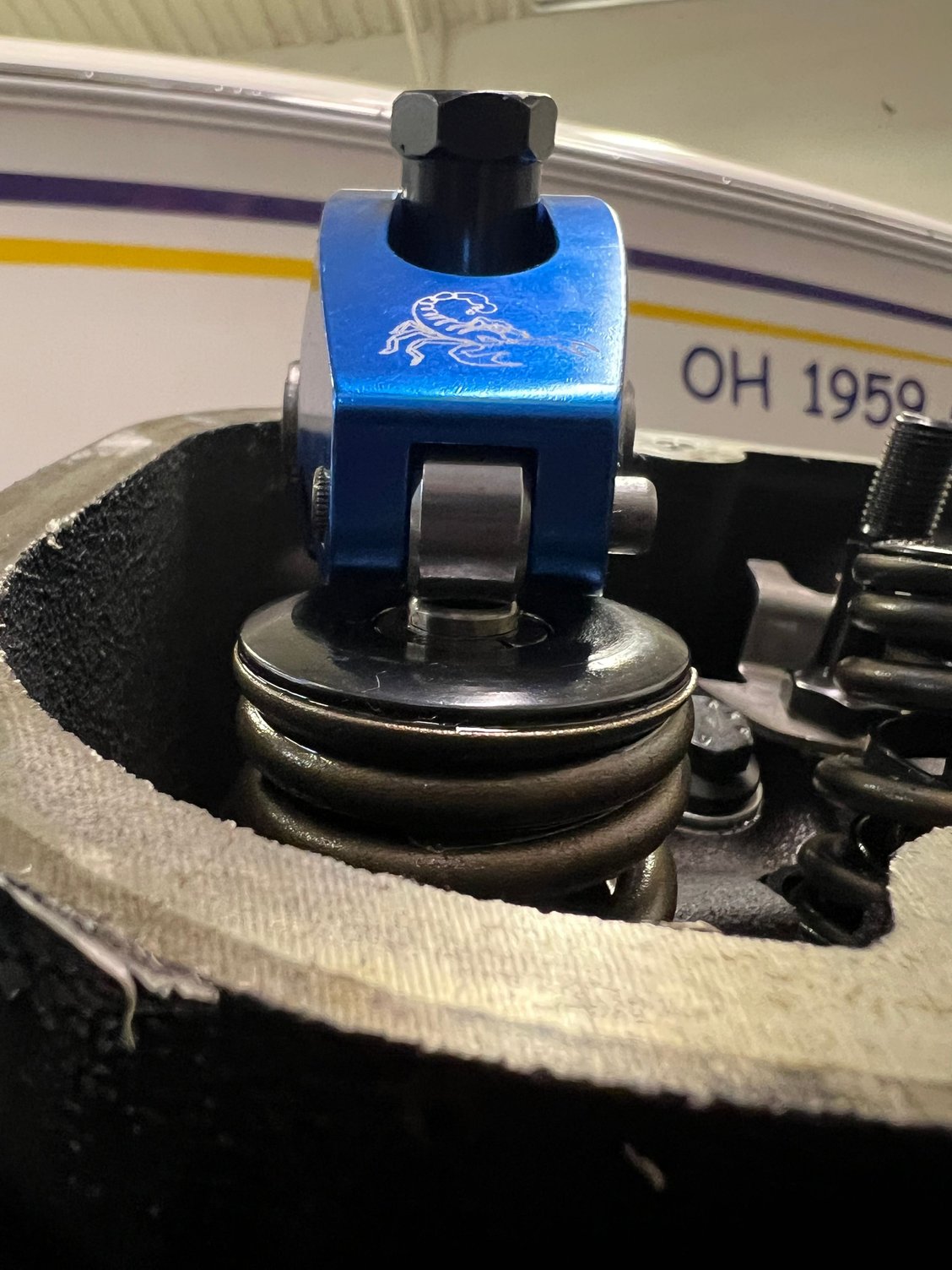

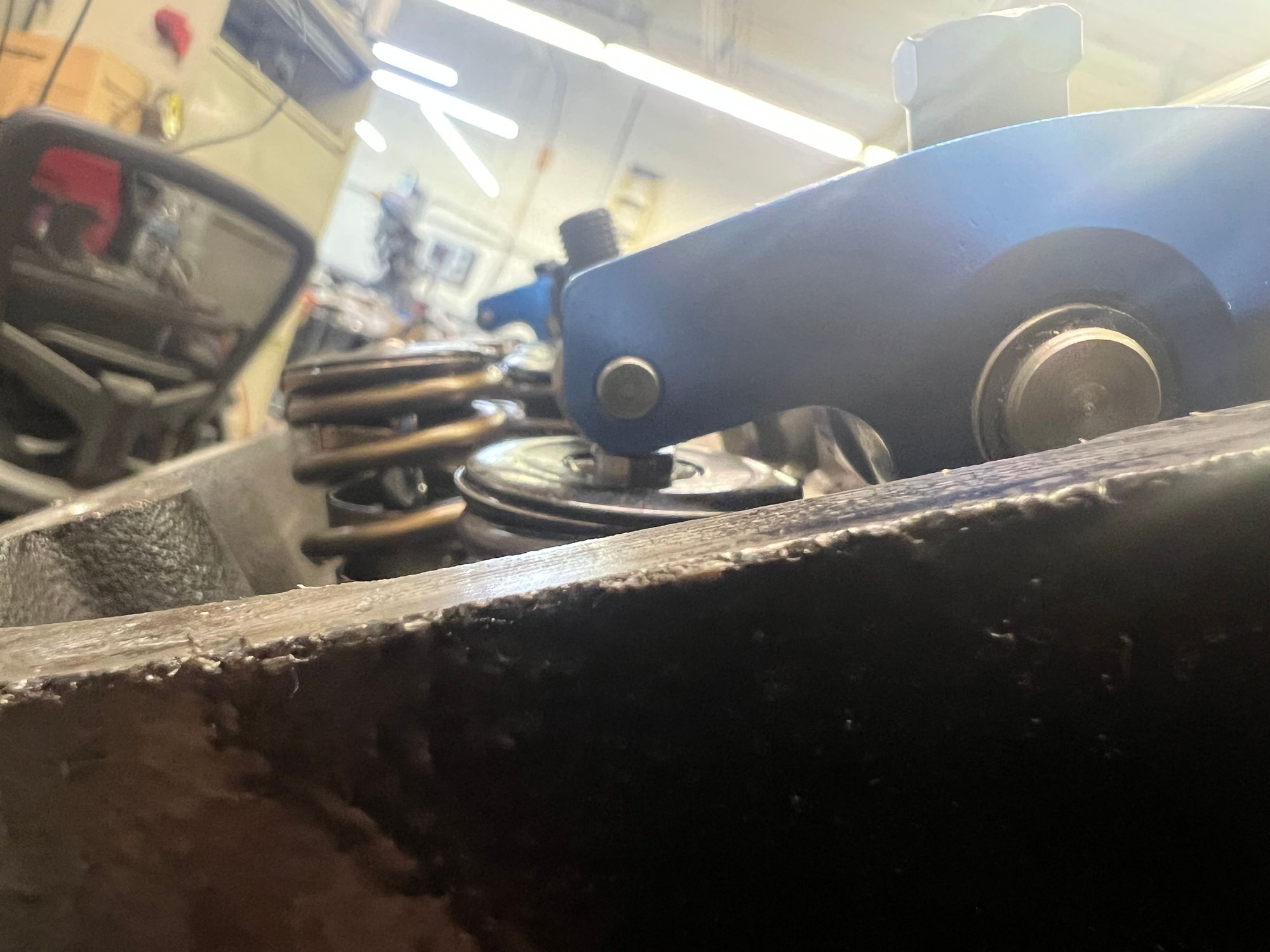

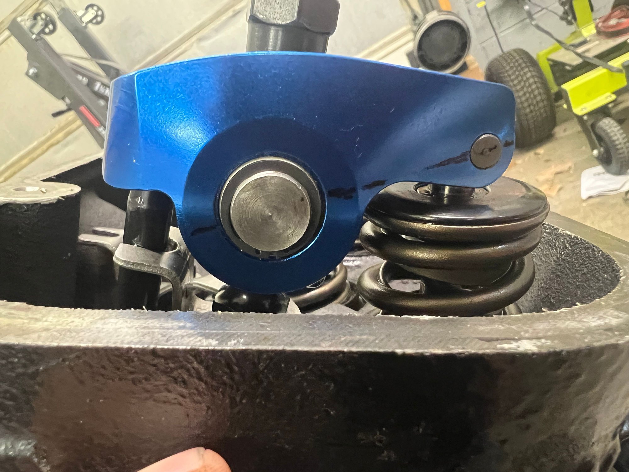

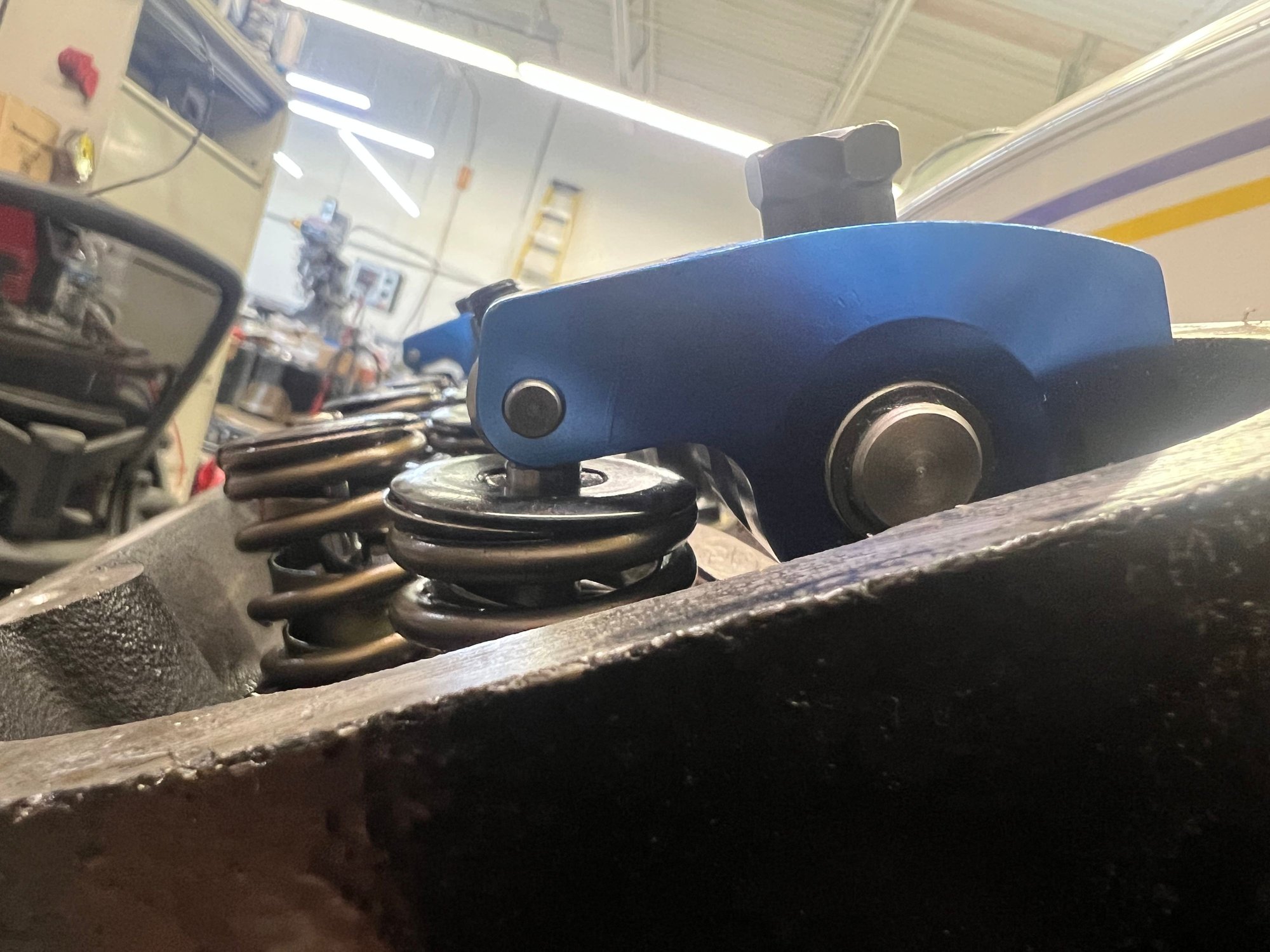

Guys,
Got one head torqued down and did some preliminary rocker sweep checks.
Exhaust
On the base circle
Mid sweep
Full open
Well centered
Intake
On the base circle
Mid sweep
Full open
Well centered
I’m pretty happy with the decision to drill and tap for the larger rocker studs. I’ve got probably double the base thread engagement, probably ten threads of engagement with the rocker nut after preload, and just about perfect rocker geometry, not being perfectly centered on the valve stem tip aside.
Thanks. Brad.
