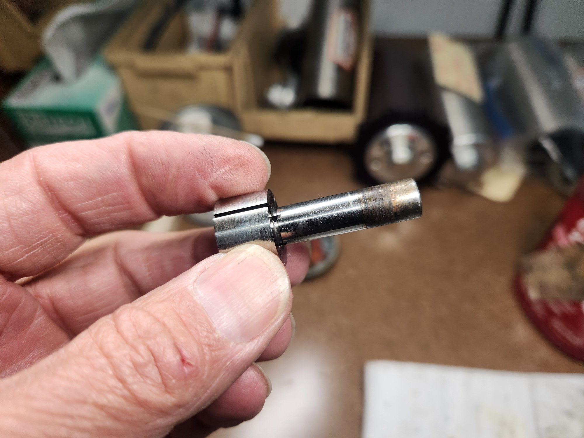

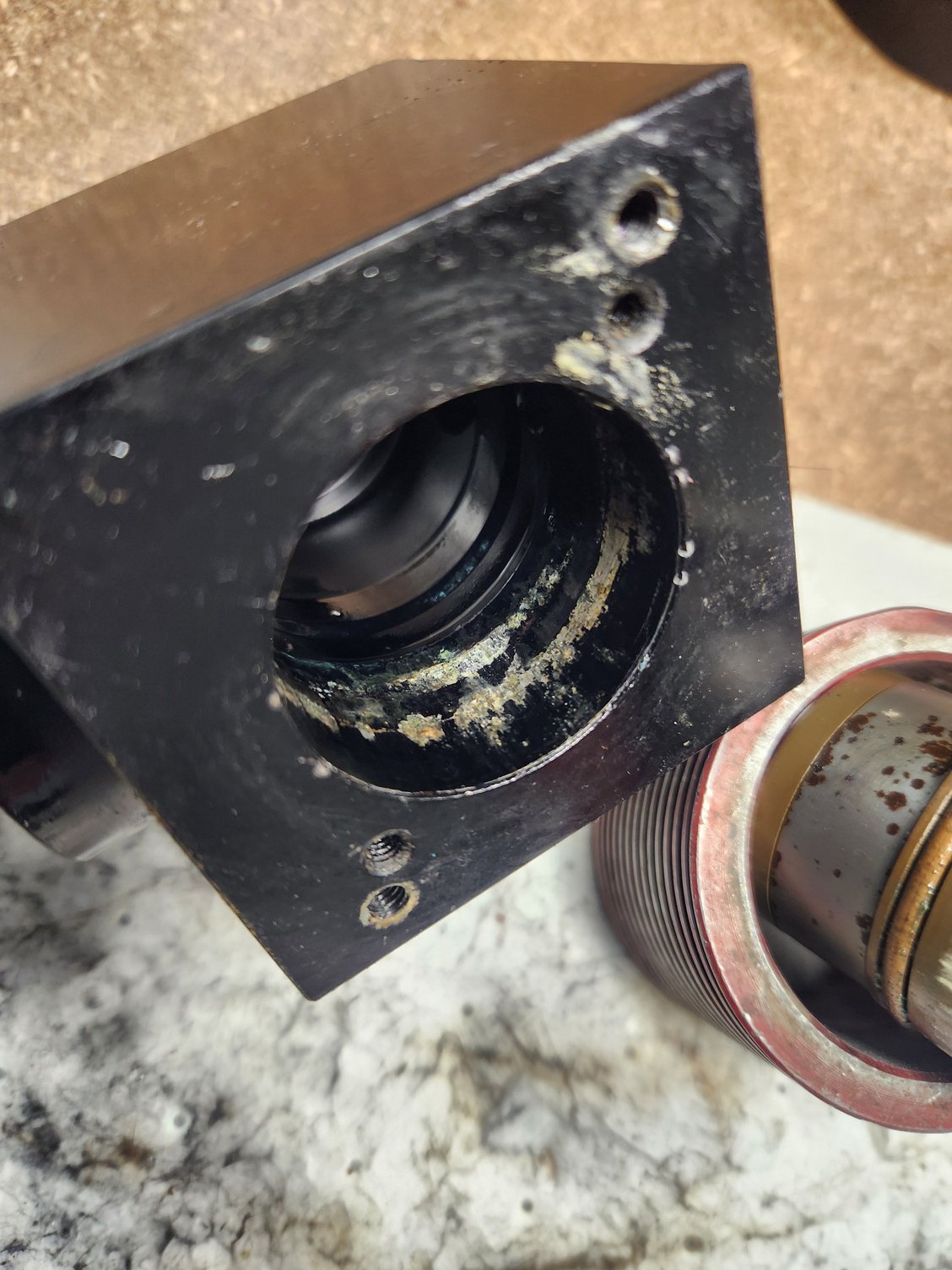

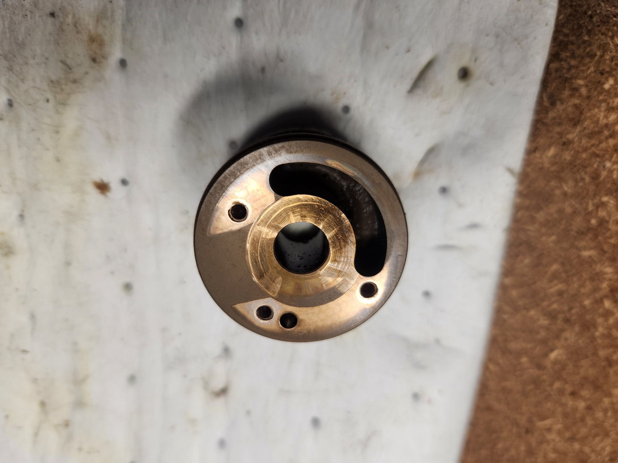

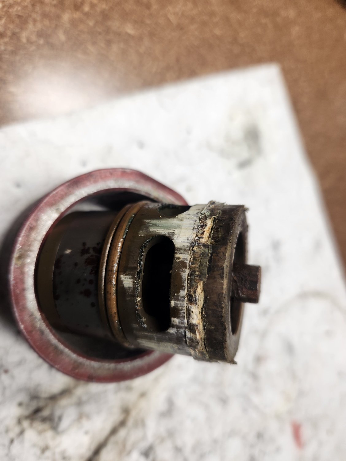

I sent the pump to Weldon to be rebuilt. I got a call from Jim at Weldon this morning. Worse than we thought….
Obvious signs of salt water exposure and being run dry (starved).
He found a really good shape used pump body, and the internals will all be new, plus new motor bearings and he replaced the motor cap with a good used one with considerably longer lead wires. The pump should be like new when I get it back. And all cheaper than a new one, by a good bit. It should be a fair bit quieter, too.
Thanks. Brad.
Thanks. Brad.
I knew it! One of mine was rusty inside. I'm sure he already told you as he did me, to make sure you seal it up in a couple spots when you get it back.

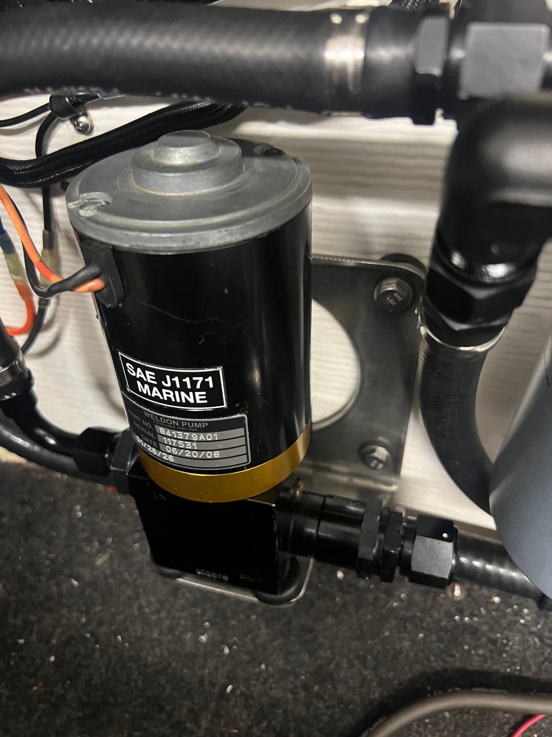

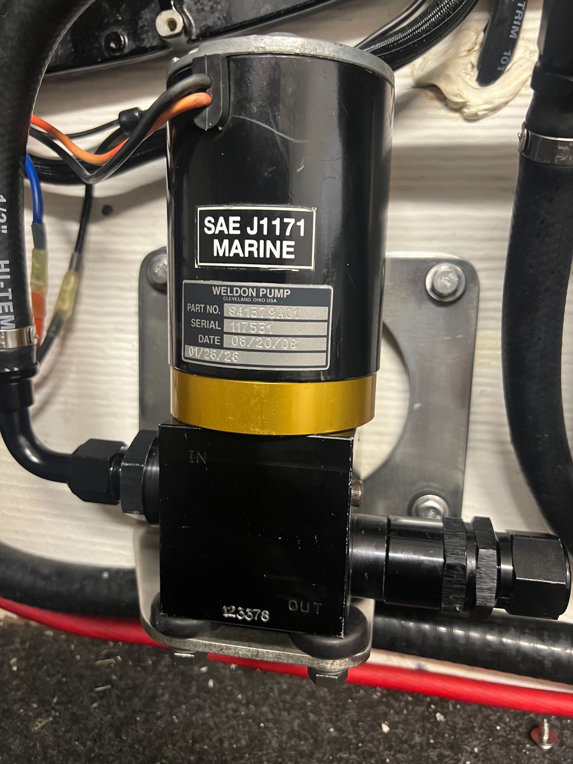

Guys,
Got the pump back today. Looks clean, but just like it’s when I sent it out. No surprises. Now to mount and connect it. I’m thinking I’d like to use a connector for the electrical, instead of hardwiring it. Is this the route to go, or should I just hard wire it?
If so, is this a viable option?
Thanks. Brad.

Guys,
All back together. Freshly rebuilt fuel pump, double rubber grommet mounting. At the very least, I can say the pump won’t be transmitting any noise it might be making to the hull. It’s as quiet as it’s gonna get. I hope it will satisfy the CFO.
Thanks. Brad.
