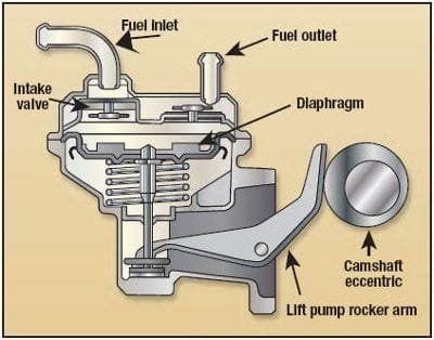

A little update on the mechanical pumps. I spoke to a friend who I consider one of the best performance boat mechanics. The stuff he works on is above my pay grade, so I go to him when I am frustrated and cannot get a straight answer. I also make an appointment to not interrupt his day. "All fuel pumps leak. If they are on the block, they leak into the engine oil. If it is mounted to the sea pump, it leaks into the sea pump oil" "You change your engine oil every few hours or season, it gets rid of the fuel that leaked into it. Change the sea pump oil at least each season or more often if needed. With the pump being mounted down it leaks more. Running the merc pumps, put a drain hole in it to make it easy." "Or go electric. Solves the leaking fuel into the reservoir issue."
For me, I may just run the mechanicals one more year and figure out the electric conversion for next season.
