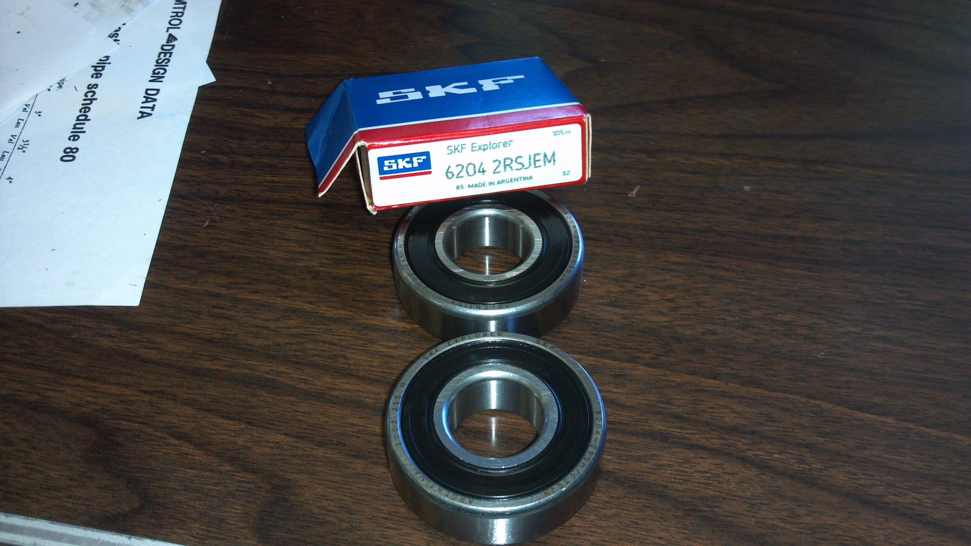

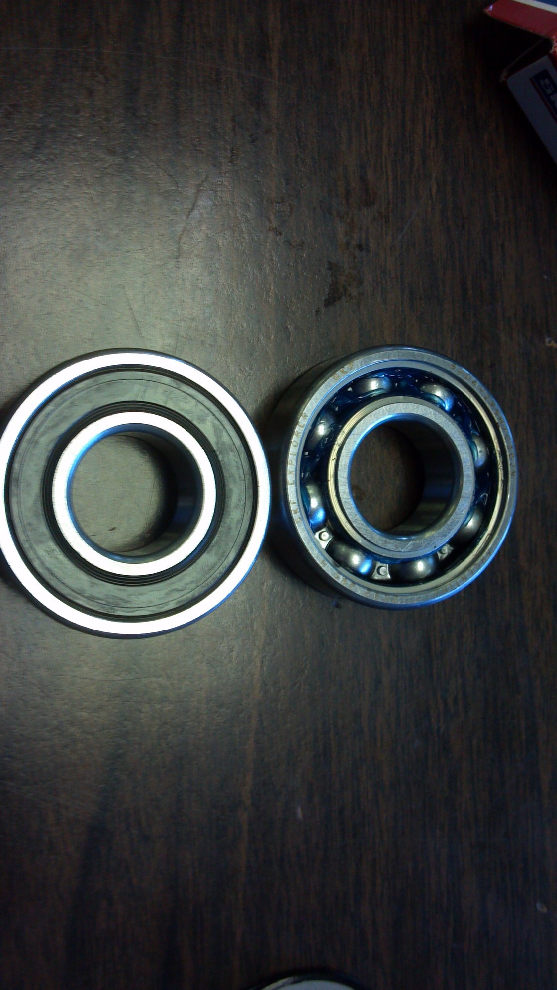

these pumps can be rebuilt. I have done a few with good results. I have changed the bearings out to the 2RS style (double rubber sealed) that way i removed the rubber seal on the inside section of the bearings for oil to get inside and still have another seal on the outside of the bearing to help keep things inside the pump assembly. Sort of a double seal on each end of the shaft.

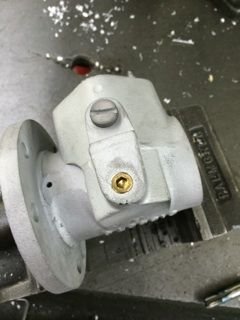

Old style pump
Old style pump
bearings for old style pump
Inner seal taken out

Fuel pump style seawater pump

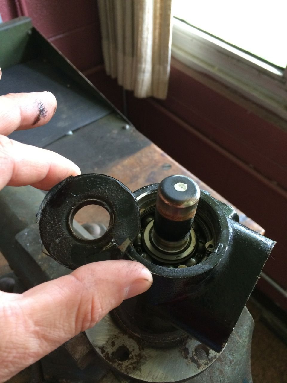

Dust cap removed
Dust cap removed

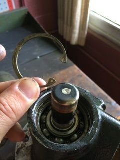

must remove retaining ring
retaining ring removed

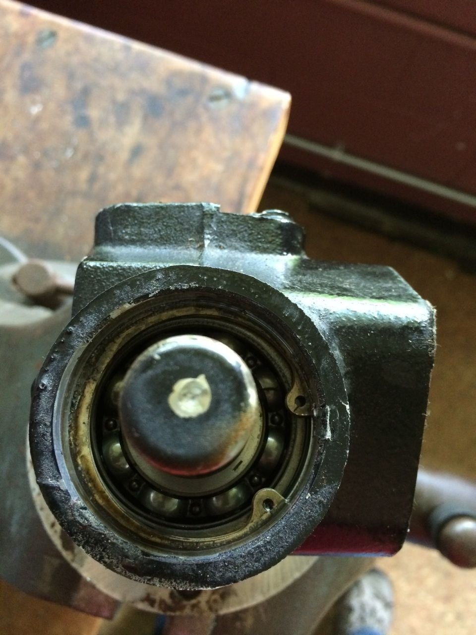

Shaft assembly removed
Shaft assembly taken apart

The bearings for the pumps with the fuel pumps on them....... i think are the same size as the non fuel pump style pumps. And i know those are the 6204 bearings cause i have a pic of them. I know those are 20mm ID for the shaft, 47mm OD and they have a 14mm Width
So i would take the pump apart and measure the old ones to be sure. Then get them in a 2RS version and just take out one of the seals on the inside where it will be filled with oil. You may need to clean out the bearing grease in there just so it doesn't cross contaminate the oil.
The actual seals i don't know what the part numbers are for those. I do have the part numbers for the old style pumps....there's 3 of them. the two small ones are a 7450 and the one large dust cap behind the pulley is a 7690
