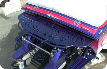

Looking for input on the width measurement of an aluminum platform like the one pictured below. I'm going to fab a swim platform for my 31' Bullet, so I could make it as wide or narrow as I want. Having never owned a boat with this type of platform, I'm having trouble envisioning what I want. I want plenty of room to sit or walk on, but not a diving board hanging off the back. How far back does your platform extend from the transom?

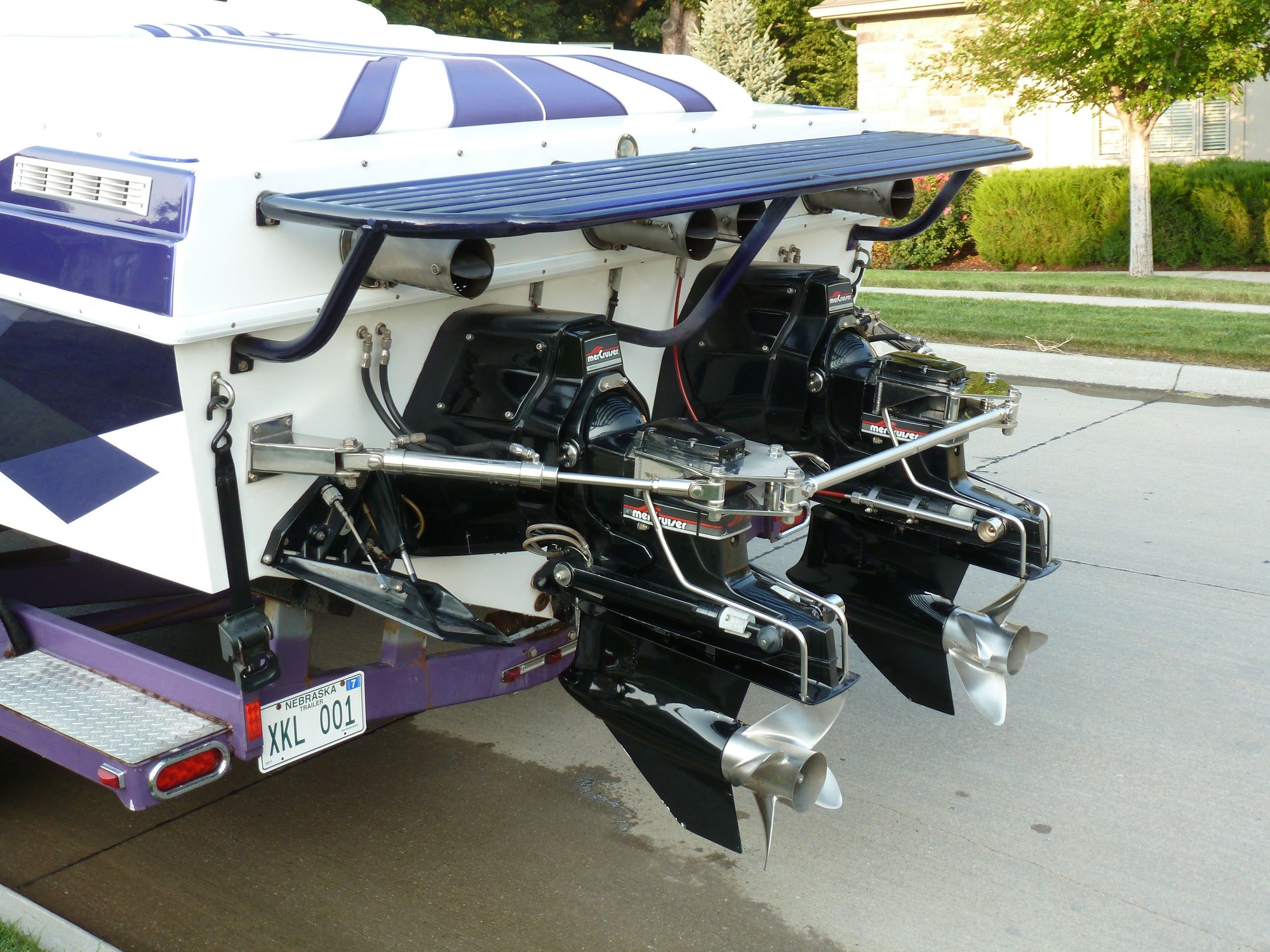

Mine is 23" total off the transom including the grab bar. 18" platform, mounted 2.5" off the transom and grab bar is another 2.5"

It looks like you have 1 7/8" oval tubes. What is the distance between the tubes, are they comfortable, easy to clean?
I'm tossing between flat oval tubes and a aluminum sheet with crescents cut into it like the example pic I posted.

1.5" Flat oval tubes and 1" in between them. Platform is powdercoated and then has 1" clear non skid tape on the flat ovals.

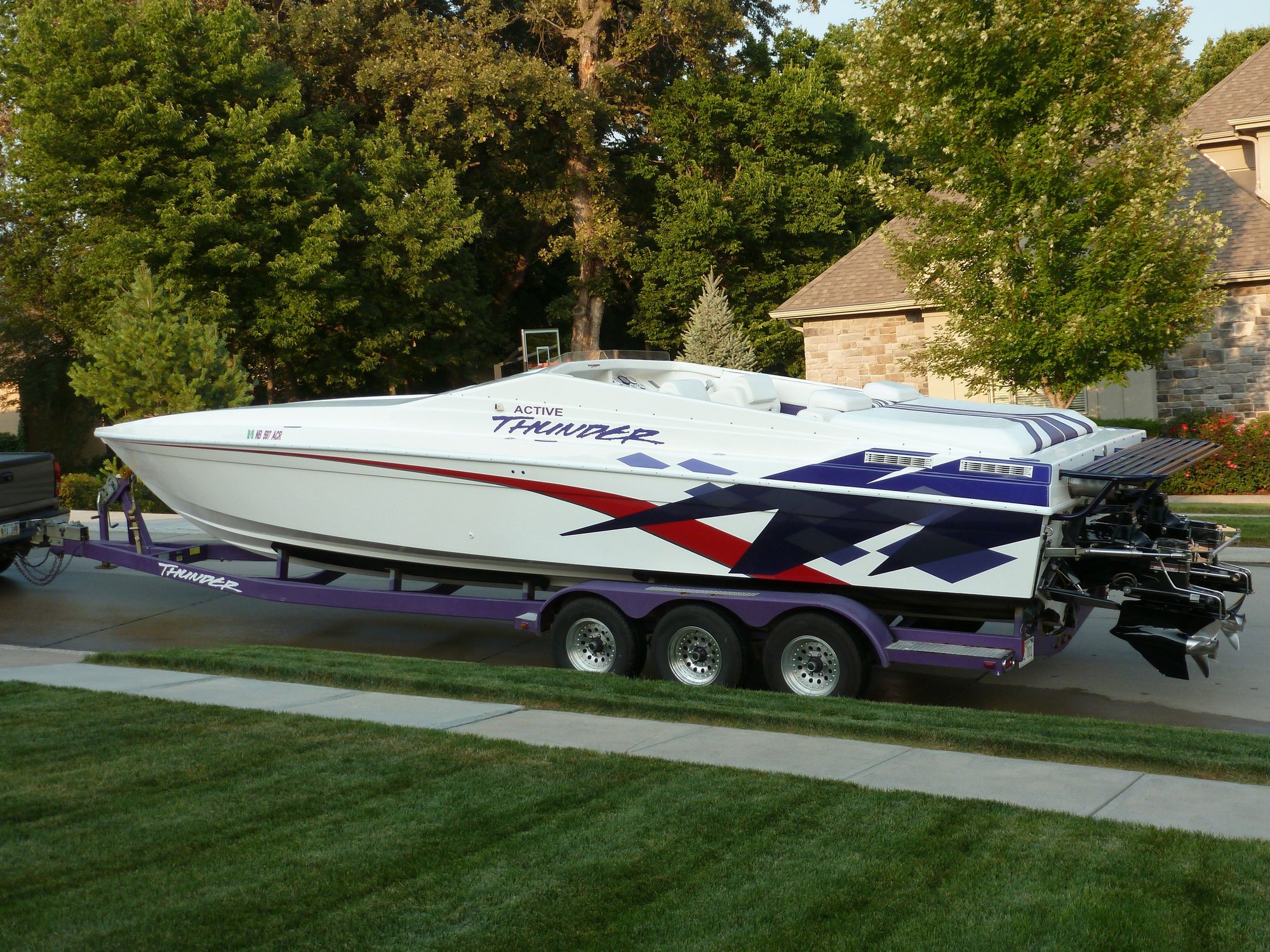

A Bullet I found in a search....
