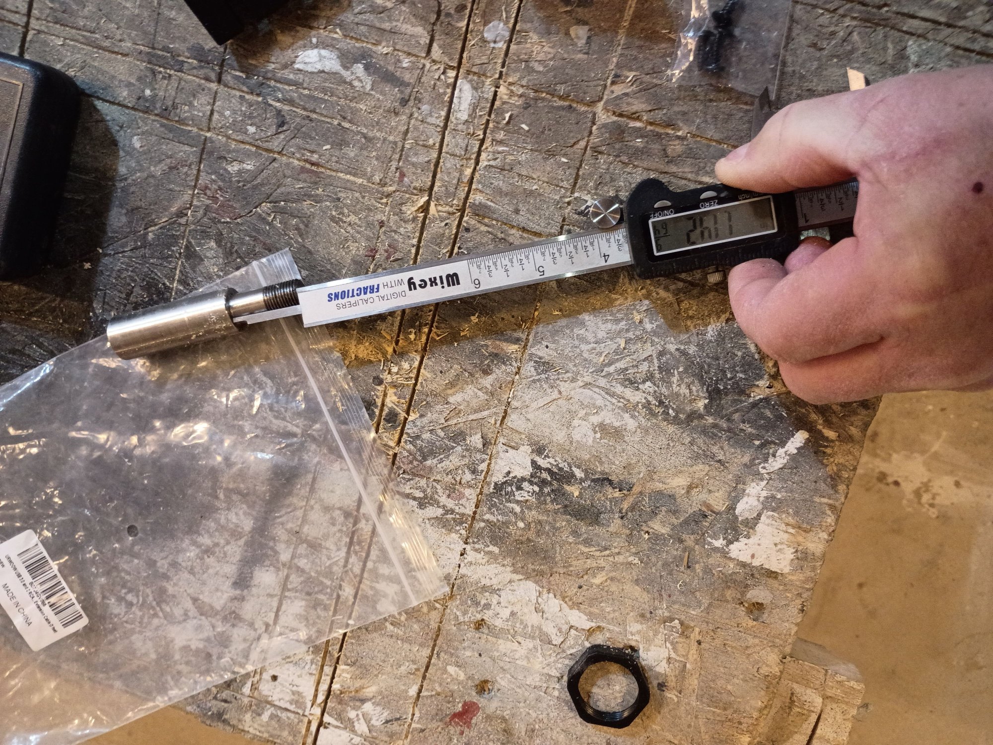

Naturally my battery is dead, but measurements are here:
CheckmateScarab is offline

Thank you, looks like they are a bit different. Could maybe make my own bushings to make it fit or else just get 2 original imcos.

Yea it looks like the pin will fit the steering cap but the thru-bolt on the ram has a different dimension. 1/2" vs .0.68". I'm sure you could shim and add some washers to cover the difference in a pinch
