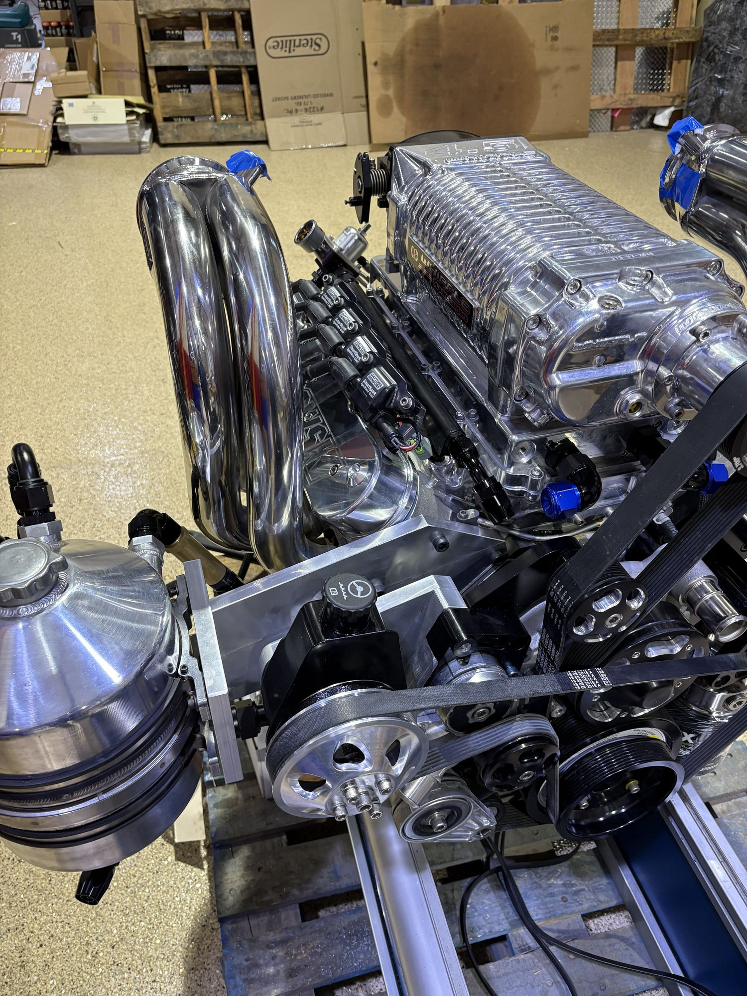

Dry exhaust frome what I know is only used for Cam overlap issues. The other thing it is loud. In my new build it has to be Dry for the Cam overlap. There is about a 10 inch drop from the header collectors at a 45 degree angle to the exit out the transon. The O2 sensors are in the header collectors, they are very sensitive to mosture as well. Outside pipe is 4.5 inch OD and inner is 4 inch ID. I am welding up the lower half to the tails at the exit end to retain some water at idle but think the pipes will be full with the pump I am using. A small hole in the bottom is added for drainage after the engine is off. The top half the pipes are open with the standard 1/8-3/16 inch gap betten the innner and outer pipe. This will caise the water to go out over the exhaust and quite it down some as well. I can not see how any water at idle could travel up a 45 degree incline with a 10 inch rise but we will see. I'll have to carry a few O2s just in case it could. An O2 failure would show any water intrusion well before getting to the valves at idle.
Your tail pipe Angles/style looks exactly what I am doing right now, except mine IS going to Be with 3.5" innner Pipe and 4" outer. Do you Have a picture of 02 sensor bungs location?

Your tail pipe Angles/style looks exactly what I am doing right now, except mine IS going to Be with 3.5" innner Pipe and 4" outer. Do you Have a picture of 02 sensor bungs location?[/QUOTE]
I don't have a photo od O2 bungs. But the headers are CMIs and the bungs are in the collectors and straight out the side, in the standard location for boats. One in each collector.

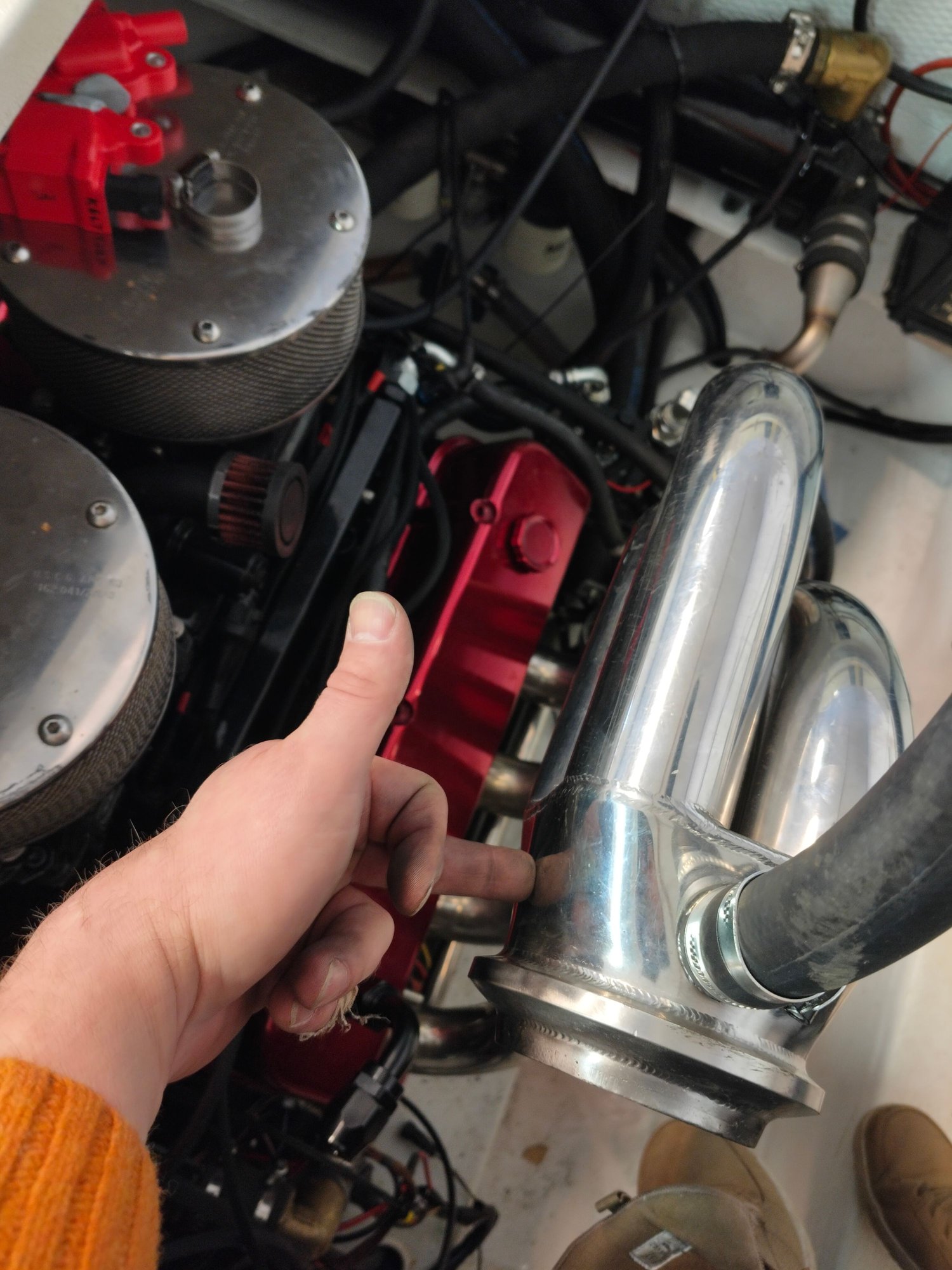

I don't have a photo od O2 bungs. But the headers are CMIs and the bungs are in the collectors and straight out the side, in the standard location for boats. One in each collector.[/QUOTE]
You Mean here.

Yes, that is the spot, same in each collector.
Not easy to put a O2 bung there after the fact. The O2 bung will be fine in the front of the tail pipe just after the clamp maybe an inch or two, should be easy to weld in there.

Found a photo of the O2 bung hole in my collectors. Look at the crossover bung on top of the collector. The blue tape under it is the O2 bung hole.
Acually on another boat the O2 bungs are in the tail pipes as they were added with the new EFI system last year.
