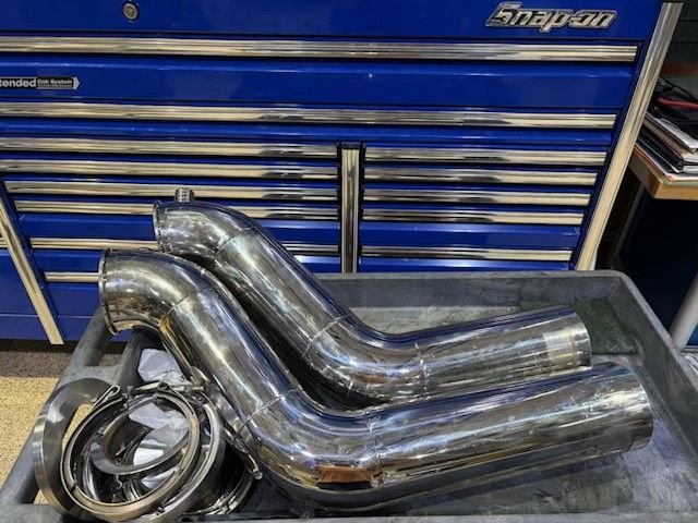

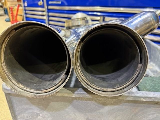

Top?
I`ve never seen exhaust dumps at the top. Never seen a boat shooting water up at the swim platform.
The bottom is where you want it .
Unless you have a 2" hole the entire pipe is filled, it doesnt drain that quick.
Mine were inside and at the bottom, my tips were just as cold as the rest of the exhaust.
The tips picture is not mine.

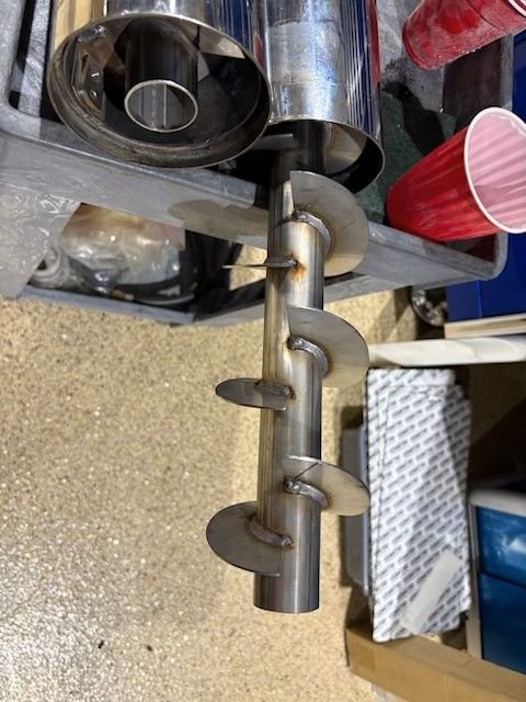

This is what I have for a dry exhaust. First time for me as well and think it will work. Any input would be helpful.
Baffles are for two reasons, for reducing sound at idle and stop reversion. They bolt in at tail end. Old school spiral baffles that do work at idle but no real reduction at anything past half throttle.
