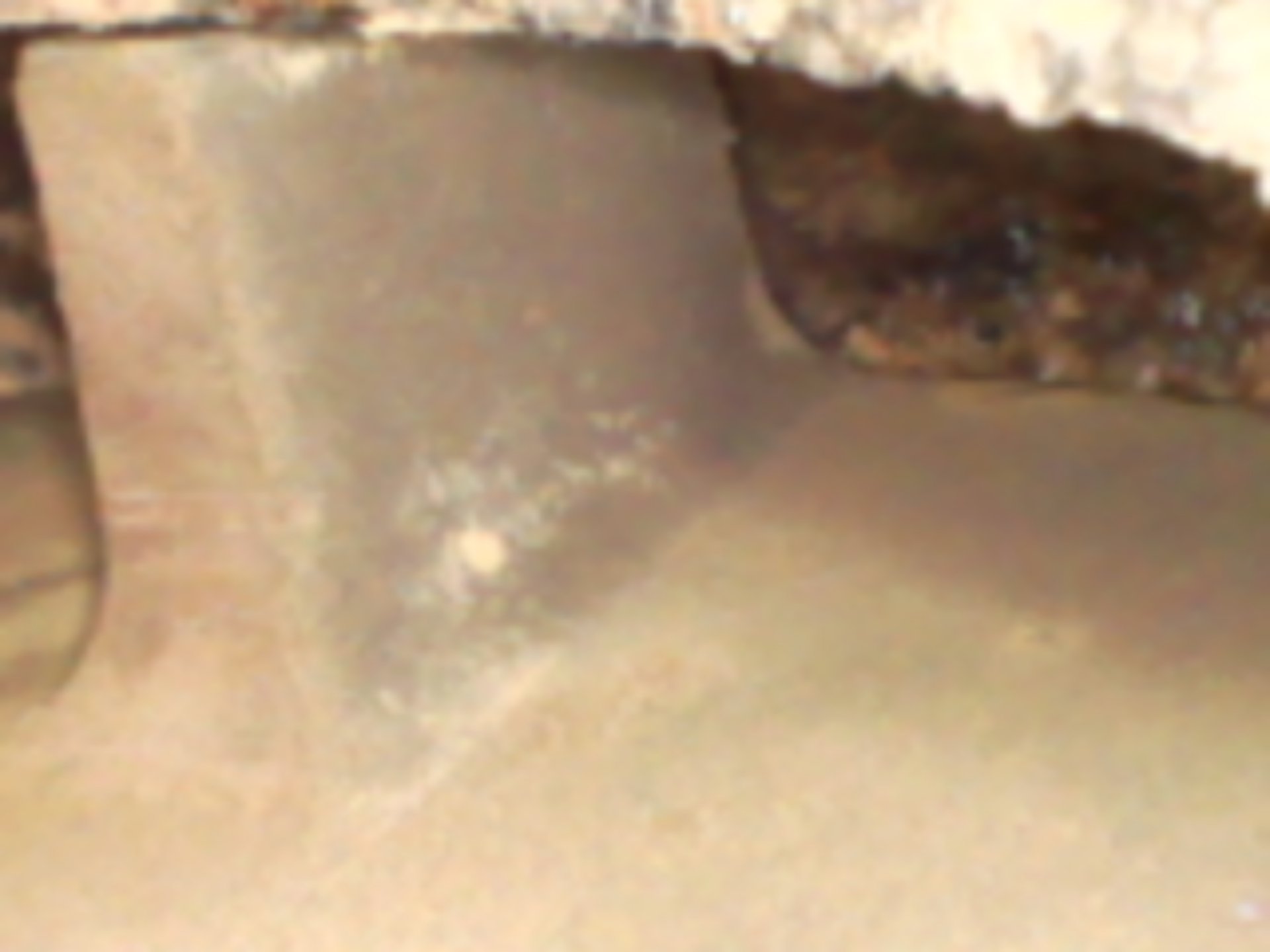

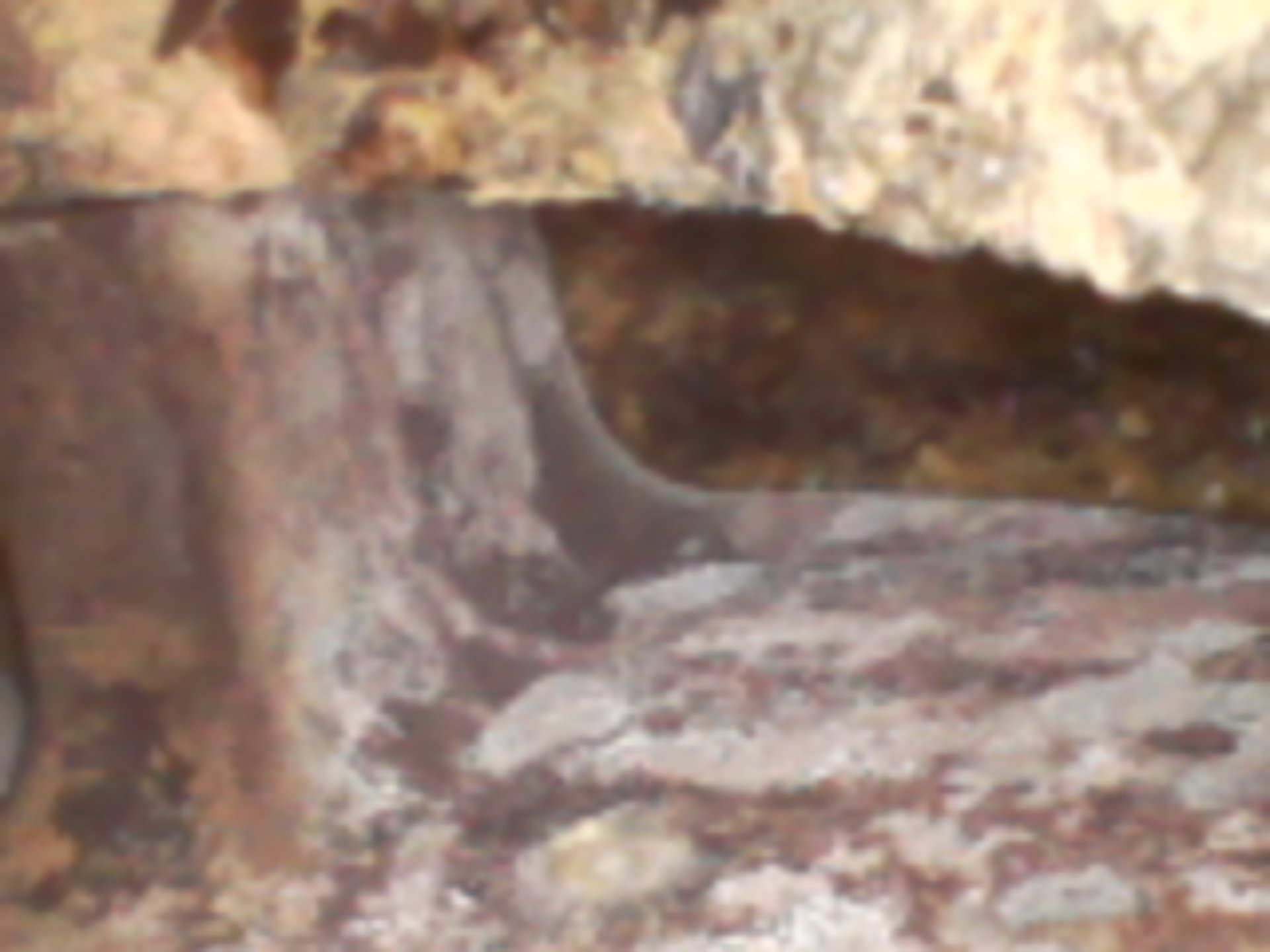

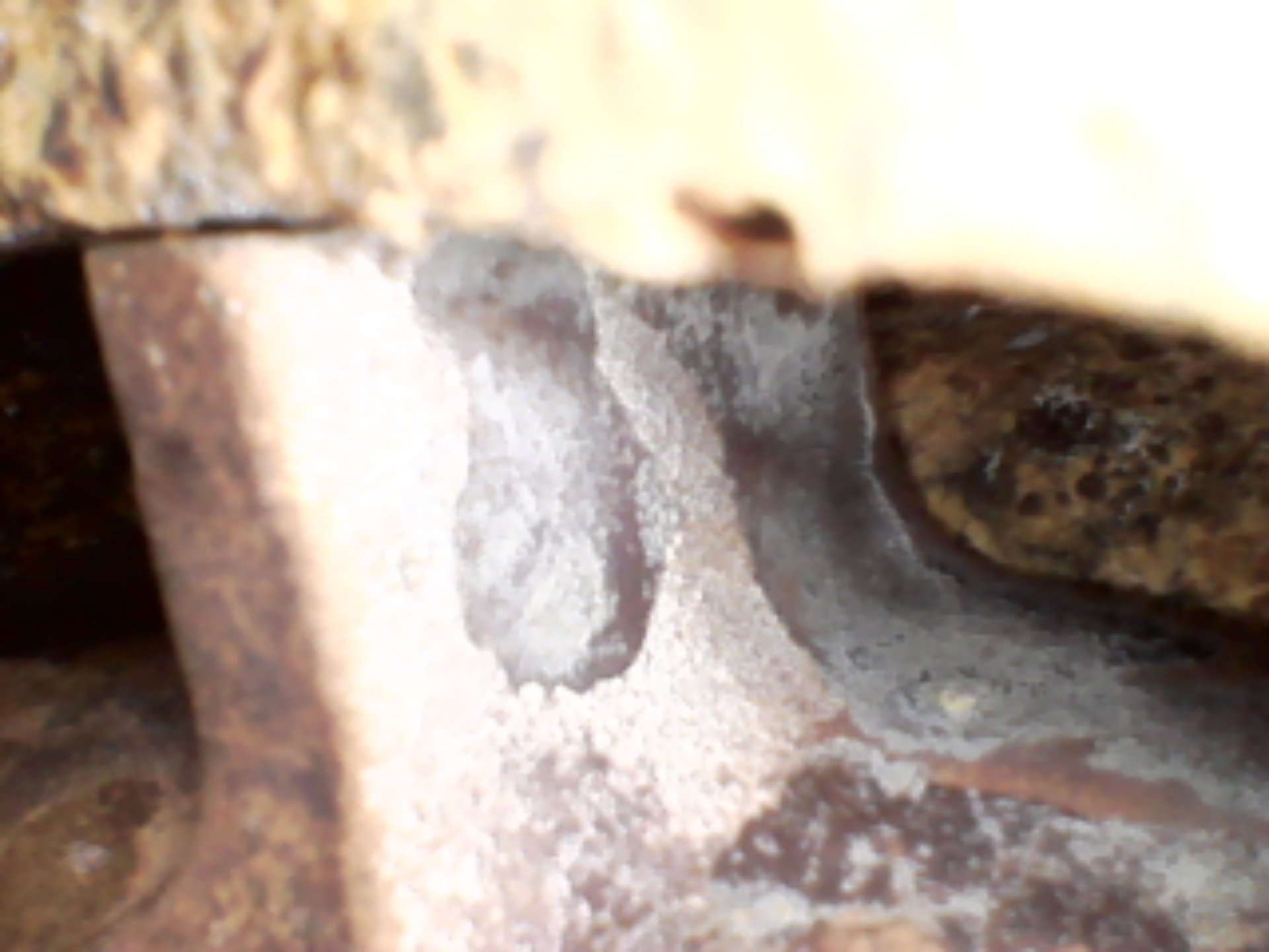

Inside of circ pump viewed with borescope. One smooth blade and a couple corroded blades.

Old 04-28-2026 | 07:06 PM
Veteran: Navy
Joined: Oct 2005
Posts: 285
Likes: 170
From: texas
thats about how mine looked
then the new one was wholly cow its got bigger vanes
Good you have a new pump
powerboatr is online now

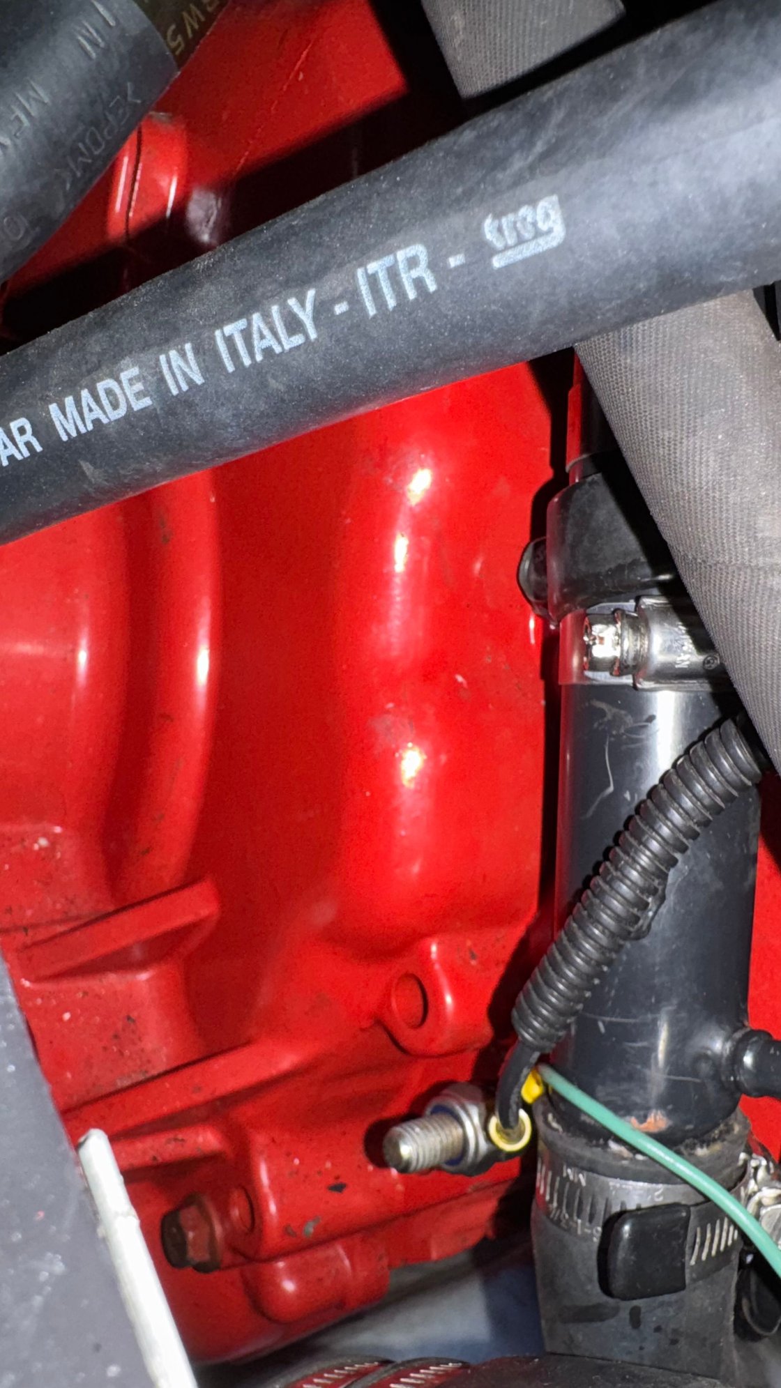

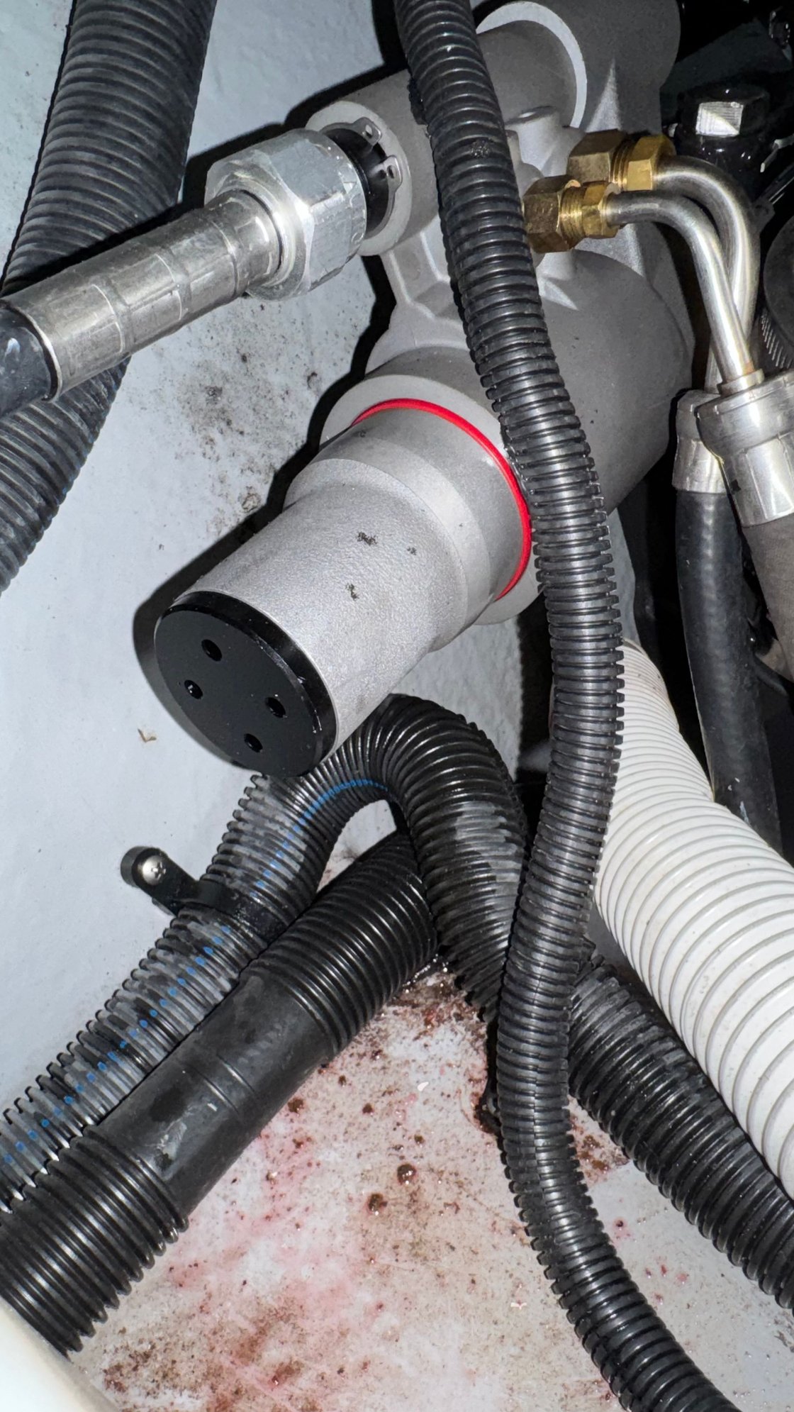

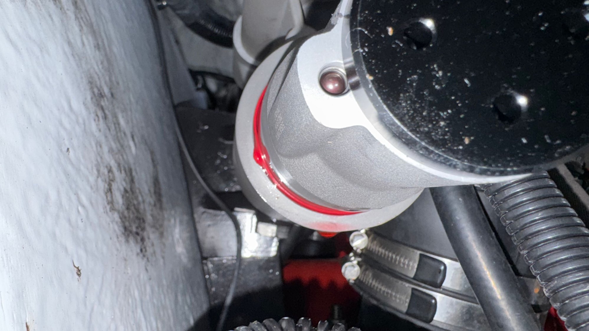

Old 05-03-2026 | 03:40 PM
Joined: Mar 2012
Posts: 57

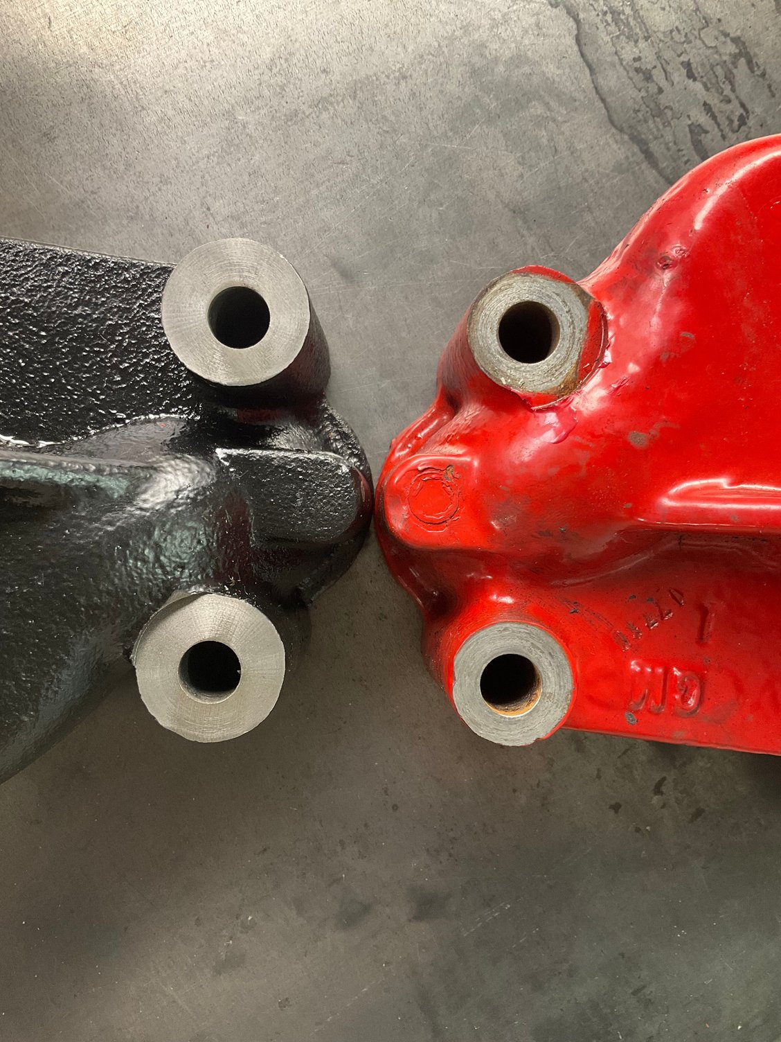

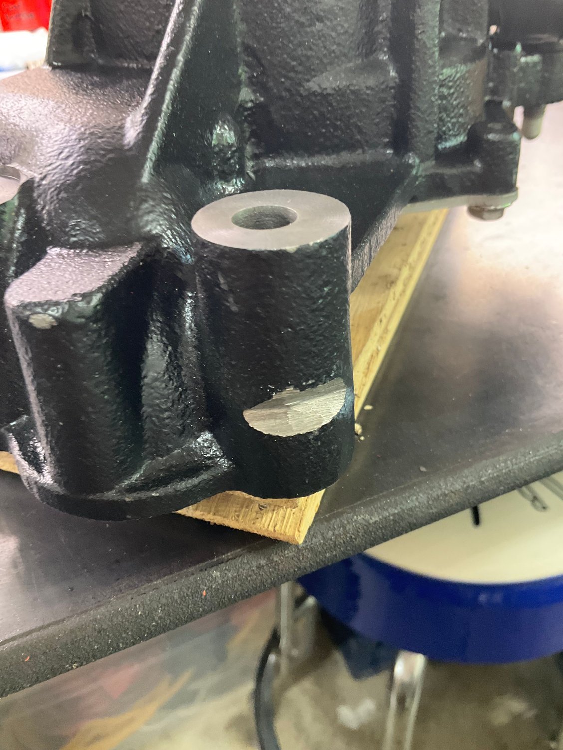

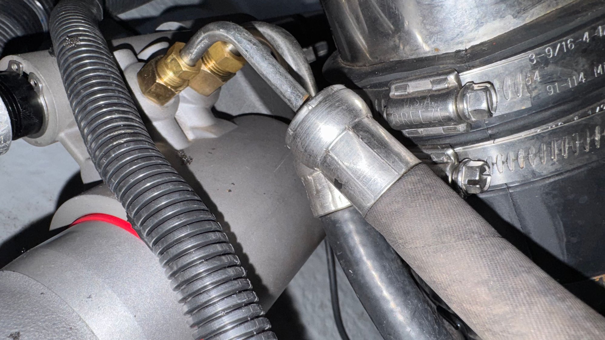

Well, engine still overheating. Power steering system puking ATF. Also an inch of water in the boat. Not sure where it’s coming from. Power steering cooler doesn’t appear to be leaking ATF or water. No residual drips or anything wet below it. ATF seems to be leaking at a joint in the actuator (newly installed Chinese model). ATF fluid below the actuator. Hydraulic line fittings are clean and dry.
Wet area below actuator
Small drip on bottom of housing
Fittings and hoses clean

PS Cooler dry

Old 05-03-2026 | 04:01 PM
Joined: Mar 2012
Posts: 57
No sign of atf or water leakage on ps cooler atf lines or water hoses.
