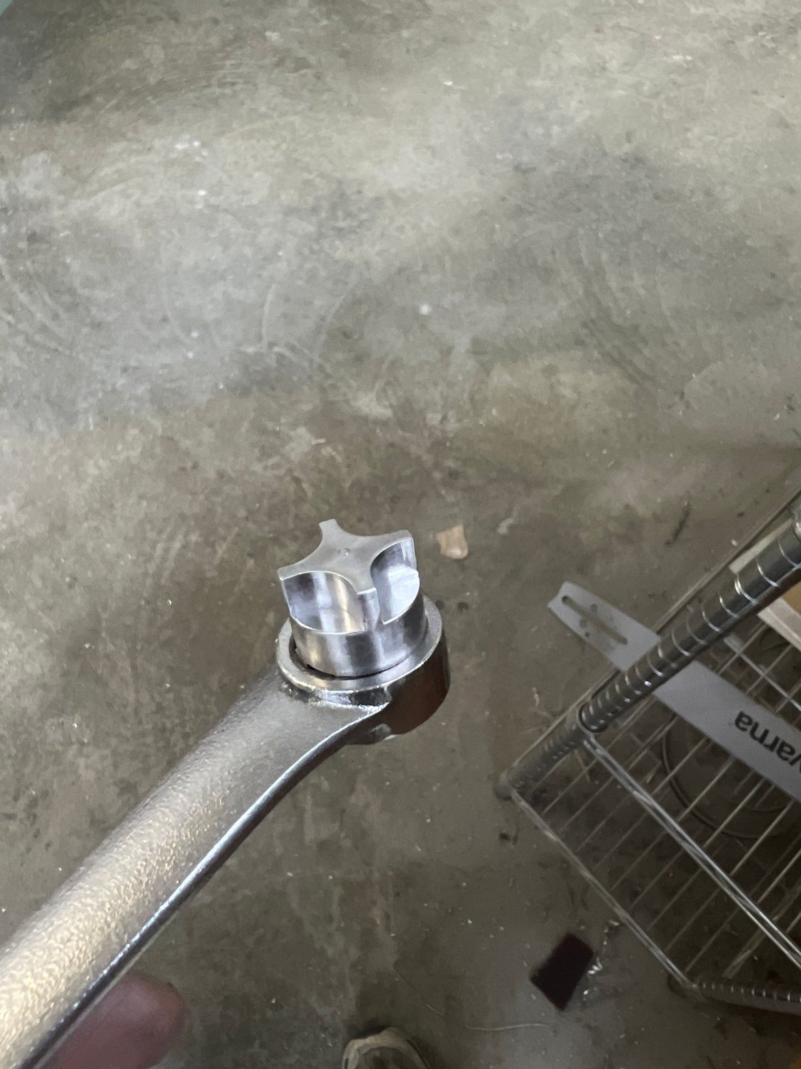

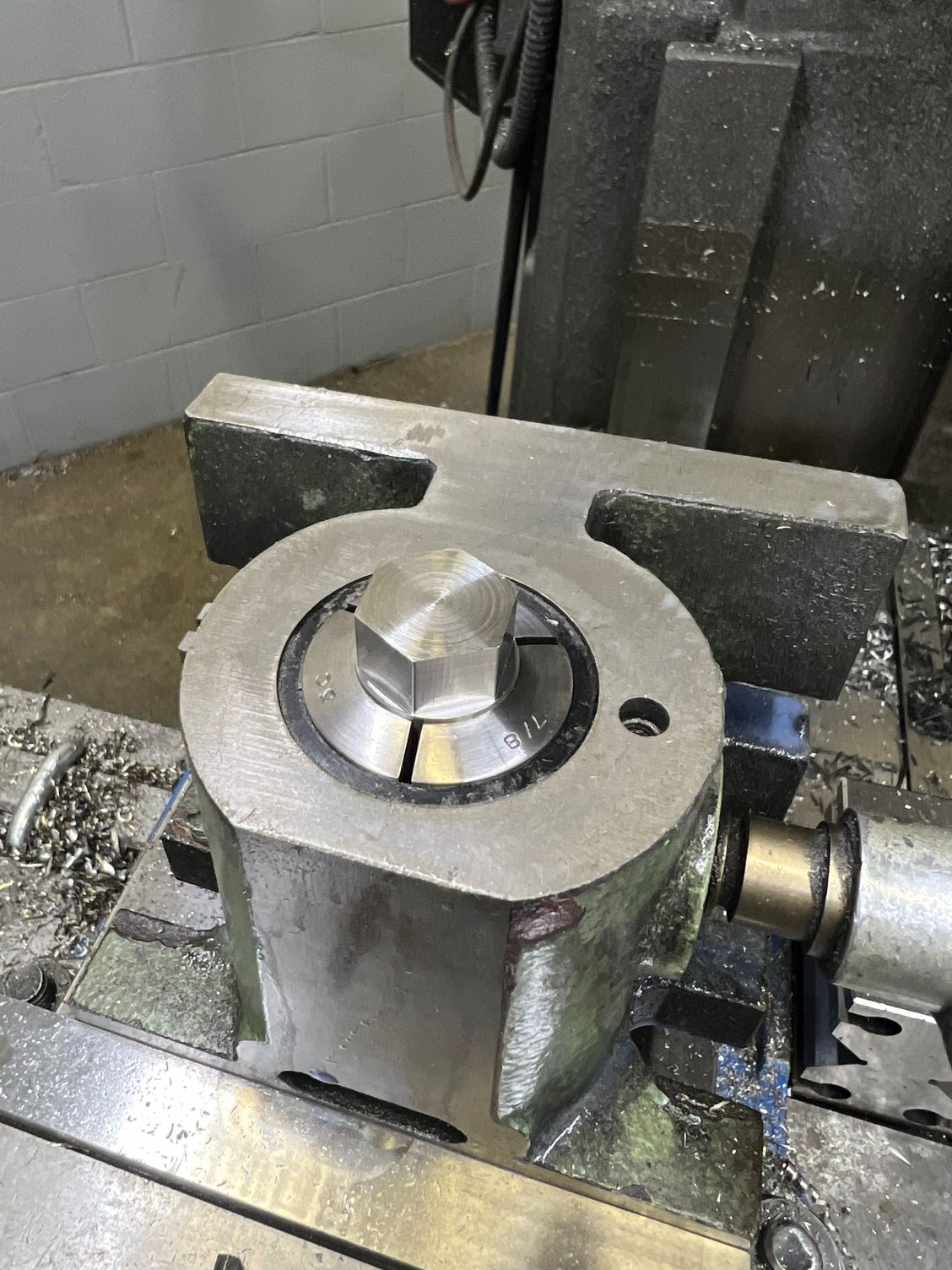

Originally Posted by boatnt
yes, need special tool
BoatNT,
I made mine, but I'm like that. Impatient and enjoy the bamboo shoots under my toenails.
Thanks. Brad.

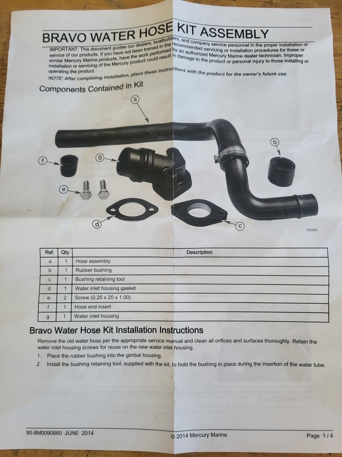

Brad, I wish you were my neighbor.... you know to make things.
Parts arrived yesterday, with the rest of the instructions.
