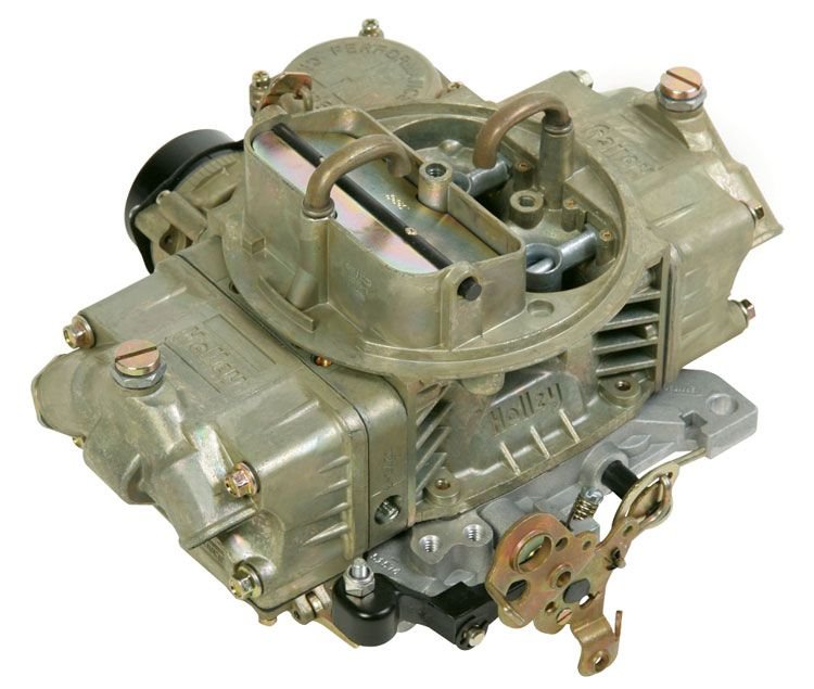

Marine carbs have the float vent tubes aimed back down into the throttle bores for the very reason you ran into. To redirect fuel back into engine in case needle and seats fail and let fuel fill the bowl and out the vents.
Here’s a pic of the marine style Holley
