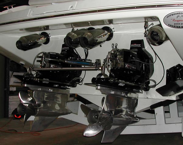

I am running Stainless Marine manifolds with dry pipes, They dump water in the tip at the end so they are still water jacketed. I have Gaffrig outlaws for switchable mufflers. I am running about 700 HP through them. No flappers, I just make sure when I come off plane I switch them on - no problems yet after one season. Cost for outlaws for 2 pair was about 3K
Ray
