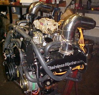

Opie...I went through the carb and cleaned it up. Didn't really notice anything real off. The float drop was off alot but I guess that probally wasn't my problem. The float level was off about 2/16" I fixed that but Edelbrock dosen't think the amount would cause a problem to my extent. I orderd some Hi-Flow needle and seats just to make sure the bowls where filling as fast as the bowls needed them. They should come in today. I guess Im back looking at a vaccum leak or a fuel delivery problem..This is the problem child.......God it's hard to love your kids sometimes!
358/350hp roller
