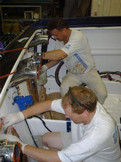

Interesting project! Looking at the 'after' picture, it looks like the "swim platform" over the drives is hinged (or otherwise articulated). I'm assuming that it moves with the drives, right? If so, can each drive be trimmed individually, or is the whole shootin' match moved as one unit?
Can't wait to see how these things perform....

The hole drive system trims as one
the aft underside of the drive works as a big trim tab at slower speeds hold the bow down and gets the boat on plane faster.
the curve underside of the housing directs water flow under the boat when backing allowing better thrust giving greater maneuverabilities
Have a look as www.pulsedrive.net for more info or call me direct at 954 788 0810
Tony Mills
P.S mongo, the gloves are to keep my hands silky smooth, the late nights alone with Tim and resign fumes haven't pushed me to the other side
