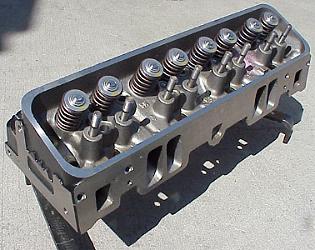

There is no 2 center bolts......The intake has 8 bolts 2 in front 2 in the rear on each side........Also NO heat crossover passage on the vortec heads...And you say that even though the carb checks out fine AND that the engine rpm's drop and the engine stumbles when I spray along the intake/head area I should change the carb?? Why would I change the carb If I know I have a leak on the intake?

The pic of the intake, doesn't it have bolt holes between the two front and the two rear ports?
looks like it, but I see the pic of the head and there are no holes???

No it dosn't...I think they are mounting bosses for some sort of accessories or something.
